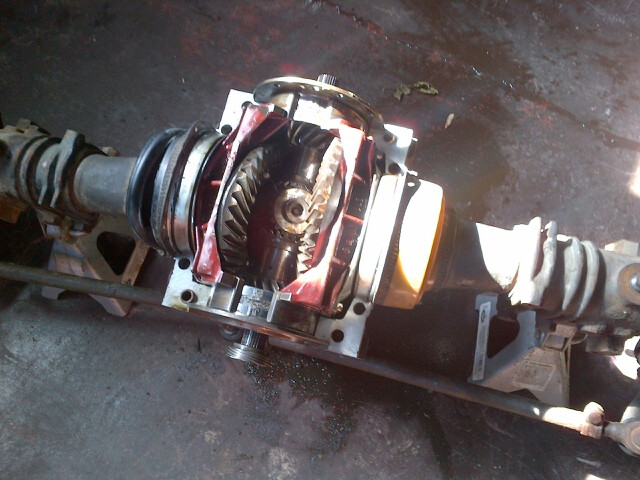

So, with the assistance of my Brother in law, we got the front end out. It was an adventure, but a relief upon completion. Dug into the diff case, and to my relief, it's all there, intact and in nice shape. The bearings are smooth, gears aren't missing any teeth and the case is not cracked. As suspected, the cheese head bolt that holds the spider gears together had fractured in it's shaft and worked it's way out until finally the big "bang" as it contacted with the spinning gears.
You can still see the threaded end in place, so looks like I'll need to drive the gears out with a pin punch and get the bolt end removed. Hopefully then just a matter of putting it all back together with a new bolt and away we go.
Any observations or advice is welcome of course!

- pinz gear 2.jpg (91.13 KiB) Viewed 6426 times
- pinz gear 3.jpg (117 KiB) Viewed 6426 times
- pinz gear1.jpg (103.37 KiB) Viewed 6426 times
- pinz gear 4.jpg (117.63 KiB) Viewed 6426 times

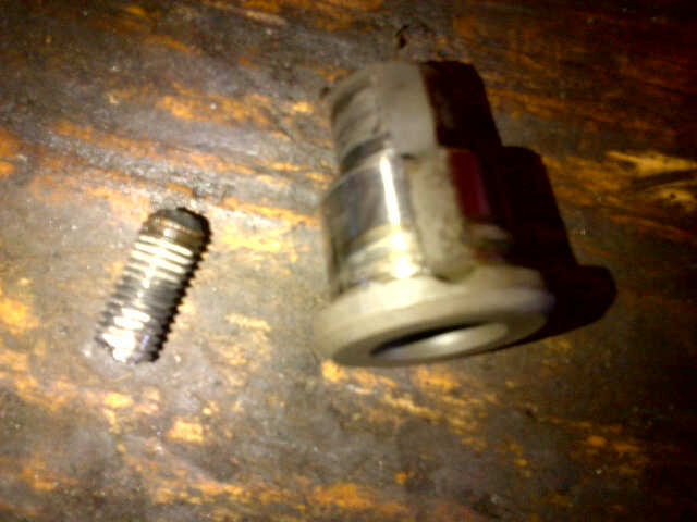

Soooooo......got all my required parts from E.I. and S.A.V. today. Split boot, shocks, a couple of ignition keys, some brake/tail lights and..........
the real culprit of all my woes......the 10mx70 exection 1 bolt. Well, I ordered 2 just because.....
Anyways, thanks to the suppliers for the quick shipping and special thanks to Scott at E.I. for throwing in a couple of items I needed for no charge. That's impressive these days!
- Pinz 10m70 bolt.jpg (85.64 KiB) Viewed 6302 times

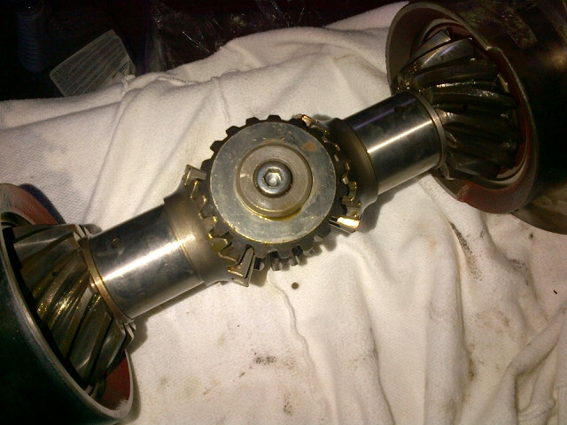

Just got this pic from the Bro in law at the garage. Old broken bolt threads are removed with delicate care. Looks like diff reassembly will take place tonight. Things are moving along rather smoothly...........so far
- Pinz 10m70 bolt removed.jpg (33.02 KiB) Viewed 6290 times

New 10m70 bolt installed...with a healthy dose of permanent thread lock..
- pinz 10m70 installed.jpg (96.5 KiB) Viewed 6259 times

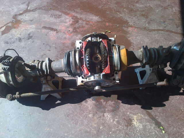

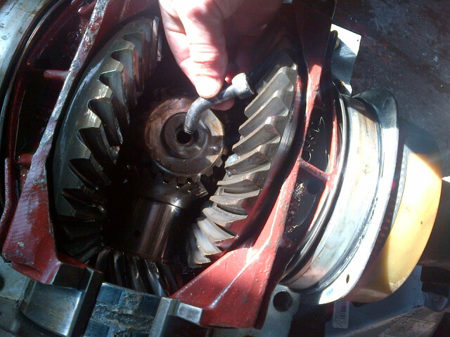

Got the gears back into the case (bottom half anyway). Will be double checking everything tonight then hopefully bolting all back together ahead of the impending reassembly process. Getting excited to have front wheels again.....
- pinz spider gear reassembled2.jpg (115.97 KiB) Viewed 6213 times
- pinz spider gear reassembled1.jpg (113.66 KiB) Viewed 6213 times
Re: Big bang, now metal "rattling" sound...yikes!
Good pic of the o-ring.
I'm going to have to remove the aluminum ring the boots slips over to replace a few things, but mine is really on there tight. With the case open I am sure it is easy, but was yours stuck on, or did you need to remove it?
