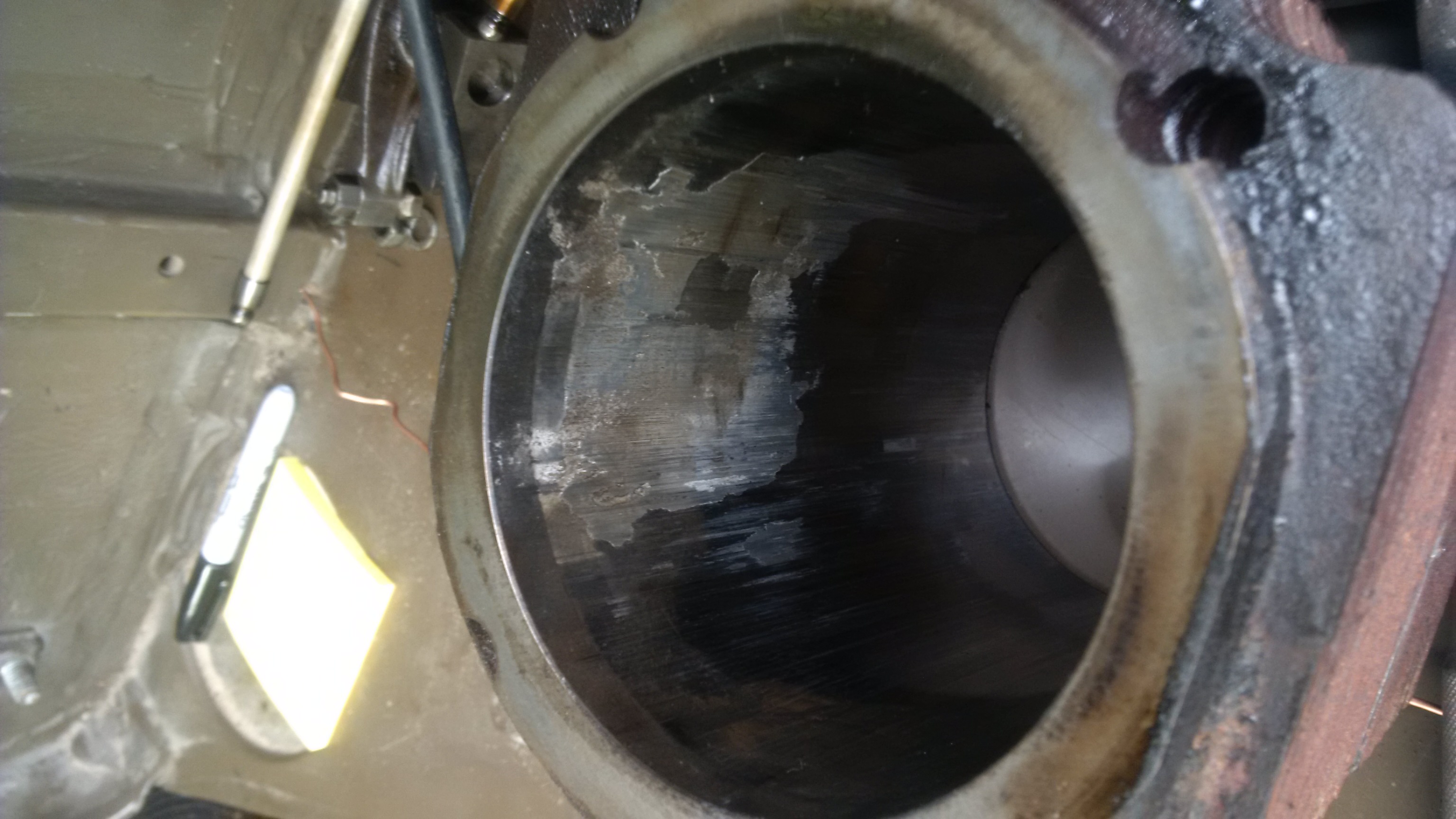

Pinz piston bad.jpg (966.25 KiB) Viewed 5782 times
pinz cylinder bad.jpg (741.58 KiB) Viewed 5782 times

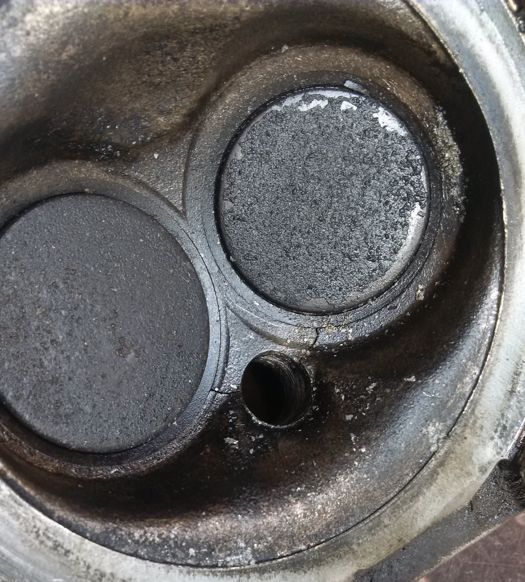

Here is the crack at the plug hole in head #2
pinz bad head crack.jpg (920.52 KiB) Viewed 5780 times

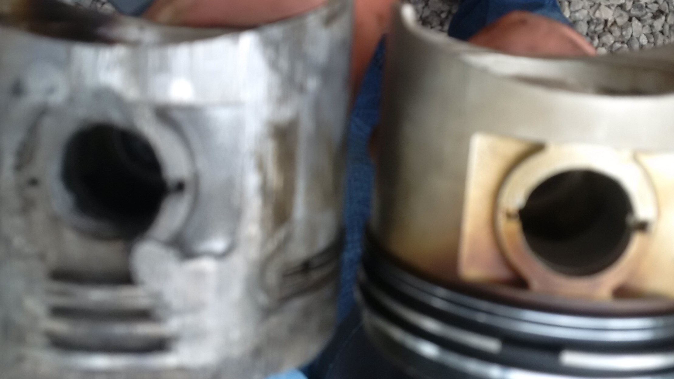

bad pic I know, but you can see the extent of the damage to the piston compared to the new one. My brother in law said it was the worst one he'd seen, and he has owned a shop for decades....I told him I was happy to provide new experience.... :lol:
Pinz piston meltdown.jpg (260.57 KiB) Viewed 5779 times

Could a crack like that be caused by using plugs that have too large a base or slightly wrong threads?

krick3tt wrote:Could a crack like that be caused by using plugs that have too large a base or slightly wrong threads?
While I'm no expert on this, I'm guessing high speeds/long distances could have generated enough heat to crack the head. I threaded the existing plug into the new head with no issues so I'm thinking that the plug thread/size was not the issue.
Another thought was poor heat dissipation at an earlier time in it's life, possibly due to foreign objects such as we've seen in Scott's "let's keep them running" thread blocking the heat sinks. Always been clean since I've owned it, but who knows about the 35 or 40 years prior. I noticed minute hairline fissures in the #1 head also, not quite extending into the threads, so I will be keeping a close eye on my plugs to ensure they are snug at least once a week. Don't think I'll jump the gun and start replacing all the heads, but it's good to be aware..... :roll:

I'm thinking whatever part broke loose and hammered the cylinder wall could have also cracked the head through impacting. It's possible.

That's what I thought at first until I discovered the same, yet much less significant markings on the first head as well. The one thing that lead us to this conclusion as well was that the plug was immediately loose after the piston detonated. The damage to the cylinder and the piston line up perfectly with the plug hole. It would suggest that the cracks were pre existing and facilitated the loosening of the plug. Enter oxygen and Kaboom! That's the theory, anyway...... :idea:
