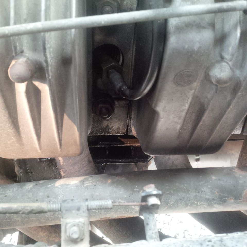

Played around a bit last night. Oil return hose to filler is not blocked. Found a throttle spring came off my front carb...not related, but good to fix!
As pictured, the second valve cover from the front is showing signs of leakage as well as an oil soaked spark plug wire. The others are all dry. This will be my next step, to pop off the cover and have a peek.....
tx Dave
tx Dave
- oil soaked spark plug.jpg (125.96 KiB) Viewed 9430 times

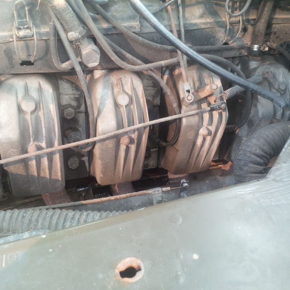

- Posts: 776
Re: Big smoke, big oil mess, big problem! Advice/confirmati
everything else looking fairly dry.......
- everything else looks dry....
- leaky valve cover2.jpg (128.38 KiB) Viewed 9430 times
