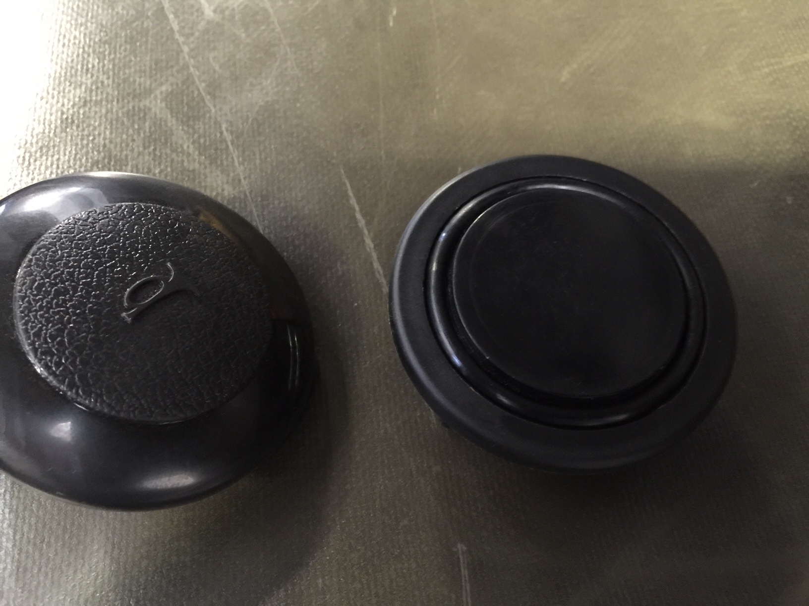

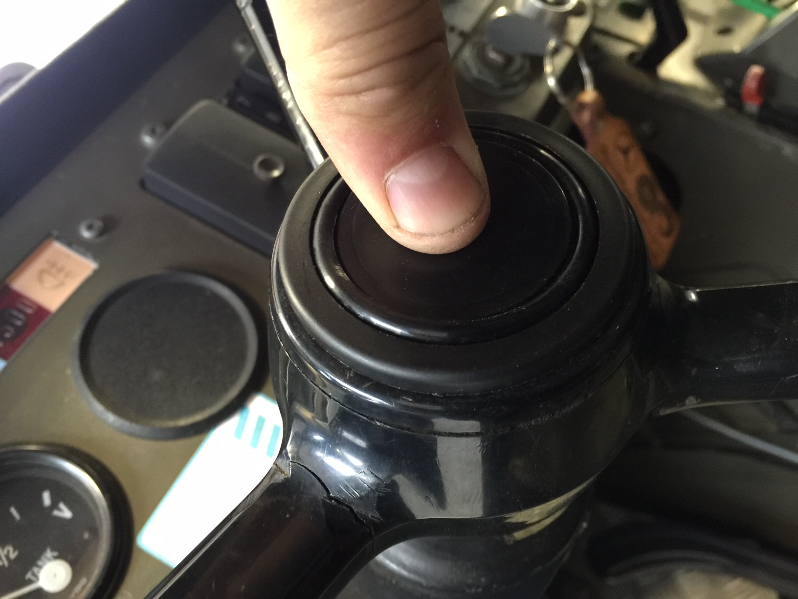

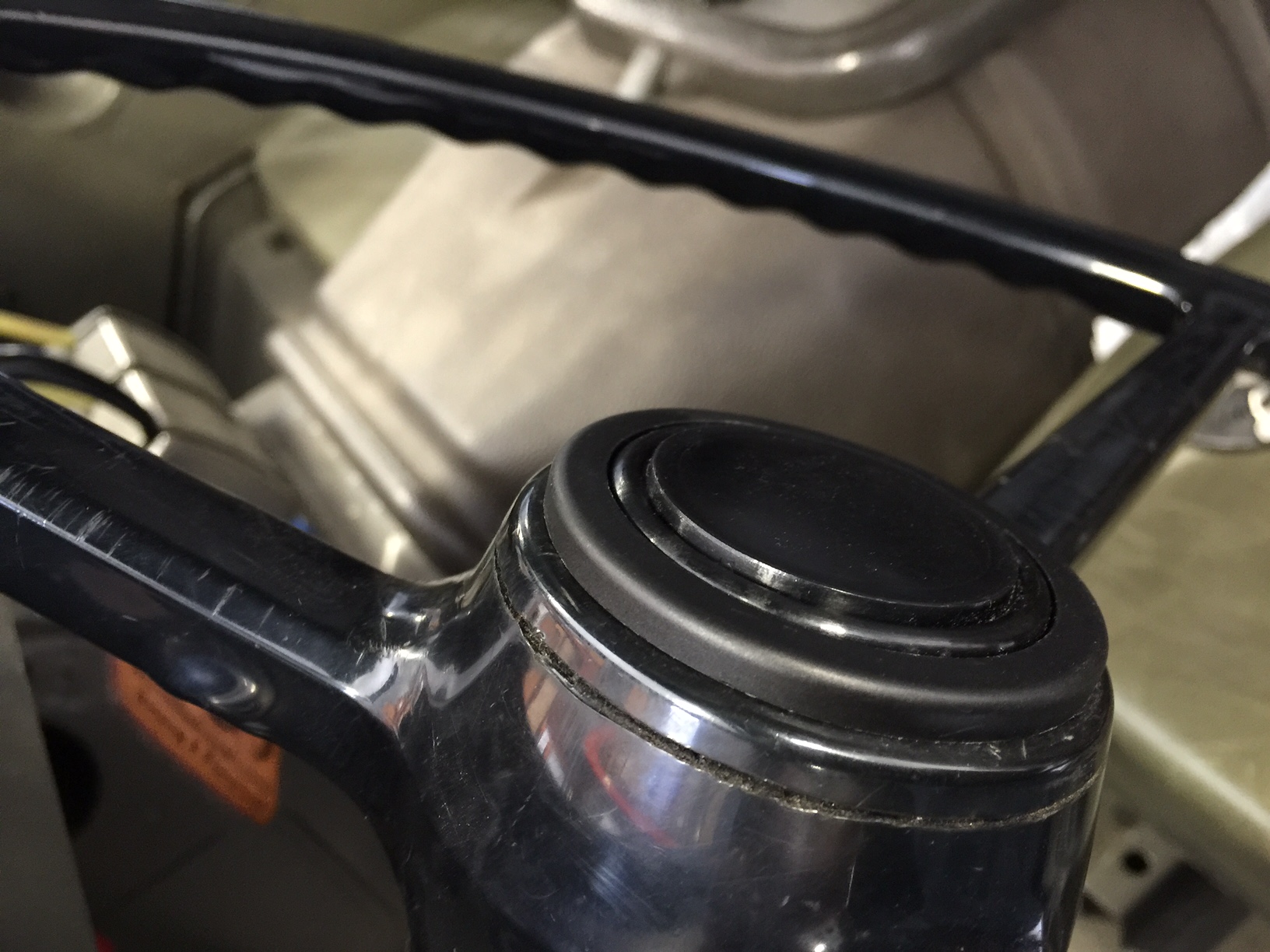

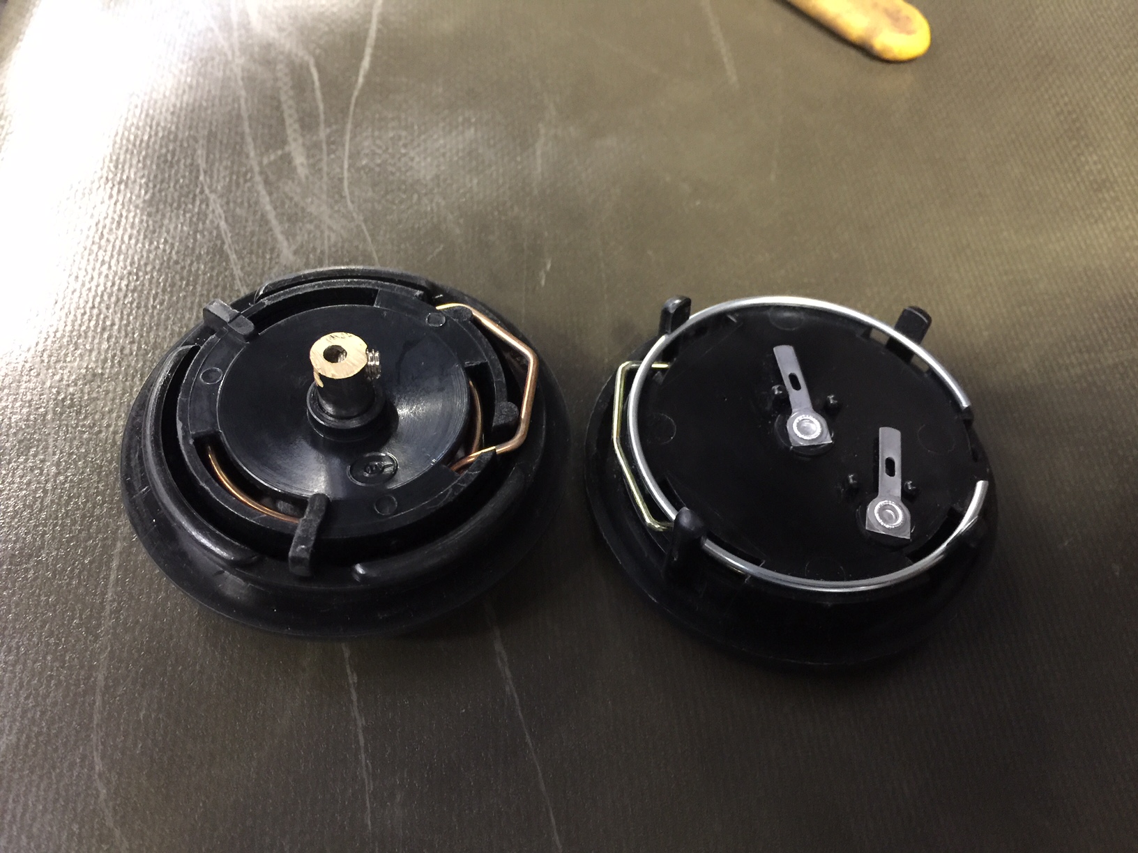

For those with the horn button blues with the EZ Powersteering. This is a direct fit, and solves the problem. It might also be of interest to those without the power steering as well.
Grant Part #5899 - Between $8-12 EVERYWHERE........ Also easily customizable as this is the button that is being used by vendors to put their custom logo in the center.
Scott
Vallejo, California
www.expedition-imports.com

Awesome button find!

thanks Scott
just ordered a button on ebay; saves me from drilling /grinding ...
