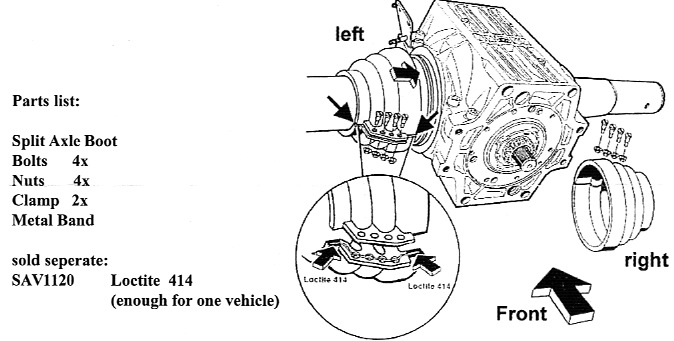

New split boot from Scott at E.I. installed. Man, that was easy. I'm sure it's partly because the front end is out, but the quality boots sure do go on without a hitch.

by undysworld
HEY! You've got that boot oriented wrong. Check the instructions that came with the boot.
The seam belongs to the right, as you stand looking at the differential, on both sides. If you look closely at the diff., you'll notice that the axles do not line up. One is ahead/behind the other. The seam should be at the point of least flex: ie. right as you face it.
Re: Big bang, now metal "rattling" sound...yikes!
Posted: Tue Jun 25, 2013 7:31 am
by stiffler4444
undysworld wrote:HEY! You've got that boot oriented wrong. Check the instructions that came with the boot.
Thanks for the heads up. Somehow my boot arrived without instructions, so it was a bit of guesswork. So the boot needs to rotate right as was the orientation of the old one (90 degrees)...makes sense..... will adjust tonight!

Good catch Paul!
pcollete wrote: Instructions from SAV (with some minor editing from me):
- Remove old boot and clean area.
- Do not grease boot or axle parts.
- Put the split boot on the axle.
- Coat the split area with Loctite #414 and press together. Hold until dry (approx 30-60 seconds depending on how much you put on).
- Slide the split boot towards the differential housing as far as it goes.
- Rotate the boot until the split points to the front on the right side (passenger) and to the rear on the left side (driver).
- Install the new clamps. The tightening bolts should be on the opposite side from the split.
SAV Split Boot Inst.jpeg (68.35 KiB) Viewed 6081 times

Boot orientation is best at 10:00 or 2:00 o clock position.
