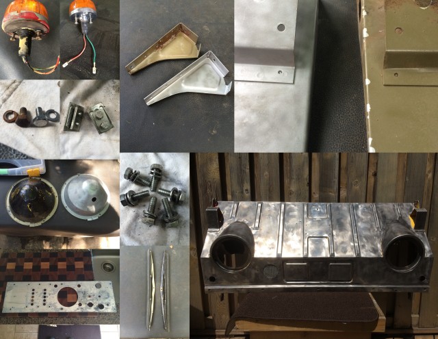

Made it to about 98% on the body work - just need to do a final blast of small nooks on the body and the engine bay sides - then on to primer and paint!
Plating completed on all but a handful of fasteners
Front clip looks like a Hafi/Delorean

Was finishing up some sand blasting of big parts last Sat (hunched over for about 6 hours) - stood up and POP went my back!
So... I am now nursing a very sore back and have been able to do nothing all week.
To top off the bad day - I had the front clip standing up on its side and walked away for 20 seconds - boom - it dropped onto the concrete right on the DS headlight!!
Looked ok until I started checking the upper and lower areas. Upper bent in and lower bent out - S.O.B!
Was able to bang it out easily as nothing creased but just a pain, more work and a bit discouraging
One day this thing may be ready for paint - trying to stay positive!

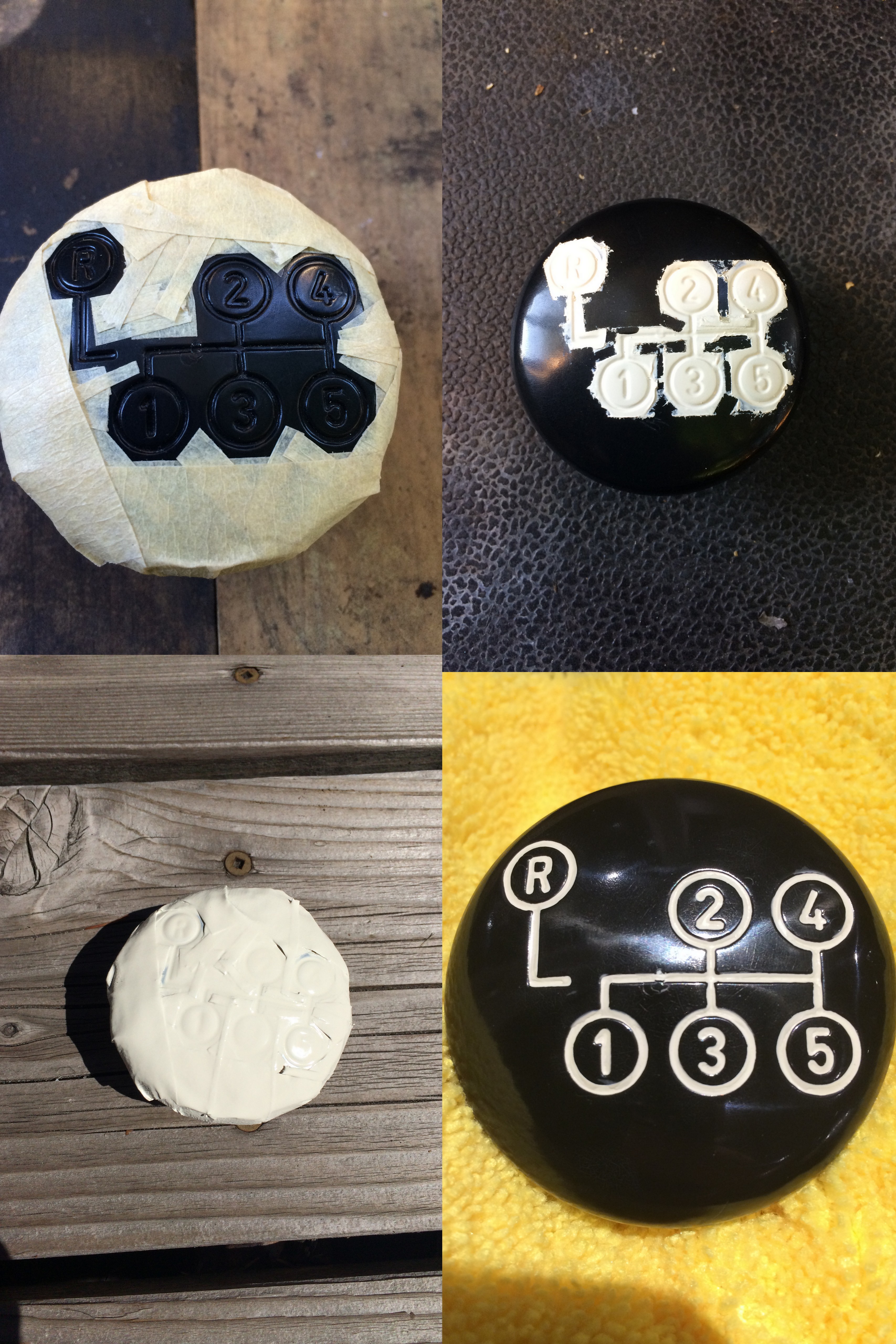

What type of paint?
Sanded knob with 600 and then 1000 wet to remove all the scratches
Then sprayed with Dover White (slight off white)
Waited for 3 days and then buffed on a wheel using Fine white plastic compound
I was amazed at the gloss

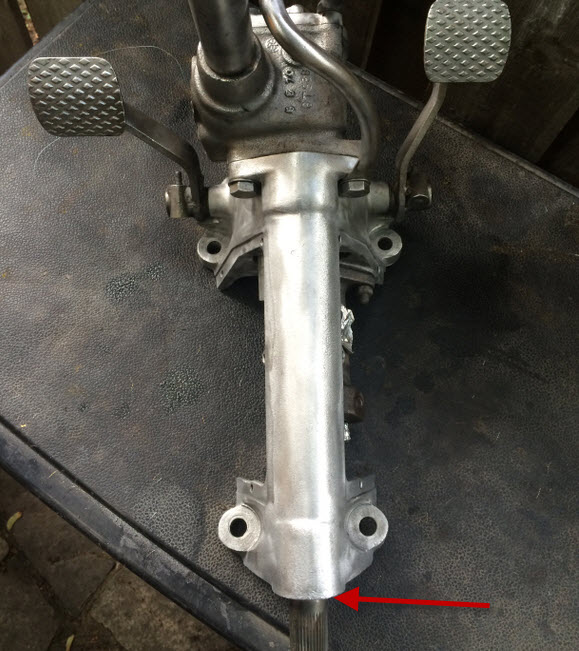

How do I remove and replace the oil seal on the steering box?
If you don't want to undo the two large nuts at the other end of the casting, then you could try drilling a couple of holes in the edge of the oil seal, then putting some self tapping screws in the holes That then gives you something to get hold of to lever the oil seal out.
Putting new one back in can be done with a suitable piece of tubing or a suitable socket - but I don't think you will find a socket with a large enough hole down the center unless you use 1 inch drive sockets! Gentle taps with a hammer all round the edge keeping it square will work. There are obviously other ways - most of which involve more equipment!
John
John

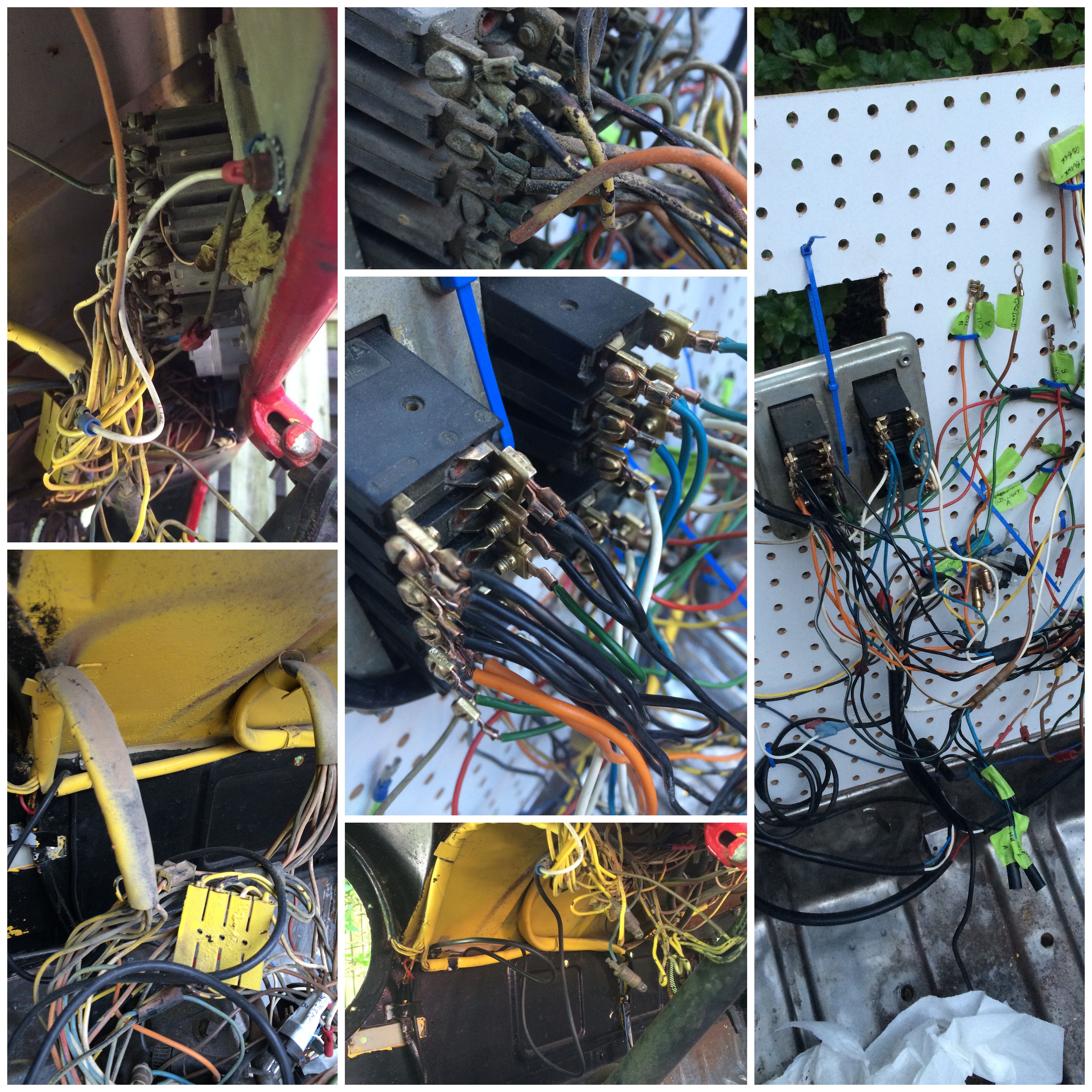

Couple of owners before me went wild with the yellow spray gun
Wiring fixed: check
Wiring fixed: check
To make it easier to be able to remove the whole front section, how about putting a multiway plug and socket on the main dash to body work section of cable?
Then rewiring the back of the dash could be done with the dash not attached to the vehicle and therefore much easier to make the "bird nest" look like a well thought out and routed wiring loom.
Just a thought....
Looks like you had fun trying to work out which yellow wire went where!
John
Just a thought....
John
