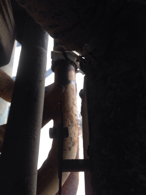

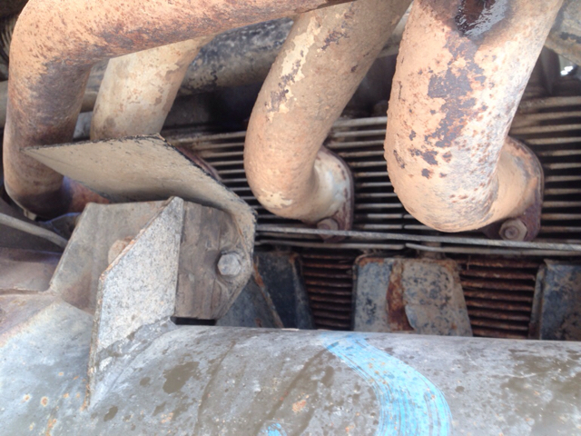

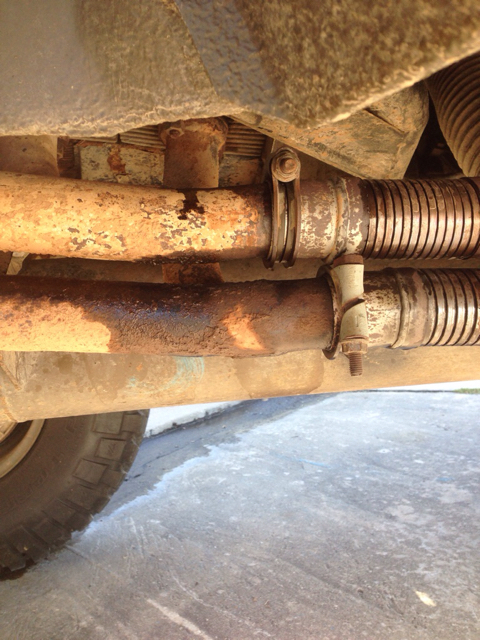

Hello everyone. Today I'm having a very perplexing issue. All of the sudden I'm getting oil in my exhaust. A lot of it. Funny thing is the Pinz has been running great! I had driven it home with zero issues and parked it in my driveway overnight. Today I went to take it for an errand and it didn't want to start at first and when it did is was really rough. I was able to smooth her out with about half choke. That's when I noticed all the blue smoke and oil leaking from the joint between the header flange and flex pipe. I'm at a loss. She was running perfect 10 hours before and now this?
Is it possible that leaving it overnight on my driveway incline could have lead to this somehow?

My guess is oil leaked past the heads/rings somehow. If you were parked at a steep angle, depending on direction, this might be a possibility. Park it level tonight and see if this reoccurs. If it doesn't, then gravity was the culprit. The cylinders angle 15 degrees up from the block, and oil doesn't run uphill.
The plugs look OK, in my opinion.

You may also have a plugged oil return on one of the cylinders (check #4 first). This might fill the head up with oil, and it drains past the valve guides once the engine stops. If oil gets past the exhaust valve, the scenario in the photos would make a lot of sense. It has to go somewhere!
