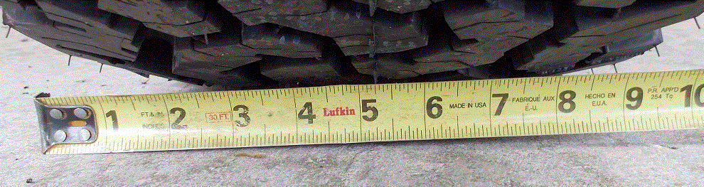

You won't be sorry. I have the same tire but in 295 on the stock rims. They perform fabulously. Steering is not an issue as long as you don't try to move the wheel when stationary. Not a problem for us old guys who learned to drive on standard steering tractors but seems to be for the power steering crowd. Could be why they break tie rod ends too!? When you get the tires mounted I would be very interested to find out what you get as an actual footprint. As you can see from the attached photo my 295s are nowhere near 12 inches wide. With the suspension on the 710 set as it is I rarely even get the inside of the tread dirty. I will likely have the tires remounted at some point so I can wear out the inside too. I don't run heavily loaded so that likely contributes.

Hey that's great news! I'll post pics after I mount them and will try to remember to measure the footprint as well.

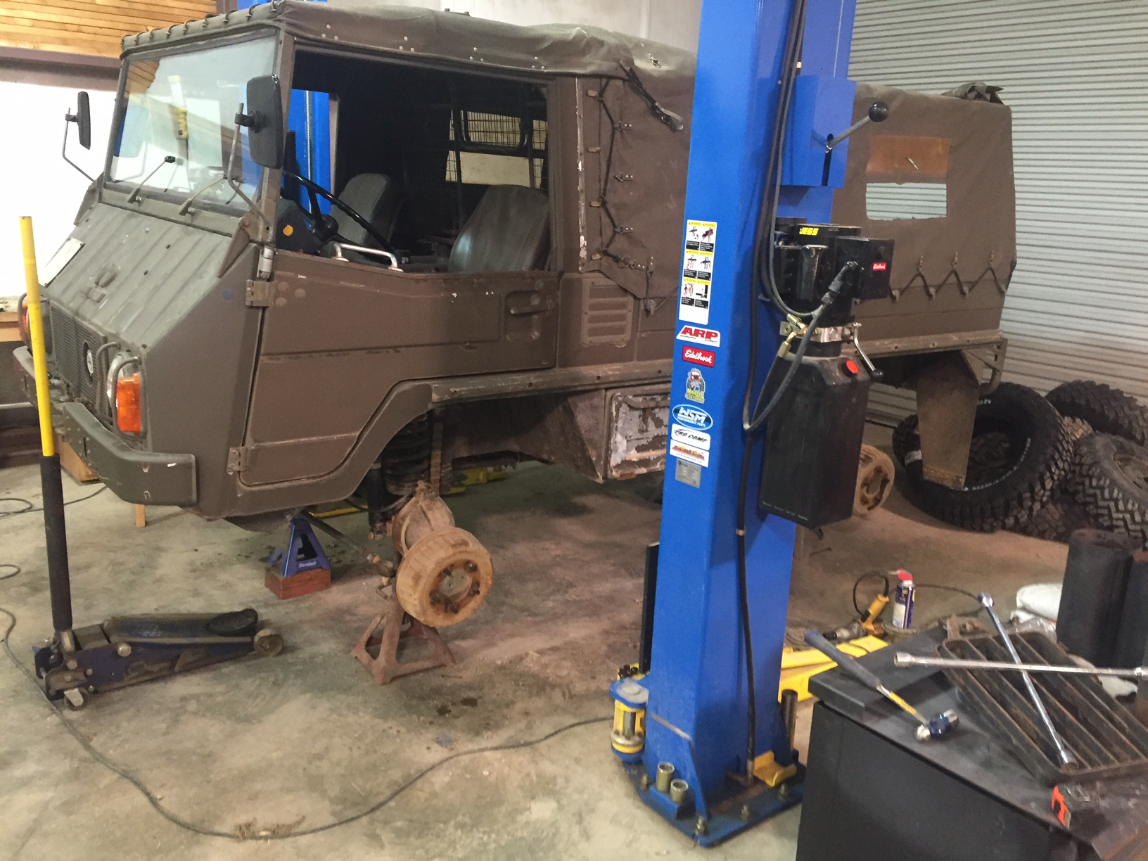

Santa came early!

Too much rain to get out and get the new tires mounted...
