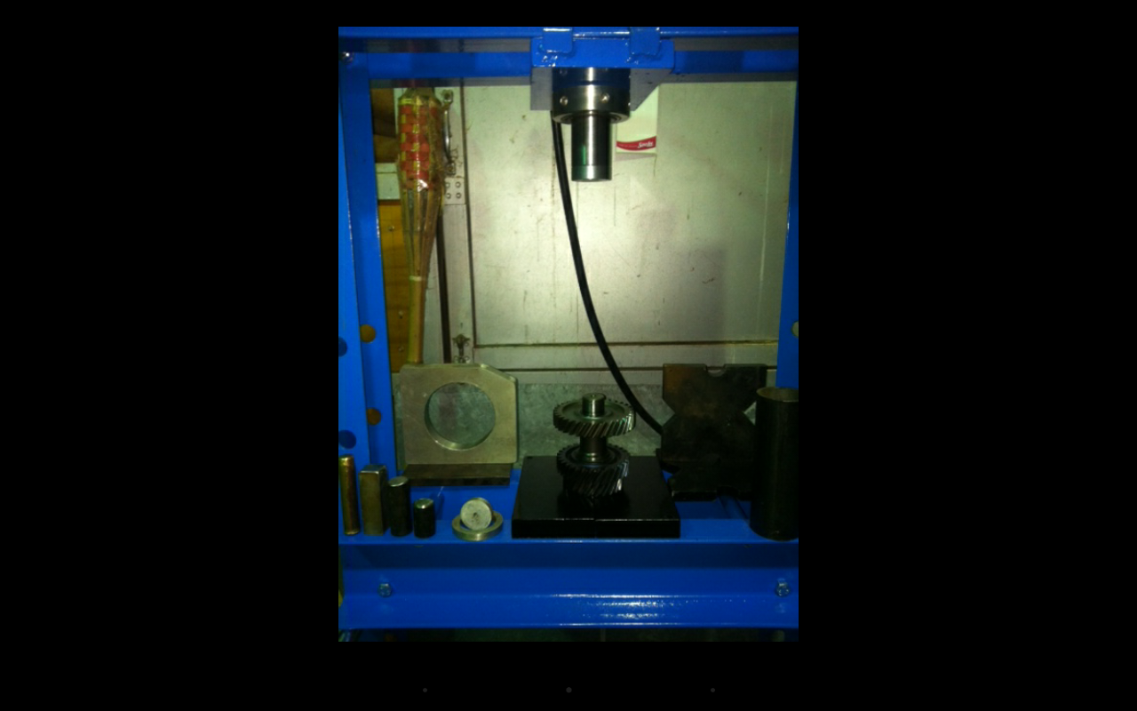

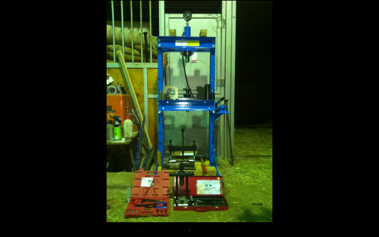

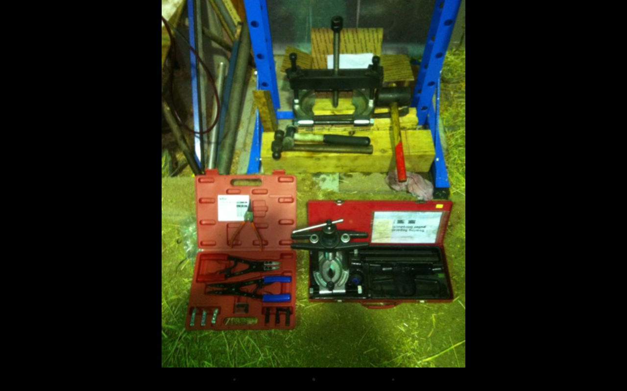

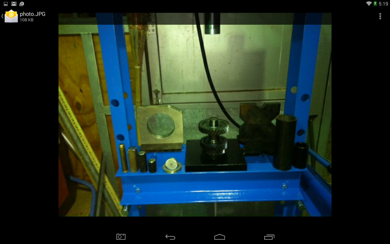

I rebuilt my gearbox about 18 months ago, I've never done a manual gearbox of any kind before this and was a bit reluctant but I've always wanted to learn and there wasn't anyone down here I trusted anyway so it seemed like as good a time as any, besides it was done only a few thousand km's before this because the previous owner ran it low on oil (incorrect filling procedure), he used a local gearbox specialist who shimmed it incorrectly because he cut his own gaskets. So why trust it to another idiot "specialist". Luckily for me I had profpinz to bounce my concerns off and he encouraged me to go for it. I should add that while I had never been inside a gearbox I do have a background in heavy vehicles and some earthmoving machinery so this did give a level of confidence.
I'm curious to see or read about specific pinz tools that people have fabricated to get the job done. Buying scecialized tools can be expensive especially if they only have very limited or one off use, for this reason where possible I like to make some of the tools needed for the pinz especially if I can save a few bucks. Here's a few pics of some things I've made that did the job nicely, I'm happy to add further details like exact measurements if people are interested. Show us what you've knocked up I'd love to see it, also include easily available generic tools that are relatively cheap and tools you've modified to make it happen....like basic puller sets or tie rod/joint breakers etc.

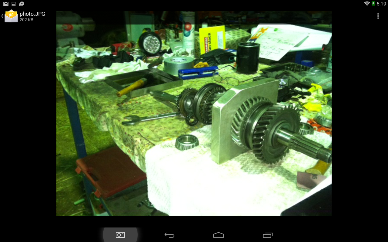

I'm not sure how to write captions in between or after photos so I'm starting a new post.
Apart from a gas barbecue with a hood to heat the relavant gears and syncro hubs up to temp (bit of help with an LPG torch) the tools pictured above is everything I needed to to the job and the manual was easy to follow with easy step by step instructions, everything makes much more sense once you get the box apart. IIRC the only parts I made are the big puller in the background, the aluminium press plate as well as a cut length of steel tubing to reach around the mainshaft/layshaft and the small aluminium ring and disc to protect the steel surfaces, I also bought a decent set of ratcheting circlip pliers which made life much easier .With these I entirely dissembled both shafts and reassembled it with all the needed new parts this time with factory gaskets which made the shimming a breeze. I took my time with it and I'm really happy with the result, its done approx 10000km since the rebuild and its still running smooth and quiet.
If you think you might be up to this job then I reckon go for it as it wasn't that difficult.

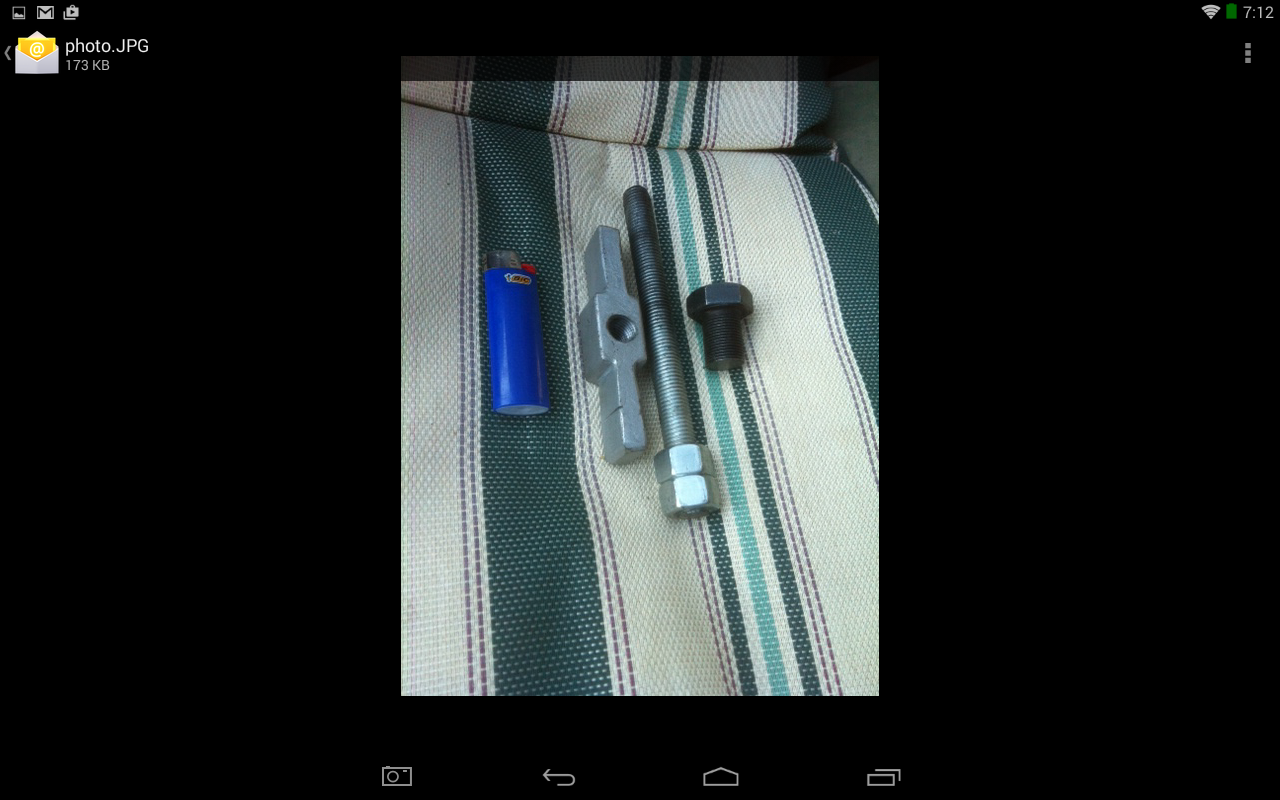

CRANK PULLEY PULLER.
This was really easy and worked perfectly, it works exactly like the factory puller except I used a bolt cut to length to screw into the end of the crank to push against instead of a press disc to protect the internal thread of the crank. Its only a piece of all thread, two nuts and a piece of steel I ground down (angle grinder) and tapped a thread into, oh and the cut down bolt, make sure the outside diameter fits through the inside pulley diameter or you'll be pulling and pulling and you'll get nowhere but your probably used to that...I am
I probably have a couple of other little things but I'll wait and see if people are following.

Just a comment: When making tools like your crank pulley puller, I've found that Acme threaded rods work much better and last much longer than standard threaded components. I get it cheap here: http://www.surpluscenter.com
Re: Show us ya tool...pinz specific tooling
Not sure what the term "Acme" means exactly but I definitely use high tensile or a hardened all thread whenever its available and the thread pitch I chose matched that of another small puller kit I have, for versatility. It's probably not that important for the crank pulley above as they usually aren't on there that tight.
Depending on the application sometimes softer or more forgiving steel is called for to avoid damage to the hardened surfaces of the parts being worked on, it depends on the job but hard steel is generally best for pullers and most other tools.
