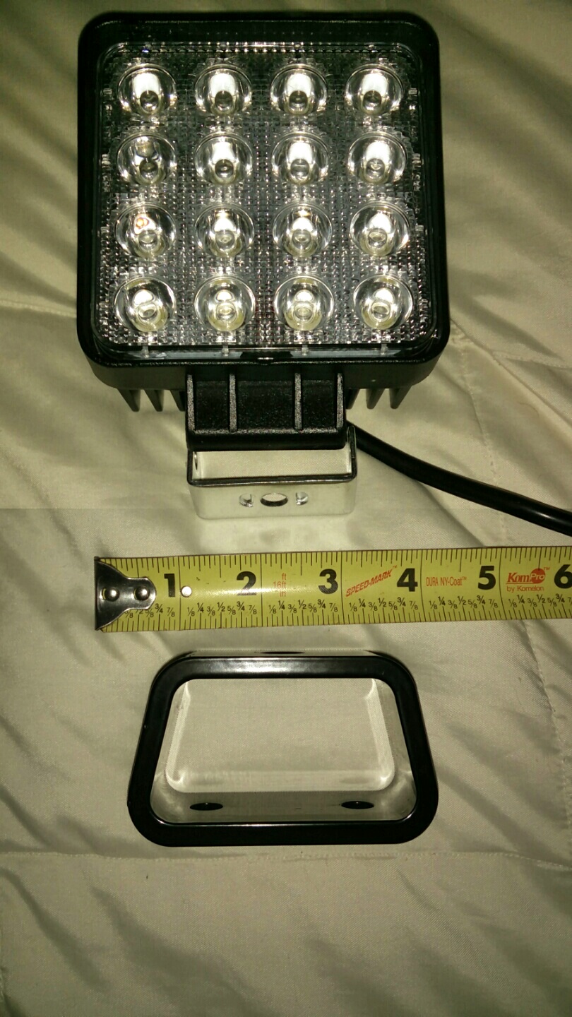

I bought these lights.
https://www.amazon.com/gp/product/B00Q6 ... UTF8&psc=1
Now, I don't know where to mount them. I want to see what yinz have done to save me trial and error. I am going to use these as driving lights. I have aux jeep hood light mounts. 3 inch square pedestal. Also, where to tap power wires? I'm going to use a 24 volt relay.. Thanks, Brian

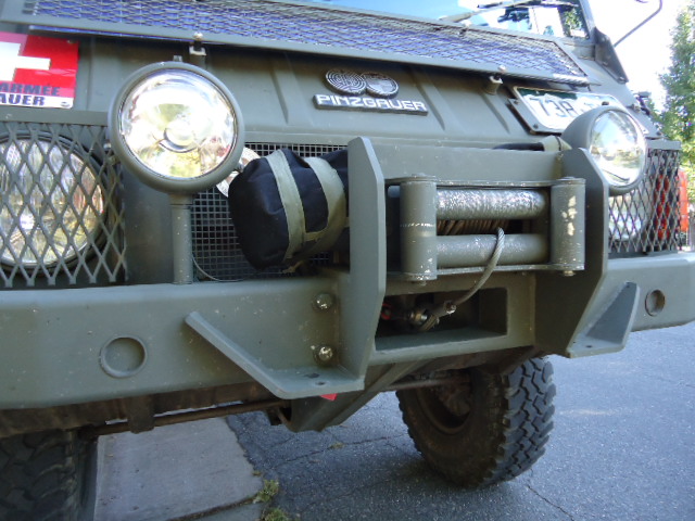

Won't be posting many pics after this but, this is mounting for military spot lights. Long bolt through tube into drilled and tapped hole in bumper.
I would think the idea of mounting your square lights to just about anywhere that you have existing bolts or on the front bumper would work.
Some states have height requirements for lights that are used as driving lights. Rarely does anyone look too closely at lighting that could be thought of as military on a vehicle like these. Paint them OD.

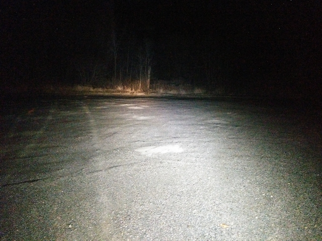

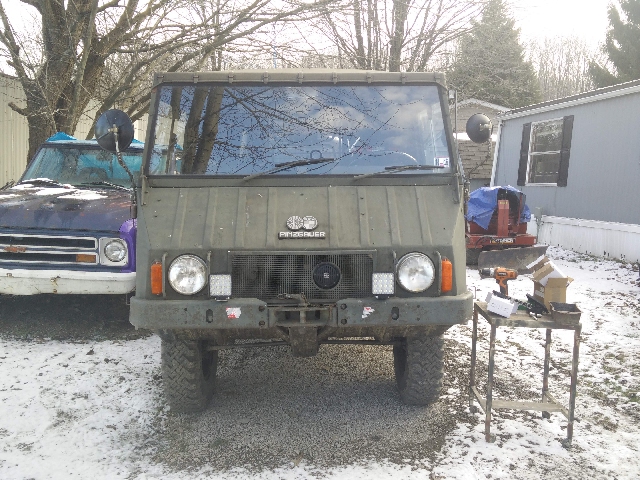

Hello, I got the lights mounted and working. I had removable mounts that I used to mount on bumper. I just can't get myself to drill into her until I'm Sure. I took out the mini spotlight plug next to flasher switch. I had an 8 amp breaker that fit loosely in the hole. I then plugged wire from the back of mini spotlight plug to new breaker and breaker to lamps and WaLoo..Push/pull switch operates floods. I had routed wire thru hole in tunnel that horn wire goes thru and then out of grate to lamps. Put all wires in plastic loom, and out of bottom of grill. I just had to put longer machine screws in bottom of grill so I wouldn't crush wire. Loom helps protect over edge of grill.
- All lights on. Notice color.
- IMG_20160109_floods and highbeam.jpg (232.54 KiB) Viewed 7920 times
- Just flood lights
- IMG_20160109_floods only.jpg (226.02 KiB) Viewed 7920 times
- high beams.
- IMG_20160109_highbeam.jpg (186.75 KiB) Viewed 7920 times
- Looking at flood only
- IMG_20160109_look at flood.jpg (165.53 KiB) Viewed 7920 times
- 50 paces looking at truck. Hi beam only.
- IMG_20160109_look at highbeam.jpg (405.88 KiB) Viewed 7920 times

- Lamps mounted
- IMG_20160107_penny with floods.jpg (288.6 KiB) Viewed 7920 times

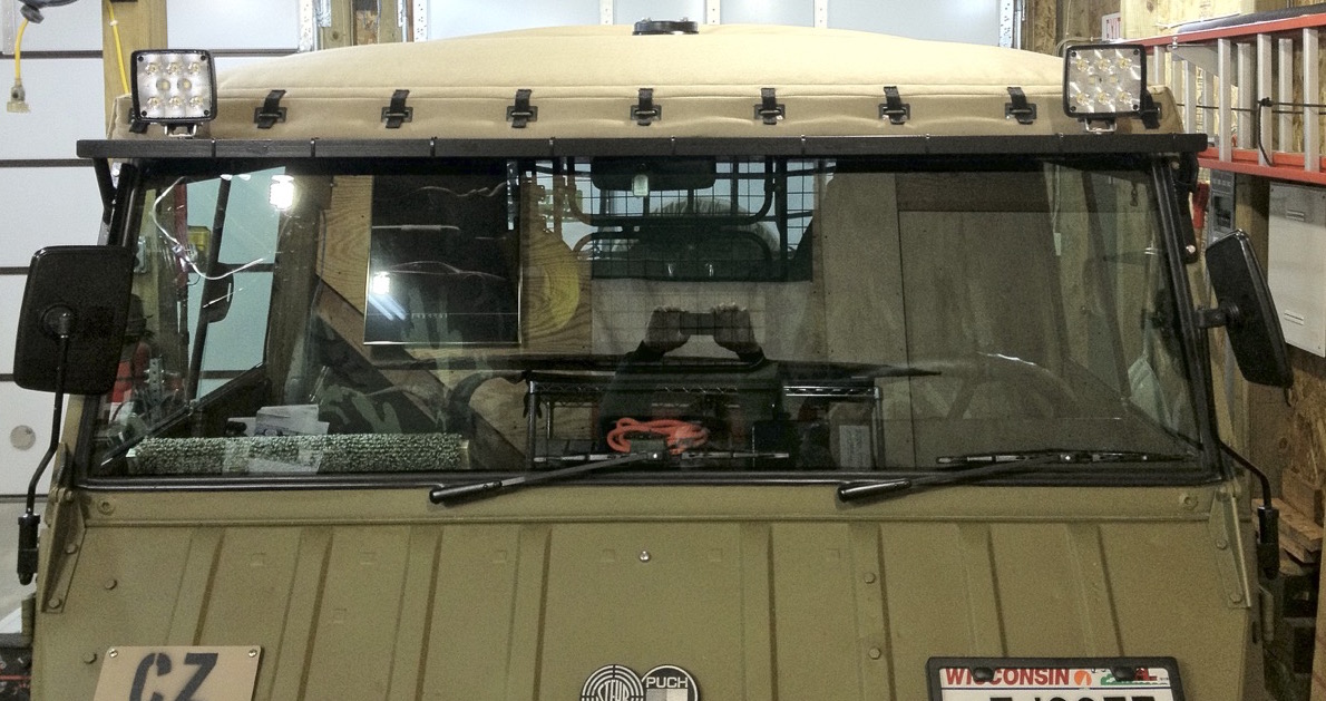

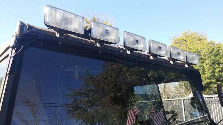

One possible option that I learned about just recently from Acebee is a light bar mounted at the top of the cab.
See PIX, ala Acebee 712, dono if this is a custom fab or a unique Pinz option. It's a real nice setup. The mounting
uses the existing M6 bolts located on the windshield frame (2 on each side) -- If you don't drop your windshield that is.
But then you would have two lonesome Lights begging for more
Might be good for 2 spots + 2 floods.
There is also a grommeted hole on the drivers side just below the mirror, you could exit power into that to the dash.
Sorry! I didn't know about this idea before.

Lights mounted up high are not always the best - can cause glare on the windshield (not much issue with a hood on a Pinz and the windshield is pretty verticle!)
It is best to mount high powered lights further back. All the J**P's and trucks with them mounted right above the windshield are more look than function (IMHO). My buddy's P/U truck is horrible and he even added a flat black vinyl patch to his hood - still glares off his front bar and the top of dash is nicely lit up
Here is a link that covers some of it: https://www.youtube.com/watch?v=pa1-OKKl2pA
Any Pinz owners that have this setup would be good to hear from you on the topic as the Pinz is a completely different shape so it may work :?:

I haven't experienced any noticeable glare with my 2 LED spots. Maybe because they aren't floods? I made my own bracket and used the existing bolts in the windshield frame as mentioned earlier.
