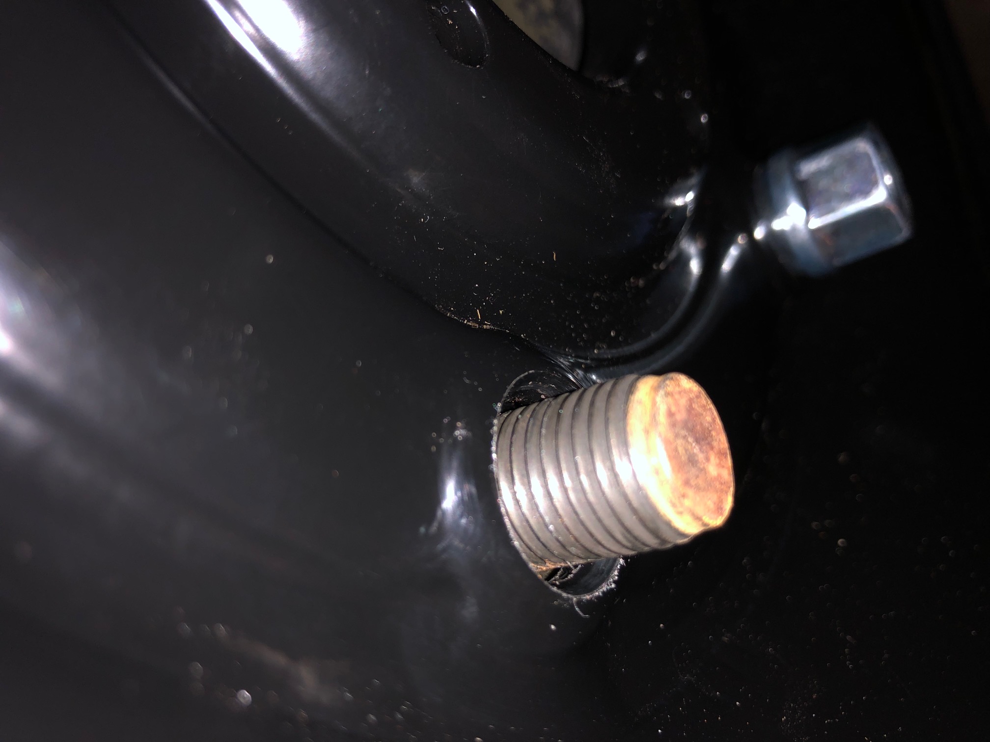

Looking for information on longer wheel studs. I have aftermarket aluminum wheels that don't engage enough threads. Also do you have to remove axle to replace the studs or the be pressed off while on the vehicle?
Can anyone provide measurement for the length of stock stud?
Thanks in advance. Thanks

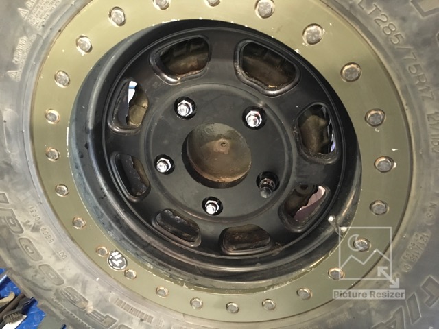

I spent a lot of time trying to locate longer studs found some dodge 3/4 ton that would probably work. The dodge one are a few thounds smaller in the serrated area so I was a little concerned. Then I found some Gorilla extended lug nuts. Problem using these was the clearance of the wheel holes is .609 and I needed .625 for the entended nut to go in. I called Trail Ready Wheels this morning at 0730 and actually got someone to answer. He said drilling out wheel to .625 5/8 inch was not uncommon. After doing that I did test fit with chrome nuts. Hopefully that solves the tearing of the lug nut threads due to lack of engagement.

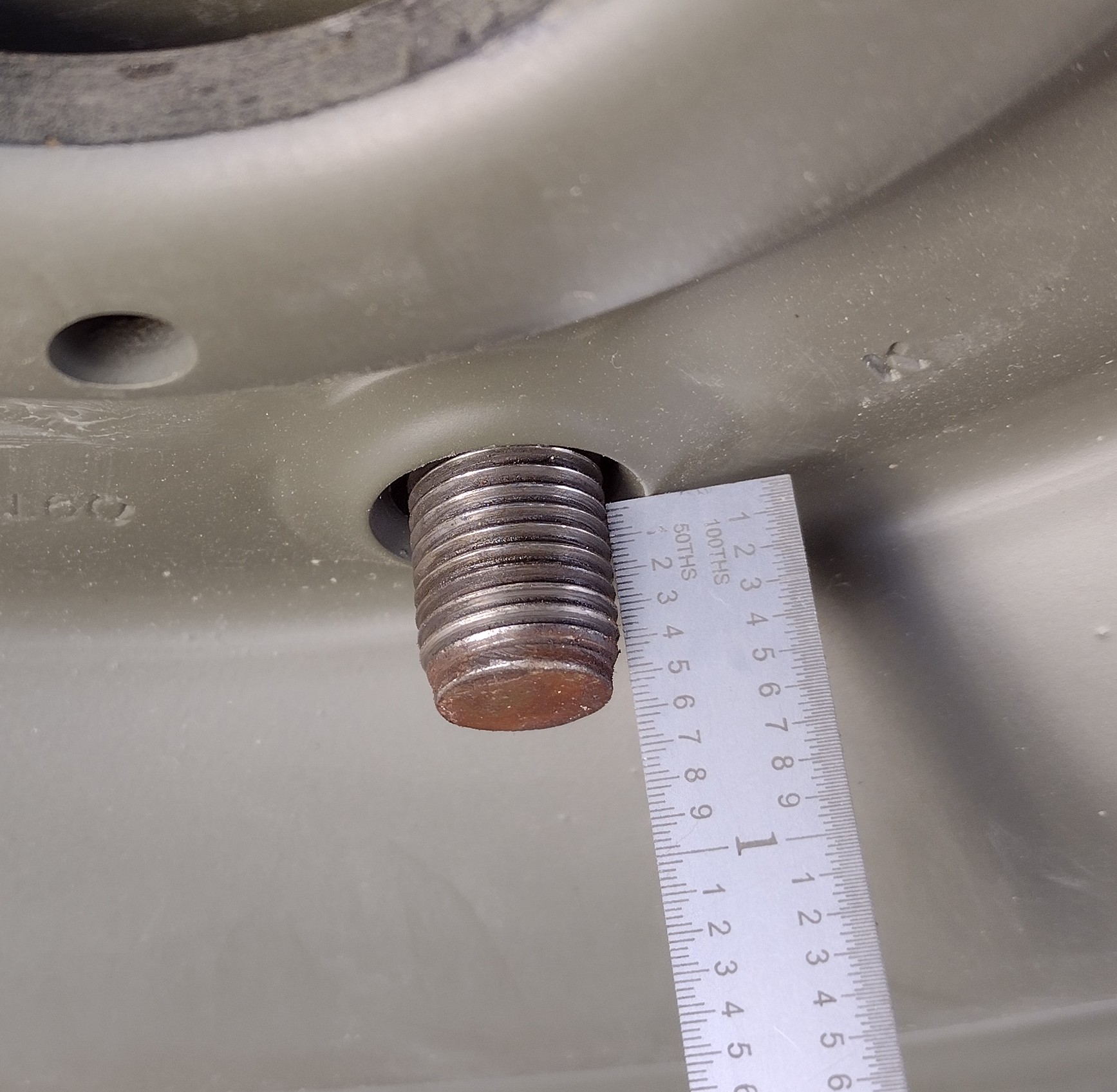

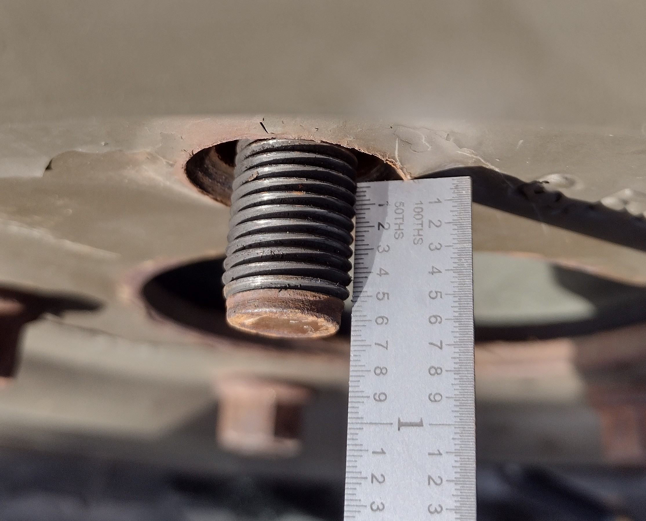

Made some measurements. And a couple of PIX's attached.
The bolt length that extends for capture for Stock Pinz wheels is
approximately 18mm. However, the effective length for the Transit
wheel and cone seat is only 13mm.
Pictures say it all:
Stock captures ~10 1/2 threads on a M14x1.5mm.
Transit wheel ~ 7 1/2 threads on the M14x1.5mm.
Based on how these Transit wheels are stamped, this actually adds up.
At 7 1/2 threads that's < 12mm, you really want at least the bolt
diameter 14mm, captured in thread engagement.
So my thinking now on these Transit wheels is that it's marginal. One
would ideally want longer wheel studs by at least 5mm or more. Or
one would be hoping that M14 is overkill and 11mm to 12mm of thread
engagement is more than enough -- hmmm, glad I only bought one of
these wheels and not 7

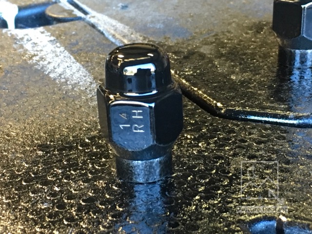

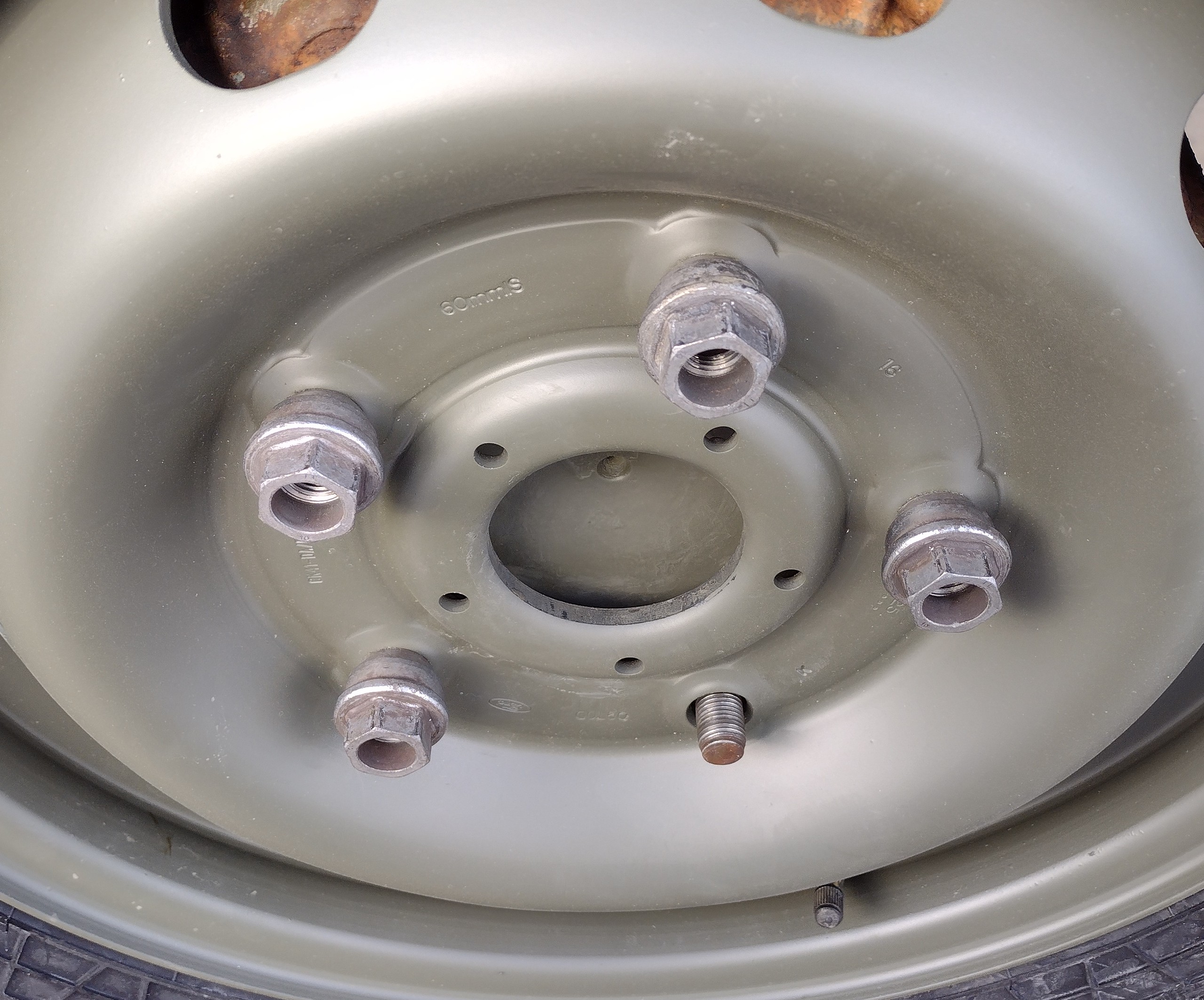

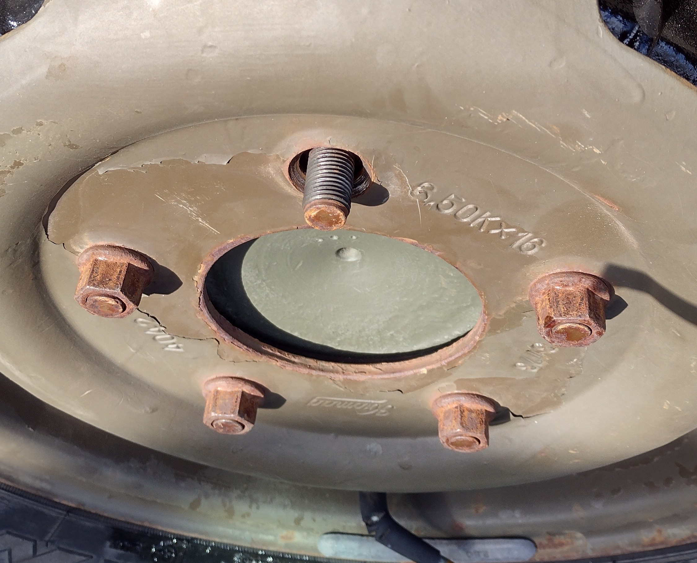

I just installed my Transit wheels today and took a couple pics of the thread engagement.
Here's a pic of the stock wheel, all torqued up with one nut removed. It has about .625" of stud protruding.
Here is a pic of the Transit wheel setup, again fully torqued with one nut removed. This has about .550" protruding.
I then took the difference in height between a ball nut fully seated vs it's overall length to see how much the nut goes into the wheel. This came in to be about .152"
And the same measurement with the factory Transit cone nut seated and it's overall length which was about .135"
So with measurements taken off of my setup, the difference between the stock wheel thread engagement vs the Transit wheel setup is about .090", that is, the Transit setup has approximately .090" less thread engagement than stock Pinz wheels/studs.
While the difference is something to acknowledge, it doesn't register to me as something to worry about. YMMV.

Re: Wheel stud replacement
I think what this shows is that there is a difference between Transit wheel manufacturers.
The one wheel I had bought -- as an experiment -- has a profile around the stud hole
where it is visibly raised above the surface "mushroomed" AND also profiled on the drum
side such that it is NOT flush with the drum surface. Both these effects subtracted from
thread engagement to a significant extent, thus far less thread engagement.
By the looks of your wheel the surface mushrooming looks less and hard to tell from
your PIX but it also appears that it would mate more flush to the drum surface. This
would all add up to more thread engagement thus more margin.

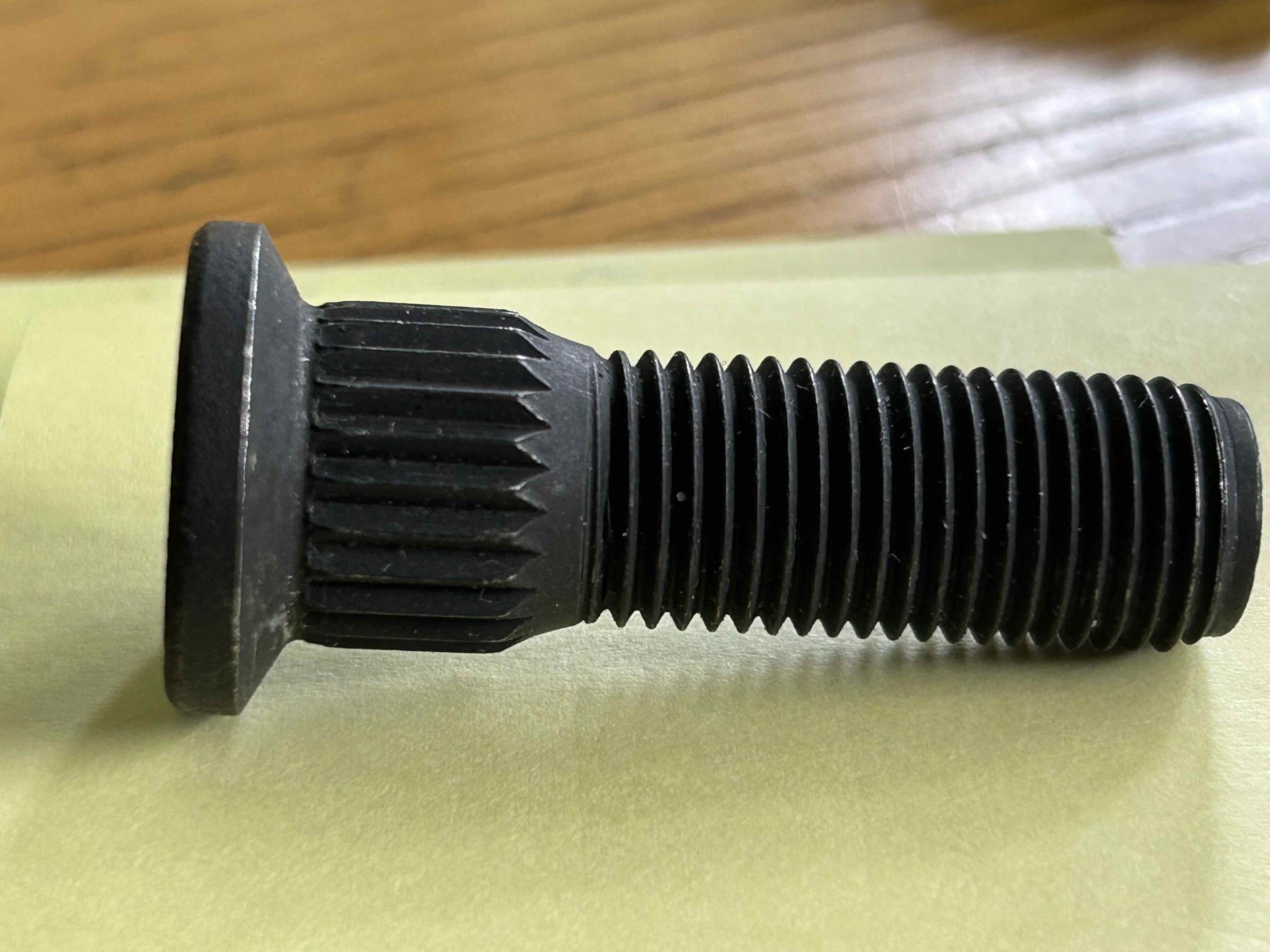

In keeping with the Subject "Wheel stud replacement", my conclusion thus far is that the
only stud that works W/O modification is the original Steyr-Puch stud.
It is unique to the 1'st gen Pinz, part # 710.1.34.324.1 there is no DIN equivalent.
There does not appear to be anything close out there; in the knurling pitch/diameter, but
more important and subtly, the stud head is rather large and has a 30-degree chamfer
facing the flange mating surface for stress relief under high load. I can't find a reference
to hardness, but I suspect these are at least 10.9.
I am bringing this up because like many, I'd like longer studs for future Wheel replacement.
As a cautionary note, the chamfered stud and corresponding seat on the flange would be a
potential problem if using a flat faced Stud -- high stress point. I suppose it may be possible
to find a specialty washer with a 30-degree chamfer on one side -- clearance permitting.
Would love to know of any solutions to this issue out there.
