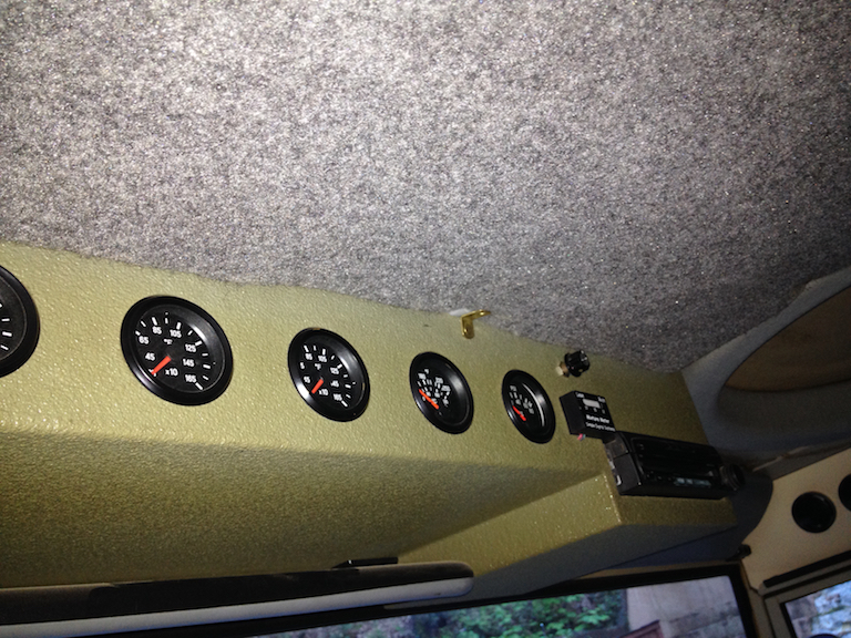

Just finished the install of this ICOM IC-F221 UHF radio. Bought 2 off eBay at a great price (one for the house).
A bit more to it to program and set up but one heck of a buy at $75 and 45Watt output, good programming features,
covers UHF HAM, GMRS and FRS bands all in one rig. Ended up mounting on the side of the dash, it's low profile
and light enough. The dash shroud is plastic, but relatively thick -- put fender washers on the inside to reduce stress.
Wasn't my preferred location, overhead is pretty cramped already though :wink:

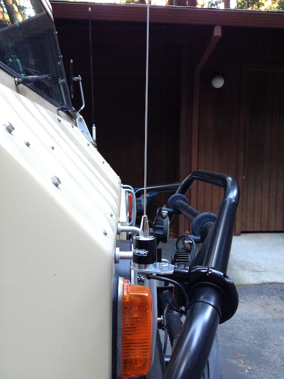

Antenna was easy, simple mounting flange and a Warn swivel clamp for 1.66" pipe not DOM.
Anyone interested PM me and I'd be happy to help Seller on eBay still has a few left.
