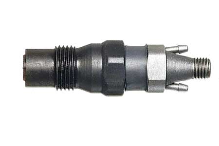

And for many injectors it would be tough to clean them this way I'd guess but these are 1980's diesel injectors that come completely apart; nothing but heavy metal pieces all around. Unscrews in half and is open.

Well that makes it more possible to get an internal clean, didn't know these injectors came apart.
