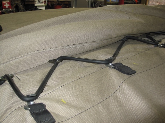

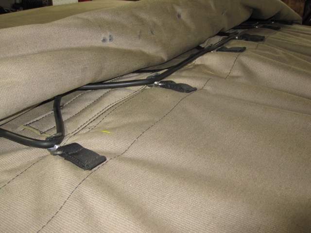

There is a rubber bungee cord that extends from the bottom of each side piece (elephant ear) and up over the top to the bottom of the other side piece. Along the way the bungee cord passes thru some metal loops (4 per side) that are under the rear flap of cab cover and fastened in place by the screws holding the metal trim bars in place. The bungee cord is then stretched back to connect to the hooks along the front of the rear cover.
I have the same top and I'll try to get a photo later on.

It appears that you are missing the rubber cord that runs along the top of the roll-bar, under the front top and that laces down the elephant ears on the sides. If I recall correctly without going out to look at mine, it laces under the front top into the rear top, but then laces over the tops of the elephant ears into the rear top. There should also be metal D-rings along the top of the roll-bar which are held down by an aluminum bar which sandwiches over the soft top. You may be missing all of that hardware, but it should be easy to acquire or even fabricate new, as no part of it is unique or special.

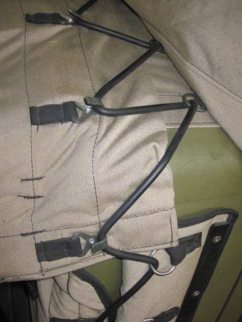

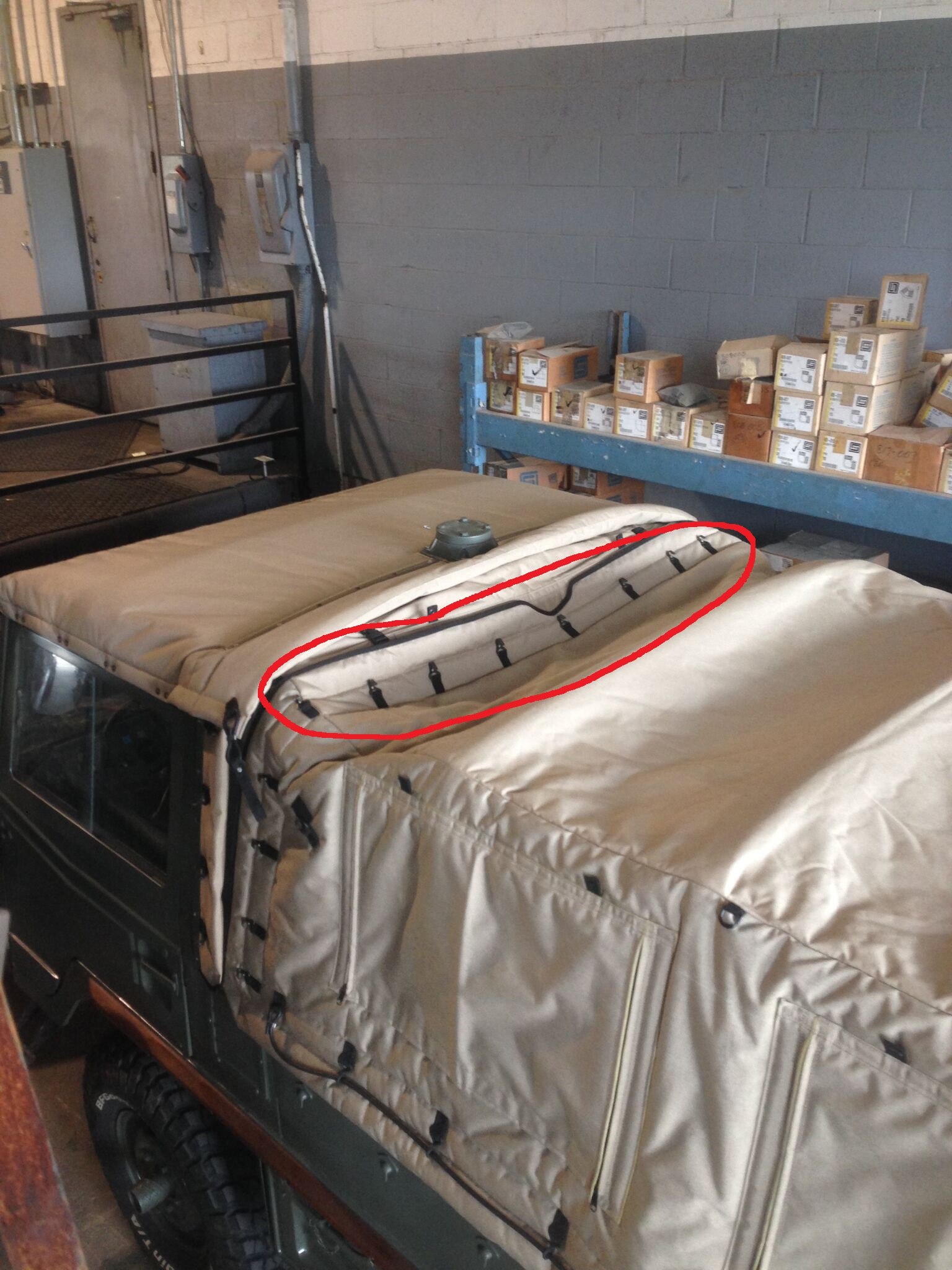

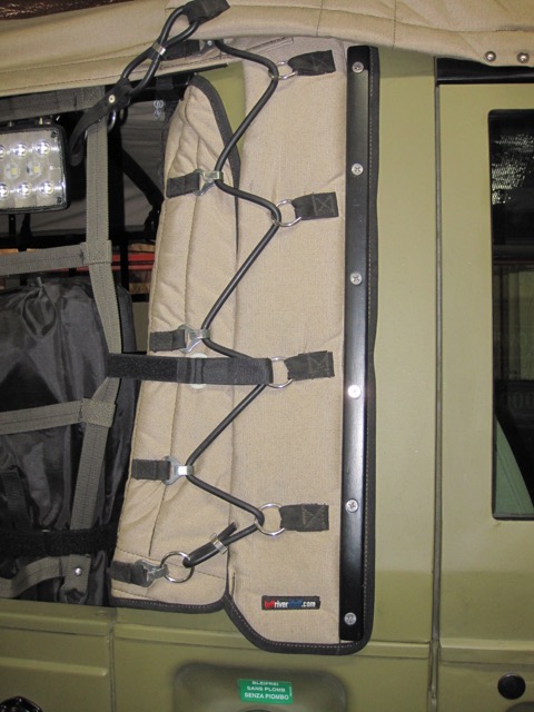

Here are a few photos. I have the rear bimini top on now but the attachment points are the same.

Thank you very much for the pics pcolette, that's just what I needed!

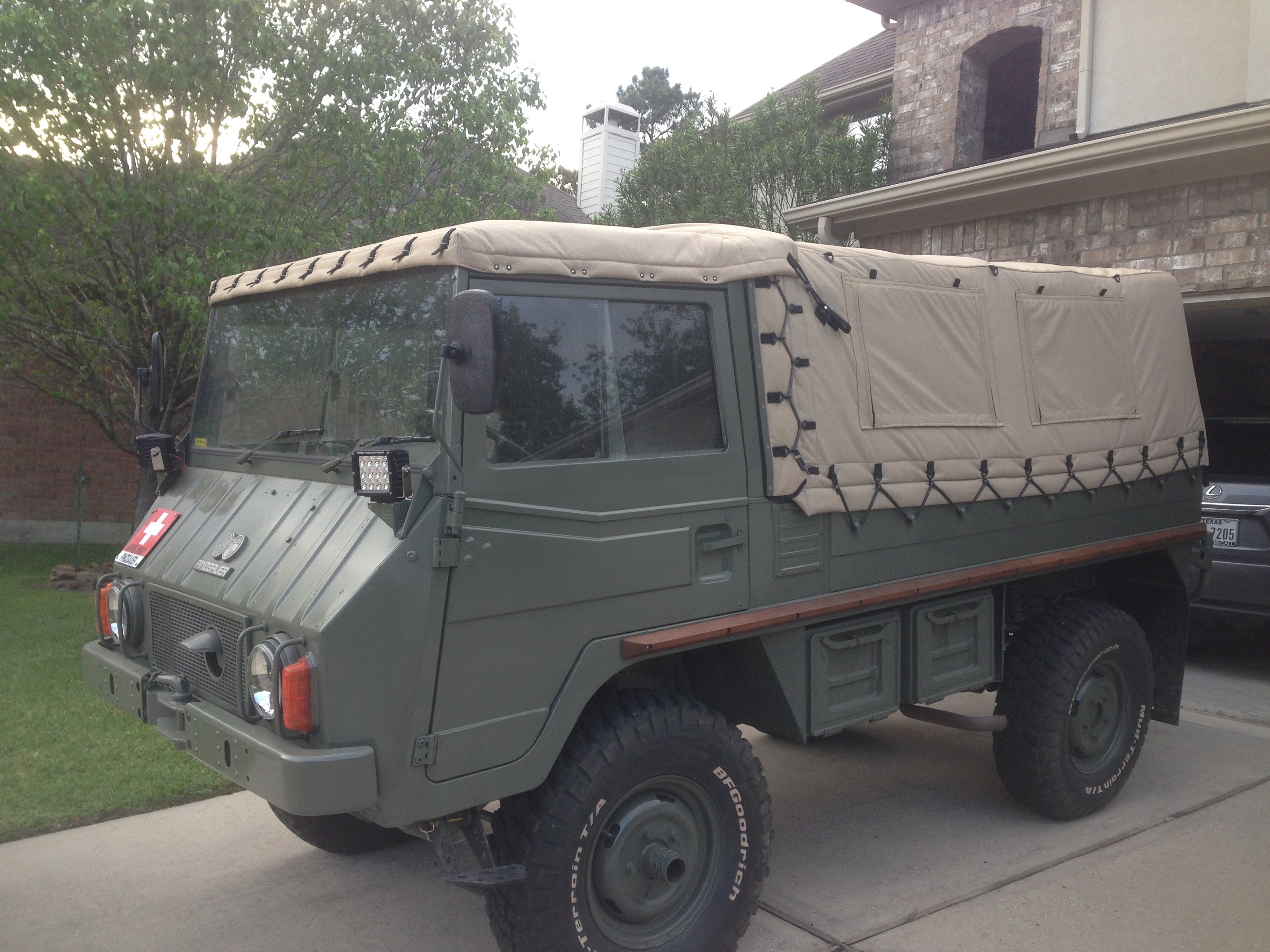

It came missing one rubber cord/rope. I ordered it in October and it arrive in late March. It is certainly a huge improvement over what I had, which was a crispy original top with broken windows...

Looks great. I really like those 2 color combos!
