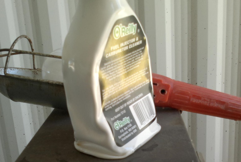

I wanted a bottle that would hold one dose (10oz) of diesel fuel treatment which could fit inside the spare tire storage lid. So I found a perfect fit and bought a 10oz $2.99 bottle of gasoline additive from OReilys and figured it would also hold the diesel version of the same thing.
Good thing I checked in there today. This was about 24 hours after adding the diesel stuff. It felt like a thick rubber balloon!

How about a stainless steel water bottle instead? On second thought, a camper's fuel bottle may be better and has a small hole just below the O-ring to release pressure as it is opened. Personally, I carry a 1L (about a quart) of additive in the brick shaped bottle it comes in from TSC along with a cheap graduated cylinder.
As for this fluid, toss it out! Contaminated fluid could bugger your high pressure pump or injectors. (You likely did this already but I would hate to not say it and hear of a problem later.)
