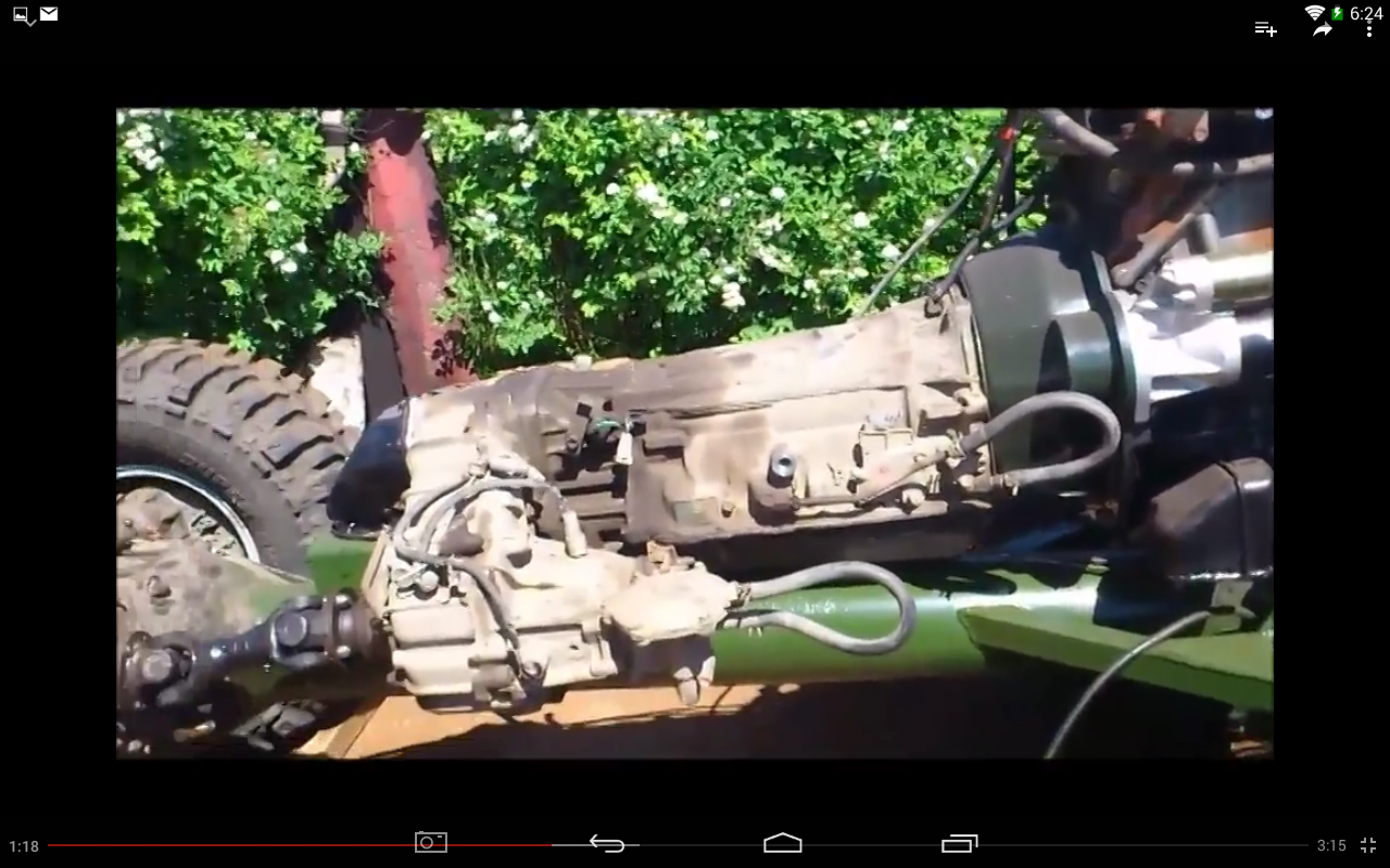

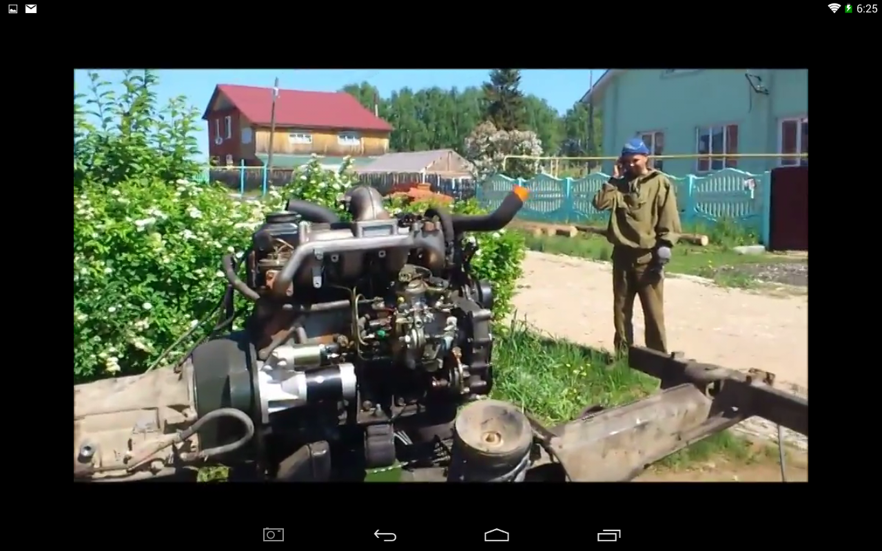

The Russian community have been playing with fitting complete Prado running gear including the Transfer case meaning twin Tcases there are two like this I know of...I posted a link here a few months back in a thread called "highly modified 712" that documents one of these crazy builds but you'll have to join the forum to read/view any pics but again its worth a look just out of interest. He's modernized every aspect of his 712 including CTIS, disc brakes and widened the entire body by 200mm just to mention a few things. I reckon this guy must burn money as a second hobby. He has a heap of stuff on you tube as well if your into that.
The pics are just YouTube screenshots from yet another crazy Russian build, looks like another Toyota drive line but not the one I spoke of above.
There's absoulety heaps out there its actually mind boggling that so many of these unique and quite rare vehicles have been butchered in so many different ways. Just google "Pinzgauer diesel conversion" but search images and open the photos that look appealing.

That last pair of photos will be hard on the drivetrain I would think with the automatic and the transfer case increasing the torque - one would need to keep a light foot on the skinny pedal.
Having the engine on top of the drivetrain will result in a very tall engine hump in the cab. Would be interesting to see more photos. I think the other Russian toyota engine conversion had it in the more traditional place next to the center tube? They had to widen the body of the pinz to allow the passenger seat to be fitted back in to it as the engine took up too much space.
