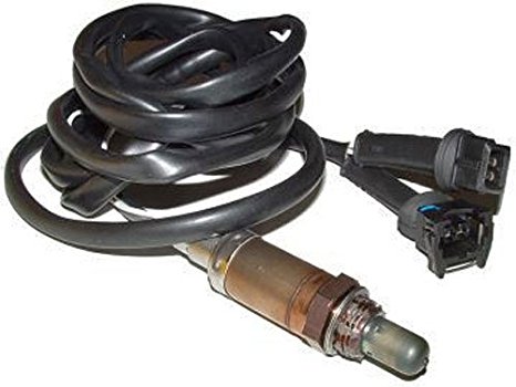

Here's an example of a Bosch Lamda O2 sensor (PN# 0258-104-002) for the Stinger 4.
Does your connector look like this one?
On Amazon and eBay, a wide-band sensor they ain't cheap bit over $150.

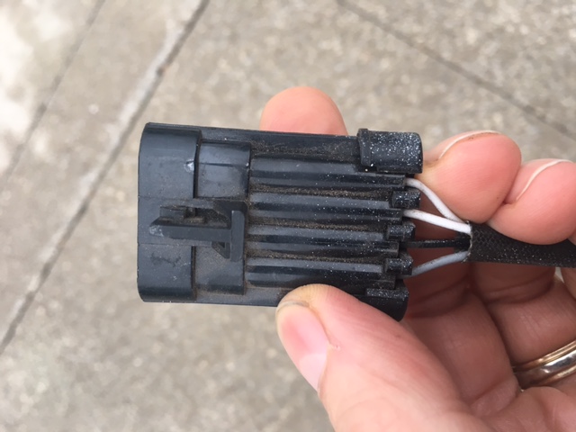

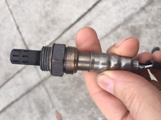

O2 sensor pix
You can see the broken white wire on the right - it had only 1 or 2 strands still attached

Re: Anyone know what O2 sensor?
Not sure if a solder joint there will work long term - there is probably significant heat coming up the wires from the exhaust and so the solder may melt. I would try it myself but would check it closely after a could of drives for signs of excessive heating. You might consider adding some silicone sealant around the wires for physical support as silicone can take the heat.
A wide band O2 sensor is handy as it can be checked with even just a volt meter to give you an idea of the mixture status.
Please report back.
If it was so hot to melt solder, the wire insulation would have been long gone. It shouldn't hurt to try soldering if you feel up to it...
