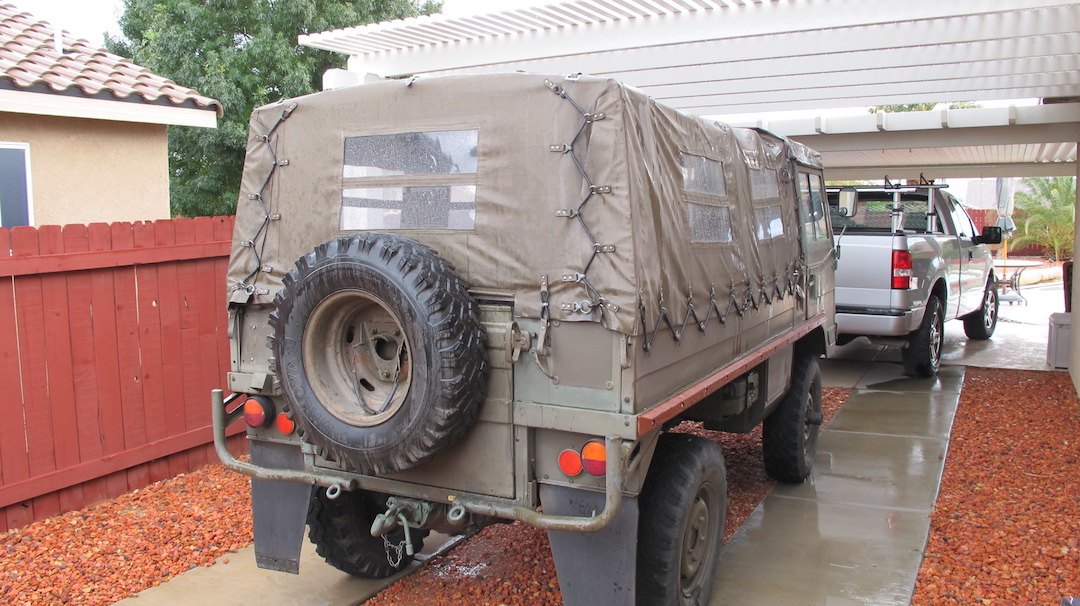

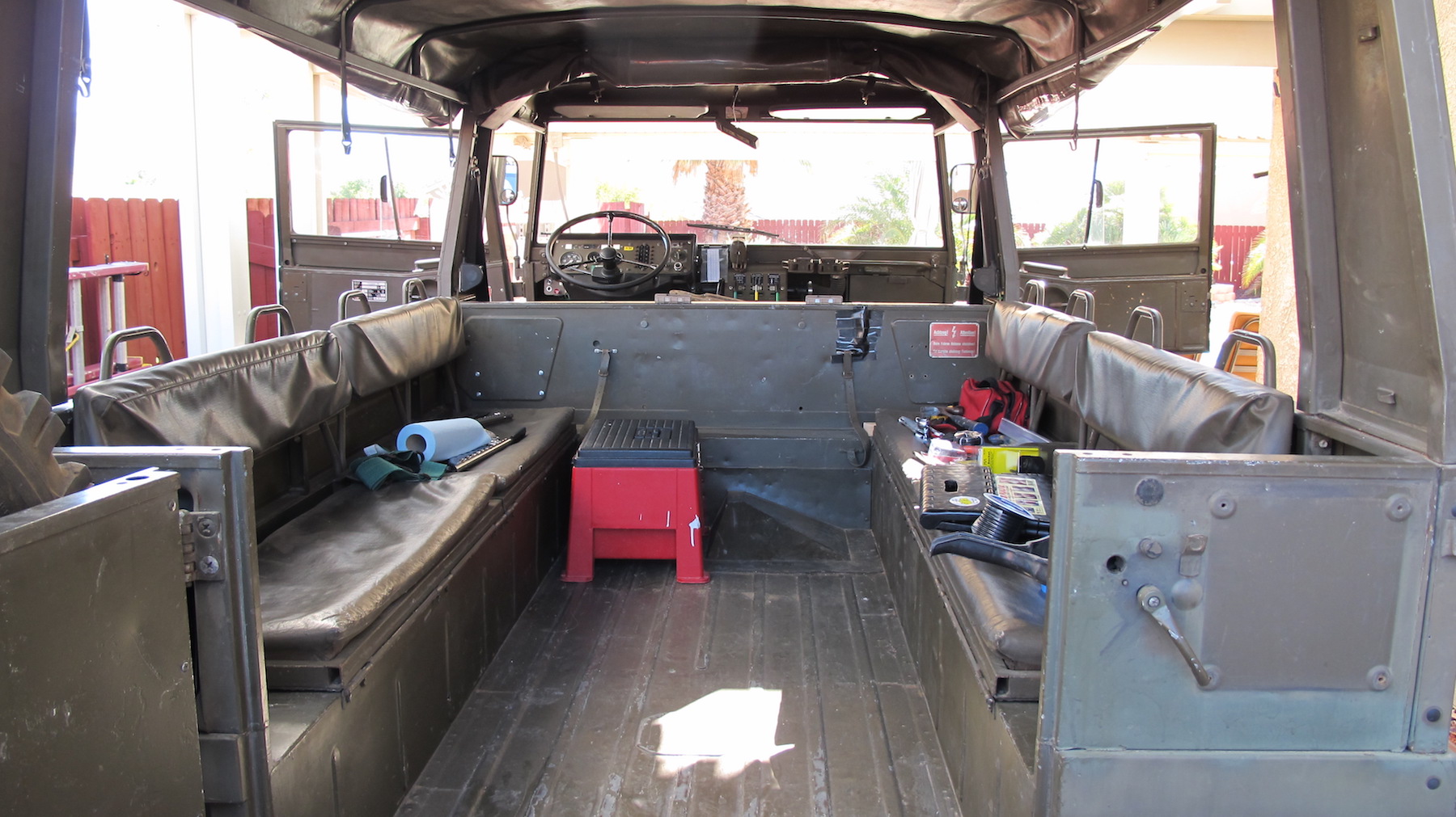

My brother and I just purchased a 71 710M here in Mesquite. Appears to be all original except soft top window replacement. Runs very strong, no clatter, might have been a backfire on starting once or twice. After driving it up and down the street and then restarting in 30 minutes or an hour, didn't want to start right up. Might have a hot restart problem, or we just don't know yet whether we should feather the throttle a little on restart.
Great forum, read lots in the past week. We'll keep the well worn and checked Maloya tires on the OEM rims for shows and will be putting on new SAV replacement wheels and BFG MT KM2 265/75R16s soon.

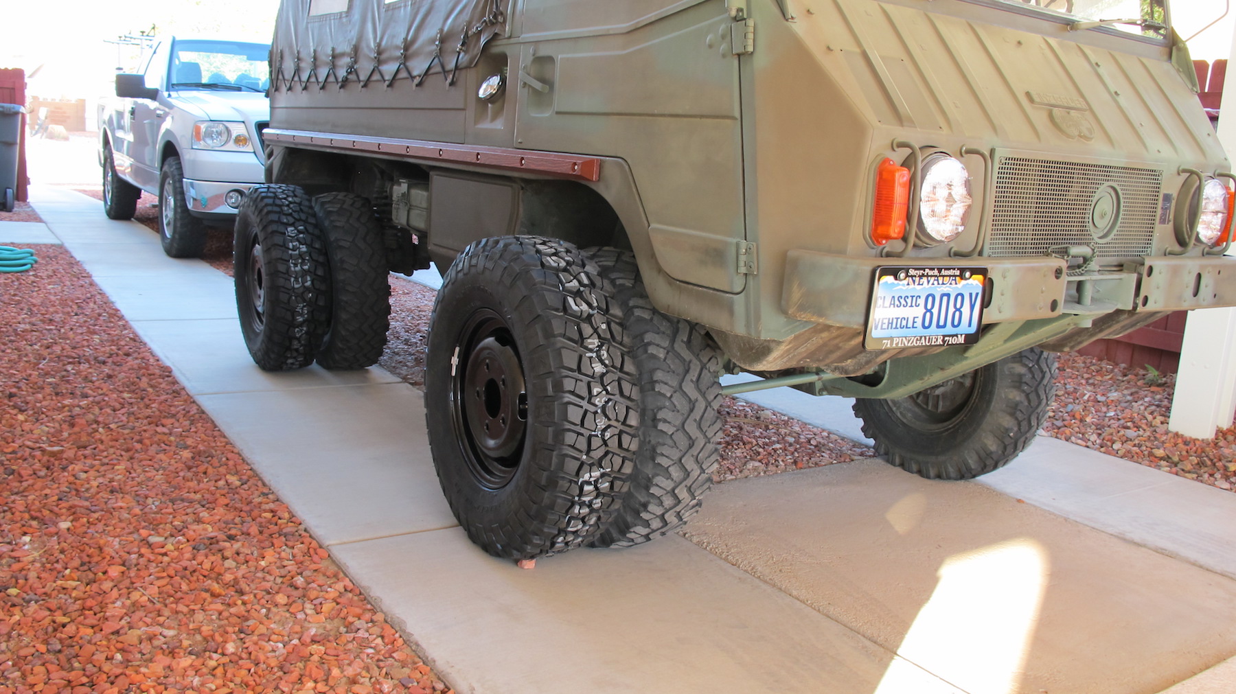

Here's a picture of the new BFG MT KM2 265/75R16's on SAV replacement wheels waiting to go on. I ordered some paint markers to black out the white letters on the inside sidewall, but they haven't come in yet.

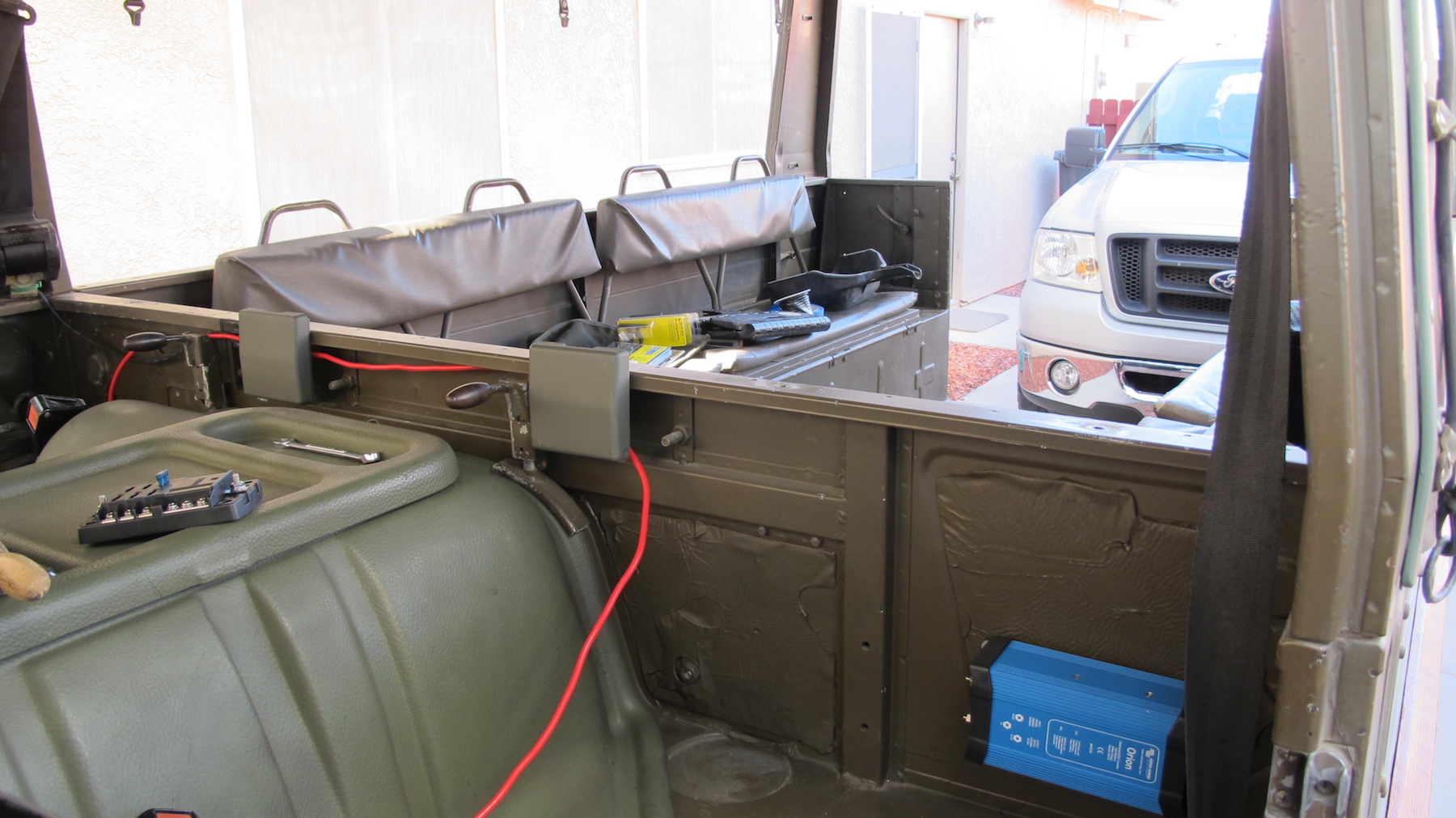

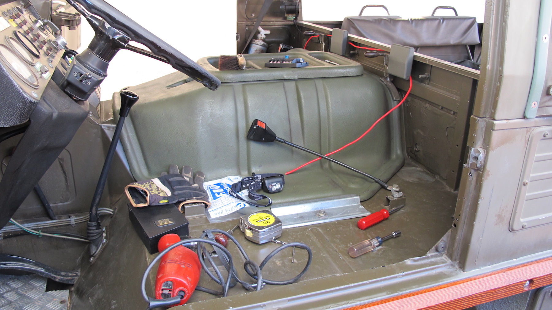

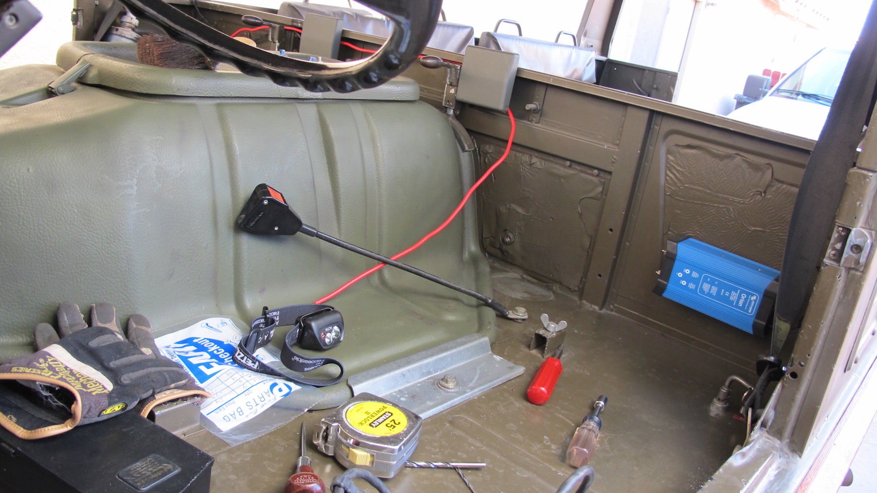

I pretty much have everything I need to get power from the radio plug to a new 24V-12V converter, then fuse box, then the users. The open workspace is great!

Re: Hi From Mesquite, NV - New To Us 1971 Pinzgauer 710M
Looking good!
I also have a Victron 24-12v converter - they are nice

TechMOGogy wrote:Looking good!
I picked it from a recommendation on this forum!

Is that a new doghouse (engine cover) from SAV. Looks nice and clean!

stiffler4444 wrote:Is that a new doghouse (engine cover) from SAV. Looks nice and clean!
No, it was on the vehicle. It does look better than a lot of pictures I've seen. It does have some cracks on the edge of the top piece that slips in. It looks like it's been painted some time along the way. I have removed it and it's sturdy. I think it's original.

How did you get your new wheels balanced? Unfortunately the Pinz wheels are true by Lug not Hub.
All tire shops balance from the hub assuming that when you mount from the lugs balance is maintained.
For proper balance you need an adapter that mounts to the wheel and gives a true hub reference -- you
may be lucky that the hub is spot on with the lugs, depending upon the vintage of the wheels. If you
have any vibration at speed on the HWY this may be why.
The solution for this is Tire beads rather than rim weights http://www.innovativebalancing.com/

Yes, I've read those threads. I just had them balanced the normal way since I didn't see anywhere to buy the adapter. The wheels are new ones from SAV. They did put a lot of weights on them (and on the outside!).
We'll see how it goes. If it's a problem we can use the beads like lots of you are doing. When you use the beads, do you take the wheel weights off first?

Yup, remove the weights the beads are all that's required.
I used this (or something like it(: https://www.walmart.com/ip/Crosman-Elit ... o/45848935. I did seven tires for my 712, over six ounces per tire. I just divided them up with a small scale and put each group in a ziplock bag and told the tire shop to add a bag to each tire. I've never had a tire off to check on them but after 4 years I still don't have any wheel vibrations. The "official" beads might be "better", but for less than $4 per tire I can't complain. Just don't get the biodegradable beads, and try to get the heaviest weight (0.25 grams or heavier).
