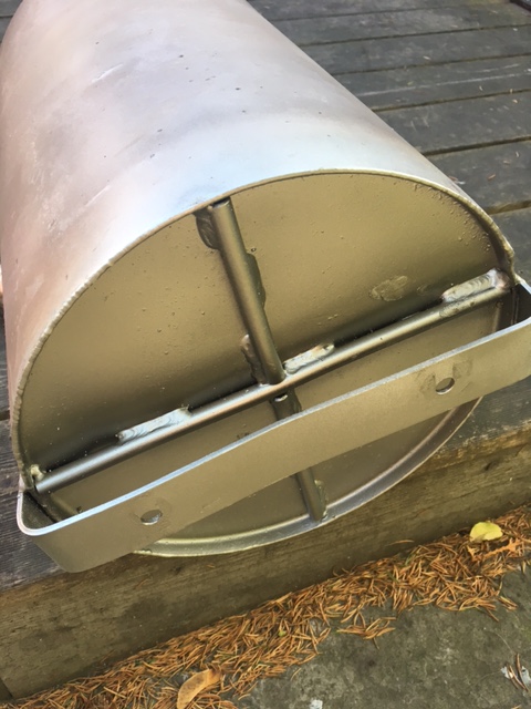

Scott got back to me and put me in touch with the manufacturer
I would never believe it unless I was there to test it myself - no issues, it is 100% harmonic reverb from the back plate!!
Newer ones have a piece welded across it on the inside to stop this. I will just have a small 1x1 channel welded across the outside to stop it. For now a piece of wood is jammed in there and is working perfectly :)
Easy fix and like I said I would have lost a ton of money on it!

Just as a follow-up here is how the muffler reverb was stopped
SS rod welded to the rear plate.
