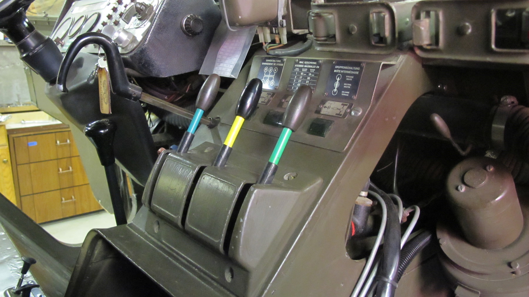

Got the new locker knob installed today. I used a small flathead screwdriver inserted alongside the metal insert resting in the knob to push the metal insert together and was able to push it in the smaller hole in the knob just a wee bit. Then tapped it with a hammer lightly holding the shaft, until it was not seeming to go further with about 1/4" left to go. Then I turned the knob by hand and got it the rest of the way down. After knowing this now, I'd probably try turning it down by hand the entire way.

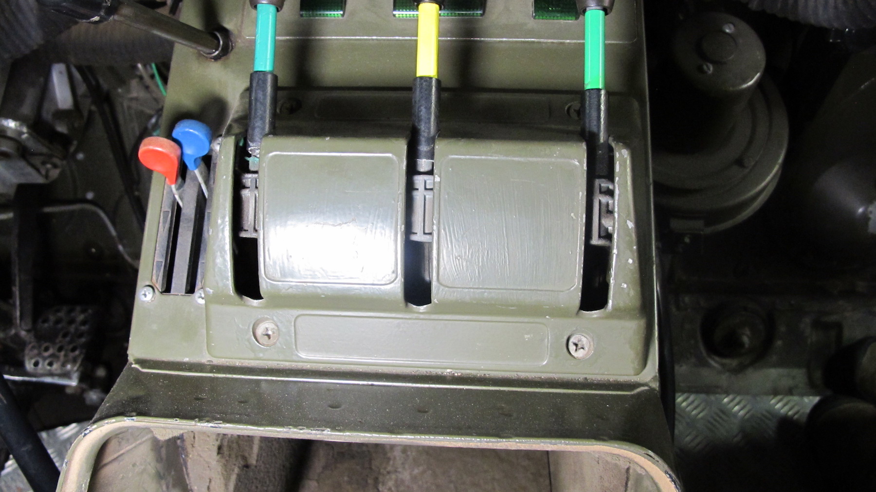

What's the black on the locker levers?

Interesting observation, I've never paid attention to that before. It looks like someone has put plastic tube or rubber hose over the levers. It does fit perfectly in the body locker slots. Maybe to eliminate side to side movement, I notice the center one will move a little side to side.

I enlarged the picture to see better, and the white at the bottom is white cord in the hose, so it's rubber hose of some type.
