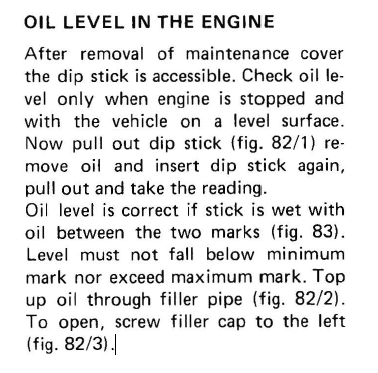

Re: Engine Oil Level Too High
Posted: Fri Nov 04, 2016 9:02 am
From the Operators Manual:
11-4-2016 10-02-02 AM.png (106.4 KiB) Viewed 9927 times

The manuals do not say, but it will make a difference if you check the oil immediately after shut down (it will read lower, as oil is still coating the internal engine components and passageways) or after it has set for a while and all drained down into the pan. I'd rather have too much vs too little, so my personal preference is to check the level after it has been running recently. Mine probably reads high after a few hours, too. I wouldn't worry too much about it.
