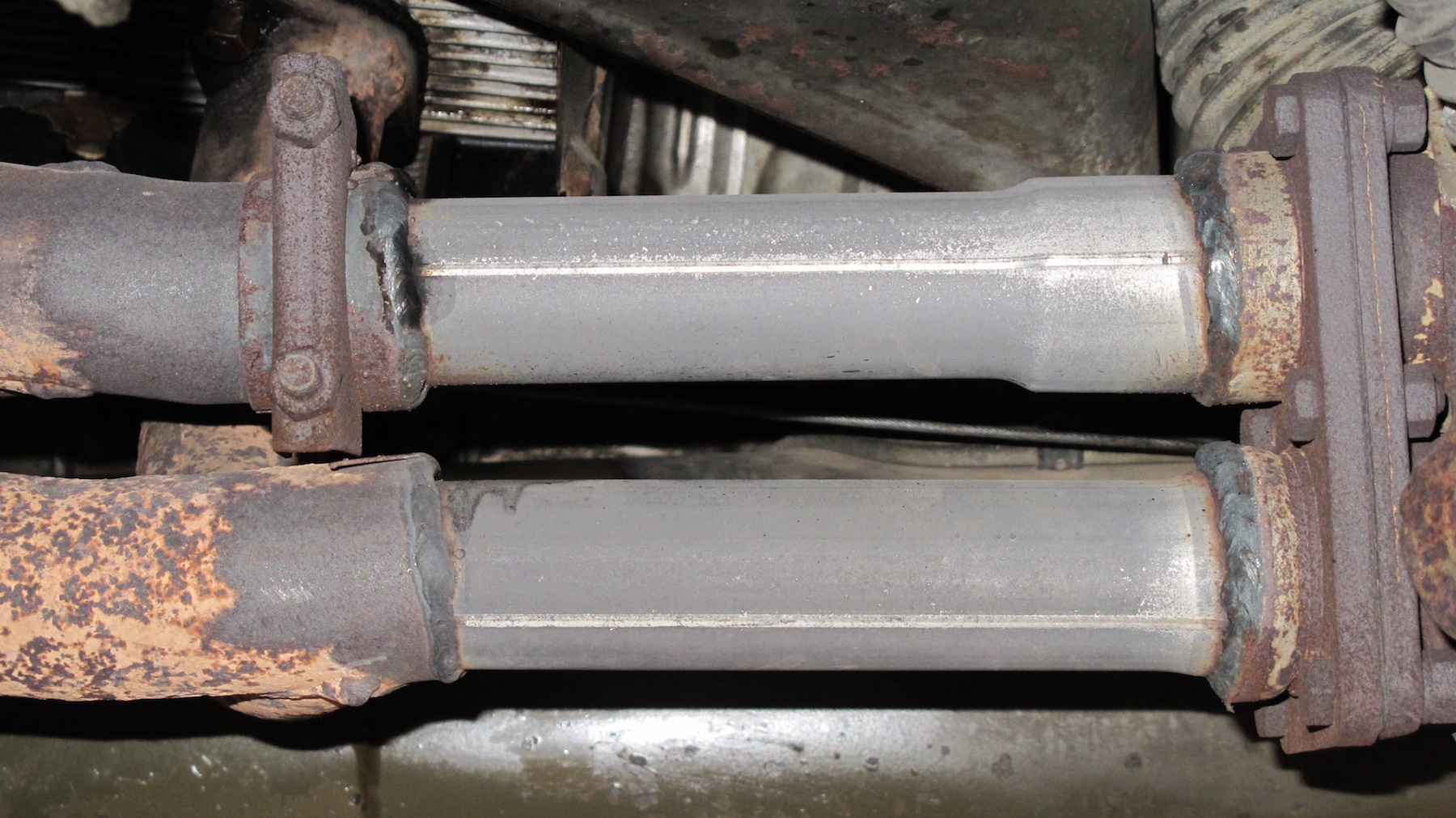

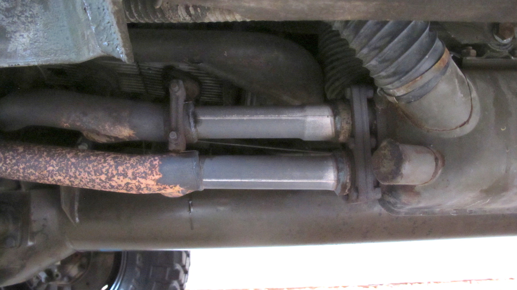

After having our new to us 1971 Pinz 710M for a couple of months and frequenting this forum, we're learning about what we bought!
Somewhere along the line someone cut out the OEM tail pipe bells and welded two smaller pipes in their place. I see that as a problem because there's no allowance for expansion and it's probably been stressing the headers and cylinder heads. So I probably need to get the SAV flex exhaust like so many of you have.
But I haven't found any pictures of the SAV flex kit installed and would like to see some.
Here's mine, I'm afraid that there isn't enough OEM pipe on the headers to make a flex pipe work. Does that mean new headers ($$$$) or a muffler shop modification to make the SAV kit work?

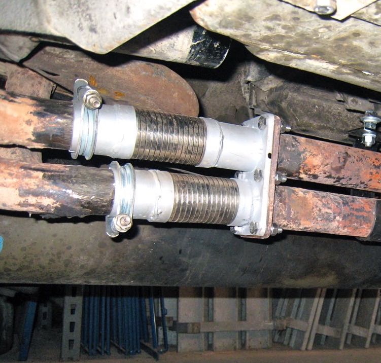

let me show you my dyo kit using flexpipe for a Fiat Punto
and that is the kit installed
Albert

looks a bit short on the header side. Not sure what the exhaust clamp is on the upper header since the pipes are welded?
I would suggest getting the kit from SAV or EI and taking it to your local exhaust shop for them to weld it in on the header side to the original headers or the extended pipes.

Haf-e wrote:looks a bit short on the header side. Not sure what the exhaust clamp is on the upper header since the pipes are welded?
It's just an exhaust clamp - whoever did this just left it and the short piece under it on.

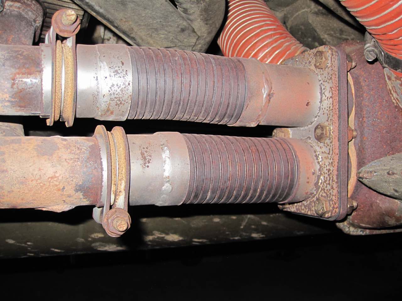

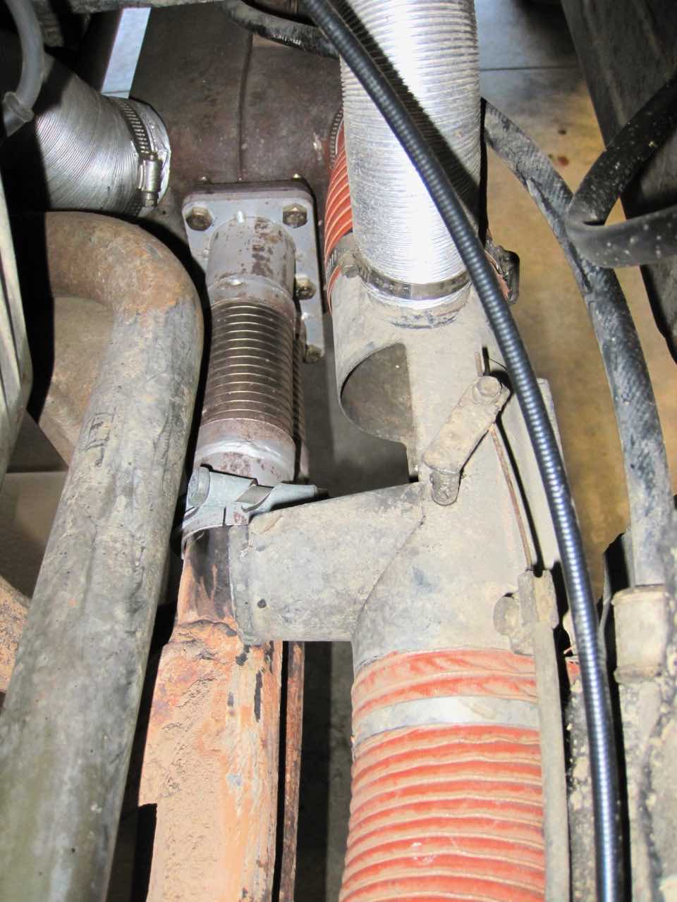

Re: Need Pictues of SAV Flex Kit Exhaust Installed
Here are a few photos for reference:

Thanks pcolette. Just what I needed to see.
Looks like my headers are cut too short, but new short pieces to match the SAV kit could be welded on.
