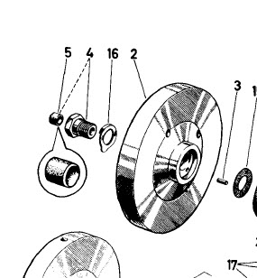

I am still working on my Haflinger project. I didn't get an engine with mine and couldn't find a reasonable one so I am going with a Subaru/Robin unit. Brand new and warrantied for 5 years. I have an original clutch assembly that will be mounted to the drive shaft. Am I correct that the unit mounts to the original drive shaft with what looks like a stubby hollow bolt that goes into a threaded hole in the end of the drive shaft. The bolt also holds a needle bearing for the transmission shaft and is secured with a fold down tab type lock washer?

So yes your correct
#4 - Fixing Screw M24 x1.5
#5 - Needle Bearing for clutch shaft
#16 - Lock Washer

Its very similar to a "Gland" nut for a VW air cooled engine.
What is the shaft like on the Subaru motor? You have a solid 1 inch shaft with the 3/8 keyway - correct?
Best option would be to machine a recess in the end of the shaft for the end of the transmission input shaft to go into it to provide support. I've done it on electric motors (using the motor to spin itself like it was on a lathe - but never with a gas motor - but I suppose it would be possible...
You'll also need a way to adapt the flywheel to the 1 inch shaft with a keyway slot in it - again - I've cut these slots by hand with a file a couple of times - not that hard just time consuming with a lot of trial fitting over and over.

Re: Haflinger Clutch Assembly Attachment inquiry
That is the direction I am headed with the hole in the drive shaft threaded for the fixing nut. I have the added advantage of a machinist and full shop eager to help. Once the flywheel is fitted the engine mount will be fabricated by the same guy.
