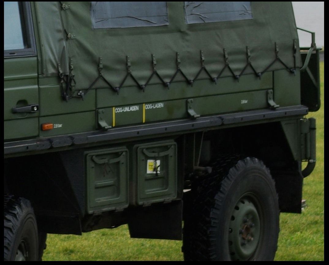

I am assuming what you want is the "center of gravity" point of the 710M which is the meeting point of the X,Y axis.
I don't remember seeing one for the gas Pinzgauer, but MoD 716M /718Ms do have the CoG marked for unloaded and loaded position (fore/aft)
For the distance from the ground, I'd imagine it would be fairly close to the central tube height, but doubt it would be any higher than the cargo floor.
The longitudinal CoG may be considered bad on a Pinz by some because of the high ground clearance and narrow track.The TDs have a little wider track to improve the side stability.
The Humvee has a great side stability because of it's wide track... but people still are able to roll them.
- Pinzgauer-4x4-01 cog.jpg (91.23 KiB) Viewed 4862 times
