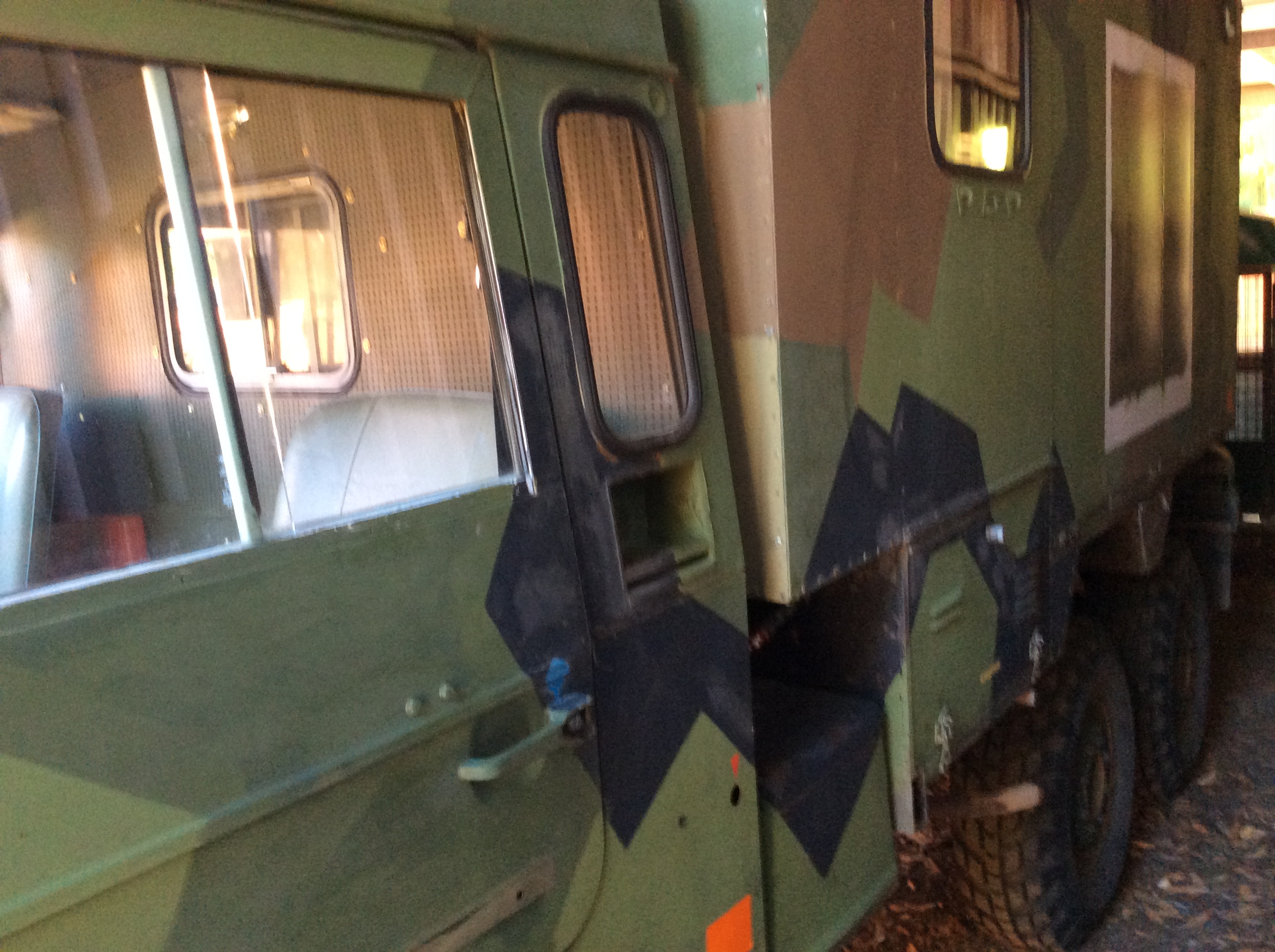

Rocinante many Alu zincs were just the solid green "base" without camo, it sounds like yours is probably a newer Alu zinc type body truck that was part of the "refurb program".
A couple things to look for are....1- no wooden rub rails and 2- the older type bodies have a "foot hole" box type step to help with climbing on the roof, this is located on the drivers side behind the front door just below the rectangle window. Alu zinc bodies do not have this foot hole. Alu zinc newer body above. Older style original body.
There were some other goodies the "refurb Volvos" got. A modified air intake system being one, the older style intake system was prone to causing engine fires.

Rub rails - I don't know if they are wood. They are green like the truck.one2many wrote:Rocinante many Alu zincs were just the solid green "base" without camo, it sounds like yours is probably a newer Alu zinc type body truck that was part of the "refurb program".
FOOT HOLD! Well I didn't know what that was. So yeah there it is. I guess this is an older body? I haven't seen any marks on it in the photos, however.
Now I am curious.
~R
