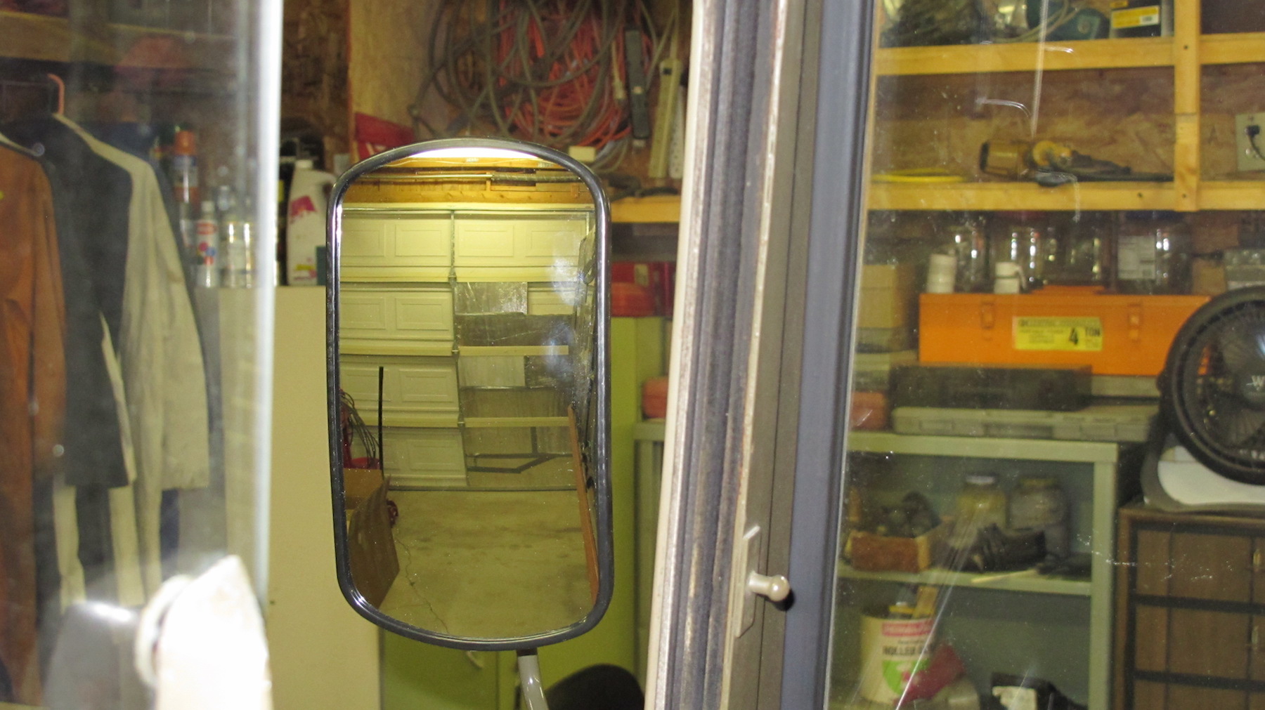

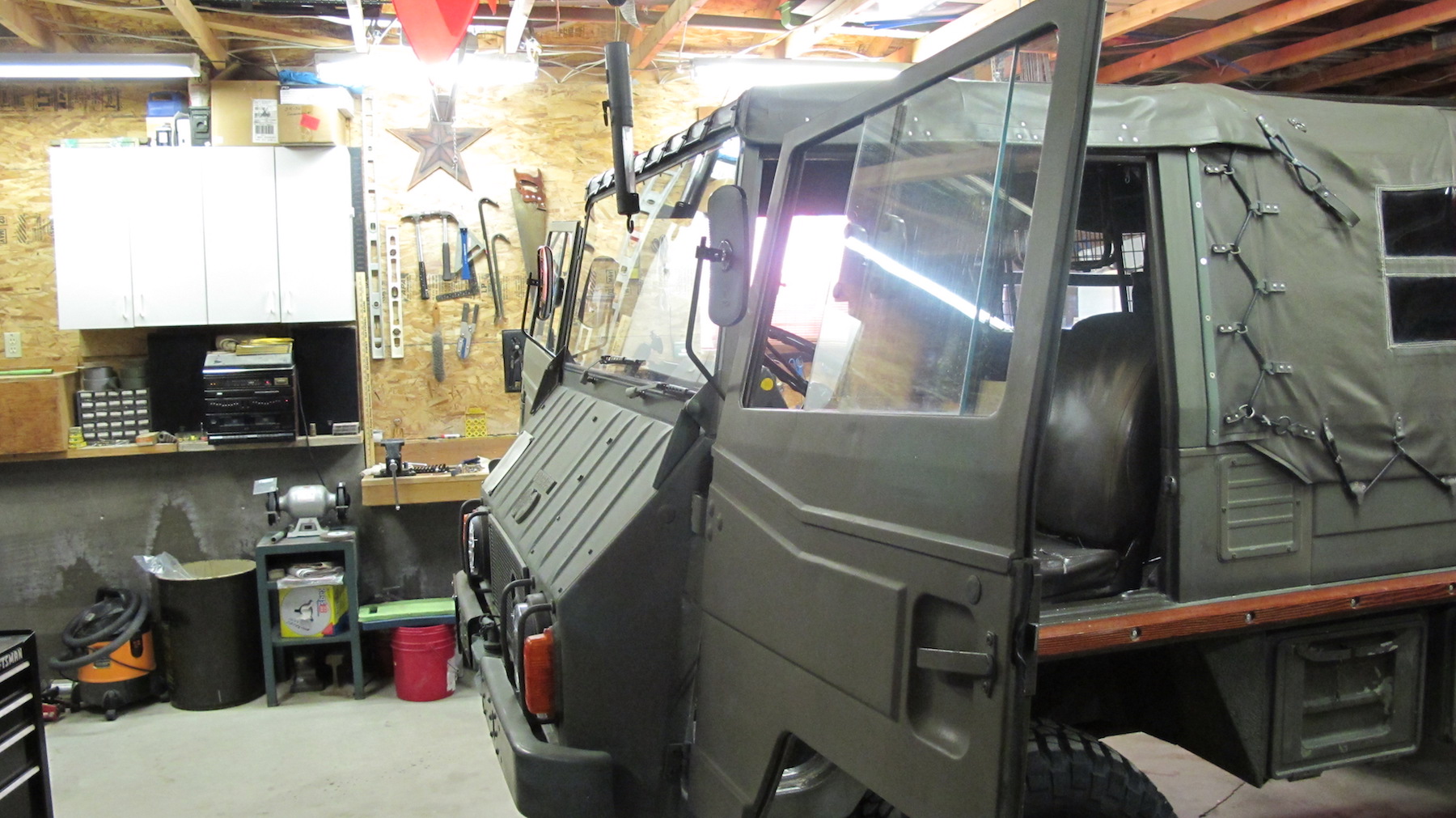

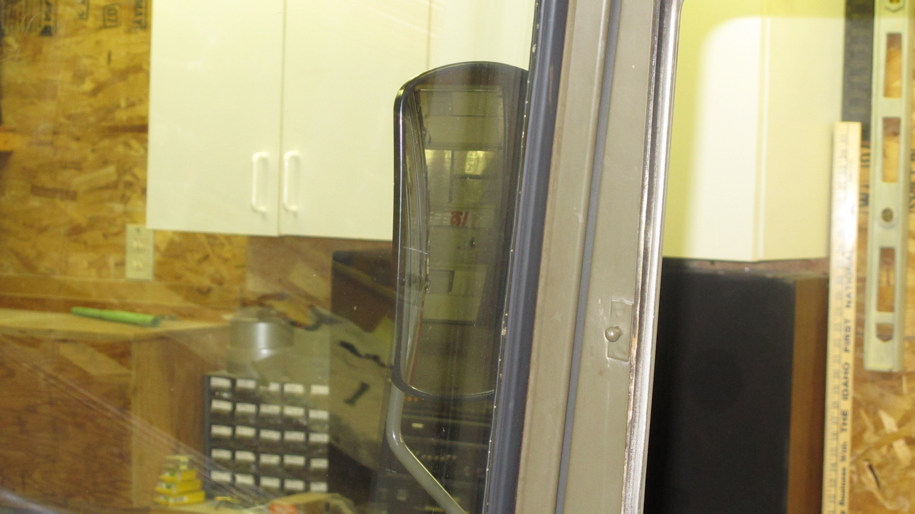

Got the new SAV OEM replacement mirrors painted and installed. With the mirror's slight convex shape, they give an excellent view from top to bottom. I like them.
