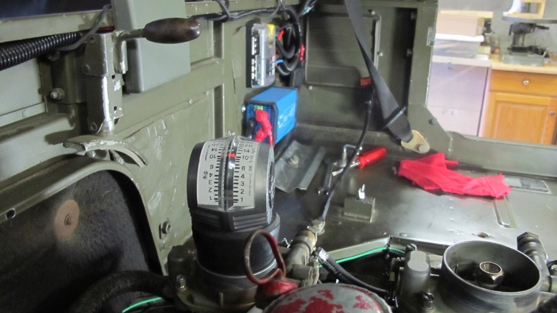

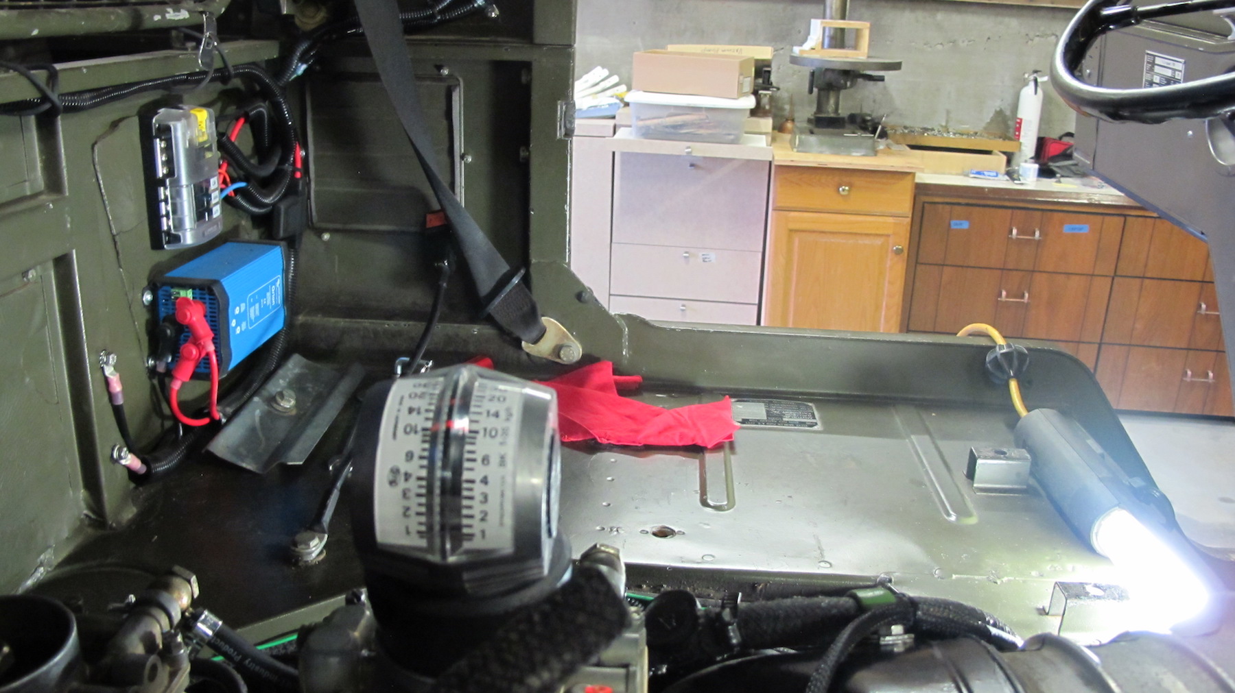

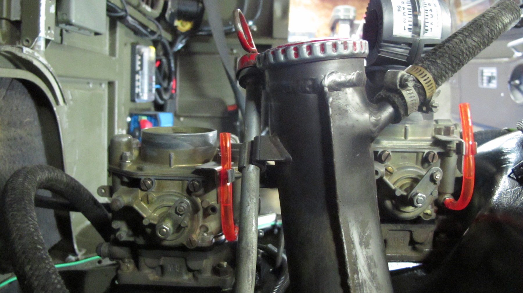

We just completed what we thought was a successful Zenith 36NDIX carburetor rebuild and SAV OEM fuel pump install. As covered in separate threads, we were having fuel in the engine oil, gas dripping in one carb when running and after running, a very high float level in the rear carb, gas smell, exhaust smoke and smell, and power loss on grades.
Since the fuel was drained from all the fuel lines and the SAV OEM pump seemed stiff, we had trouble at first getting fuel for starting. We took the pump off and manually pushed the lever several times, used a vacuum pump to help suck fuel into it, and then it worked.
We've only tested it after the rebuild in the garage so far. But it runs very smooth, both float levels are perfect (two 1 mm washer on each float valve), synchronization is very good at 10 for both carbs. And there is no exhaust smoke or smell.
We've had a lot of help from folks on this forum, thanks so much!

Well, the carbs at idle were great, idle mixture screws 2 turns out and reading 10 on the syncrometer.
But we have a bog down flat hesitation off of idle, like we've seen several threads about. We have to feather the gas pedal to get the rpm's up to move. After that there's plenty of power.
We're going to check vacuum and play with the idle mixture and idle speed like others have done to see if that helps.
We're at 5600 ft elevation now, where for the last 7 years the Pinz has been at 1000 ft. We want to advance the timing a couple of degrees, but we have the PinzSSI system and can't find how to advance the timing with it. Do we turn the distributor shaft like would be done before the PinzSSI?
We noticed that the accelerator pump fuel kind of tumbled out of the nozzles when we pressed the gas pedal, which seems unusual since our other old carburetors have a strong stream. The SAV kit didn't come with a new pump upstroke or pump pressure valve so we used the old ones. The check balls in them rattled freely. So we're wondering if the check balls aren't functioning correctly to make the accelerator pump provide a strong fuel stream. Could these two valves be bad? I just ordered new valves just in case. Or is the tumbling stream normal for these carburetors?
Any help on the timing adjustment method with the PinzSSI and the accelerator pump questions will be appreciated.
