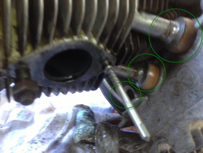

Check the valve cover return pipe seal (501.2.01.016.1) and the 2 push rod seals (501.2.04.016.1) - probably leaking
5-8-2017 10-26-45 AM.jpg (61.24 KiB) Viewed 12349 times

Re: more oil dripping than i would like
TechMOGogy wrote:Check the valve cover return pipe seal (501.2.01.016.1) and the 2 push rod seals (501.2.04.016.1) - probably leaking
Difficult replacement? Does engine need to come out?
If it's the valve cover return - no
If the push rod seals - yes, unless someone else has a way but would be too tight!

As mentioned the push rod seals where they come out of the block - engine out but only because the bodywork prevents moving the barrels/heads far enough out of the way. The thick rubber seals will normally be split so you can see if they are damaged.
Also as mentioned the oil return from the rocker covers - same sort of seals as the push rod seals - same issue, same check - can be replaced but removing the rocker covers. Check the seals of the return pipe on the rocker cover - as well as the rocker cover gaskets.
valve cover gasket on driver side.
Checked the donut seals and they were all in great shape.
Ya know what bothers me... when those who you buy the truck from give you misinformation. The PO stated he had the valve covers replaced. Not a chance! They are old, brittle and leaking.
