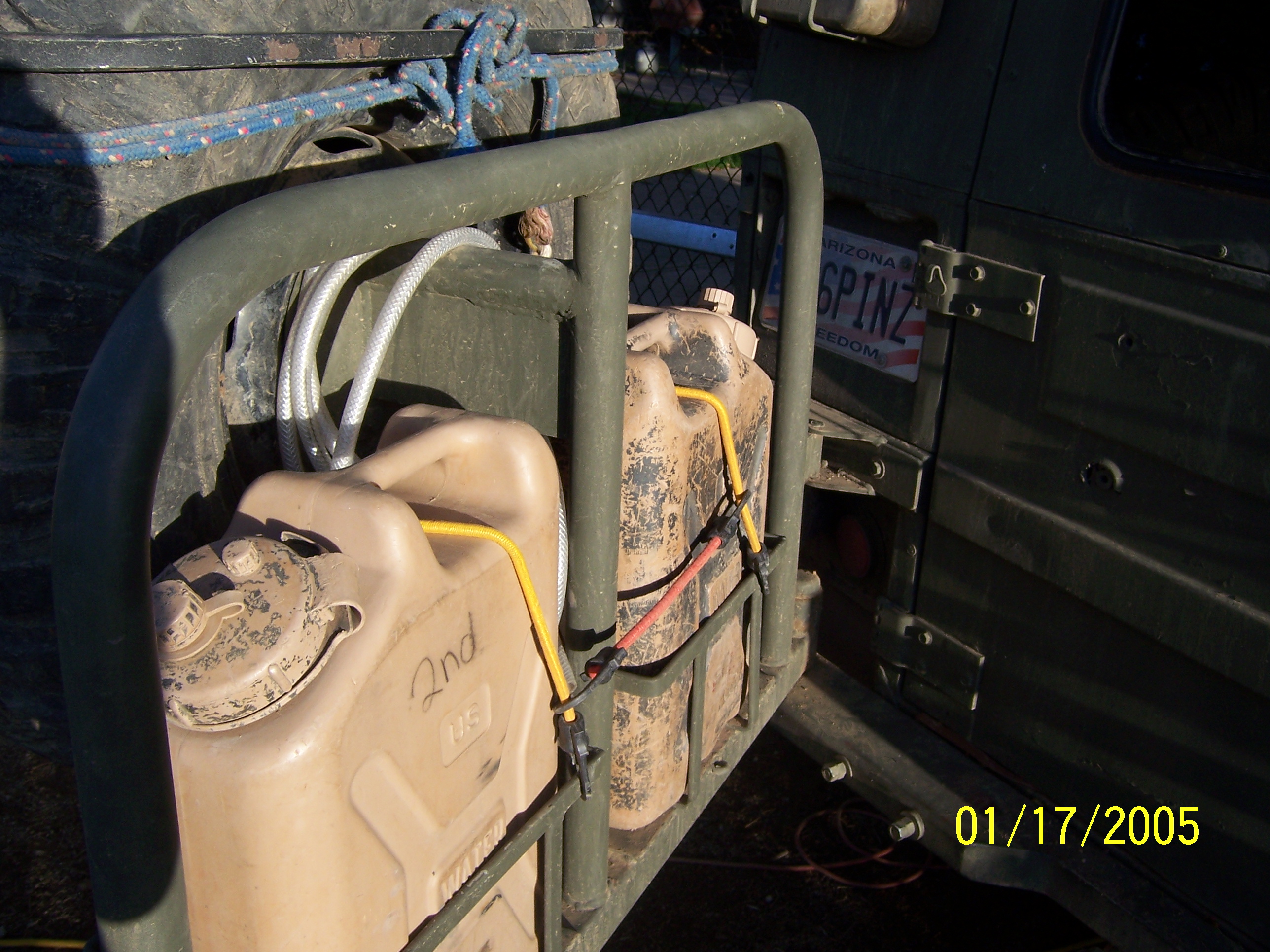

I have been running a dual jerry can and spare tire on a built rear bumper for a long time. On longer adventures I even hang a jerry can on the spare tire. Of course the two main jerry cans are for water (we do live in a desert here) and I have the extended range fuel tank already. I did have to add an additional swing point to stabilize the carrier. It moved too much for my liking and I figured over time it would destroy something. I do use my truck offroad a lot and on trails that are not traveled as much as most.

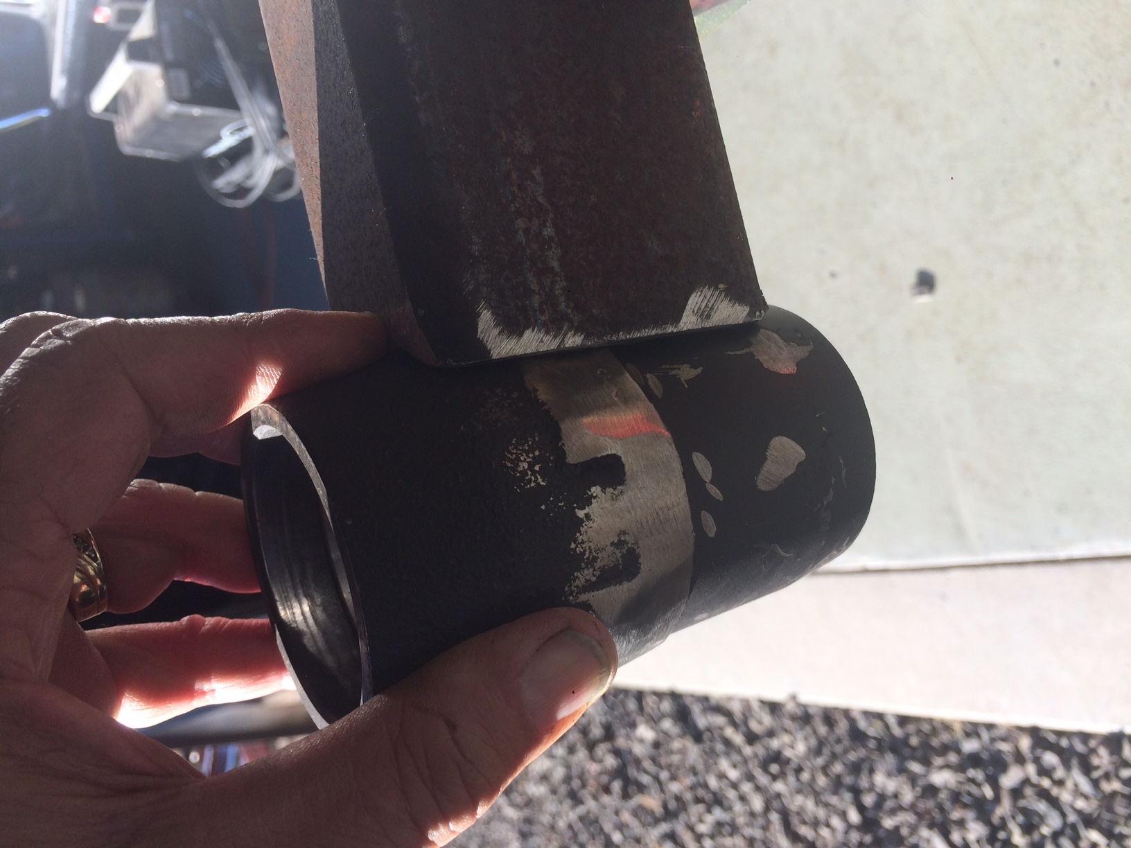

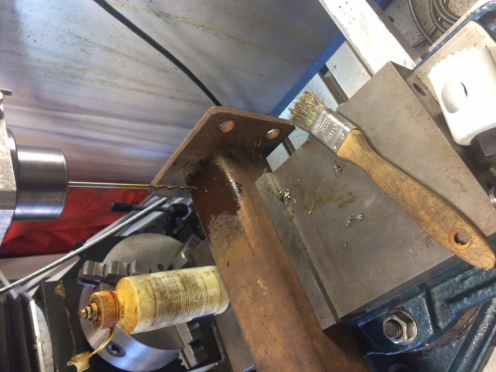

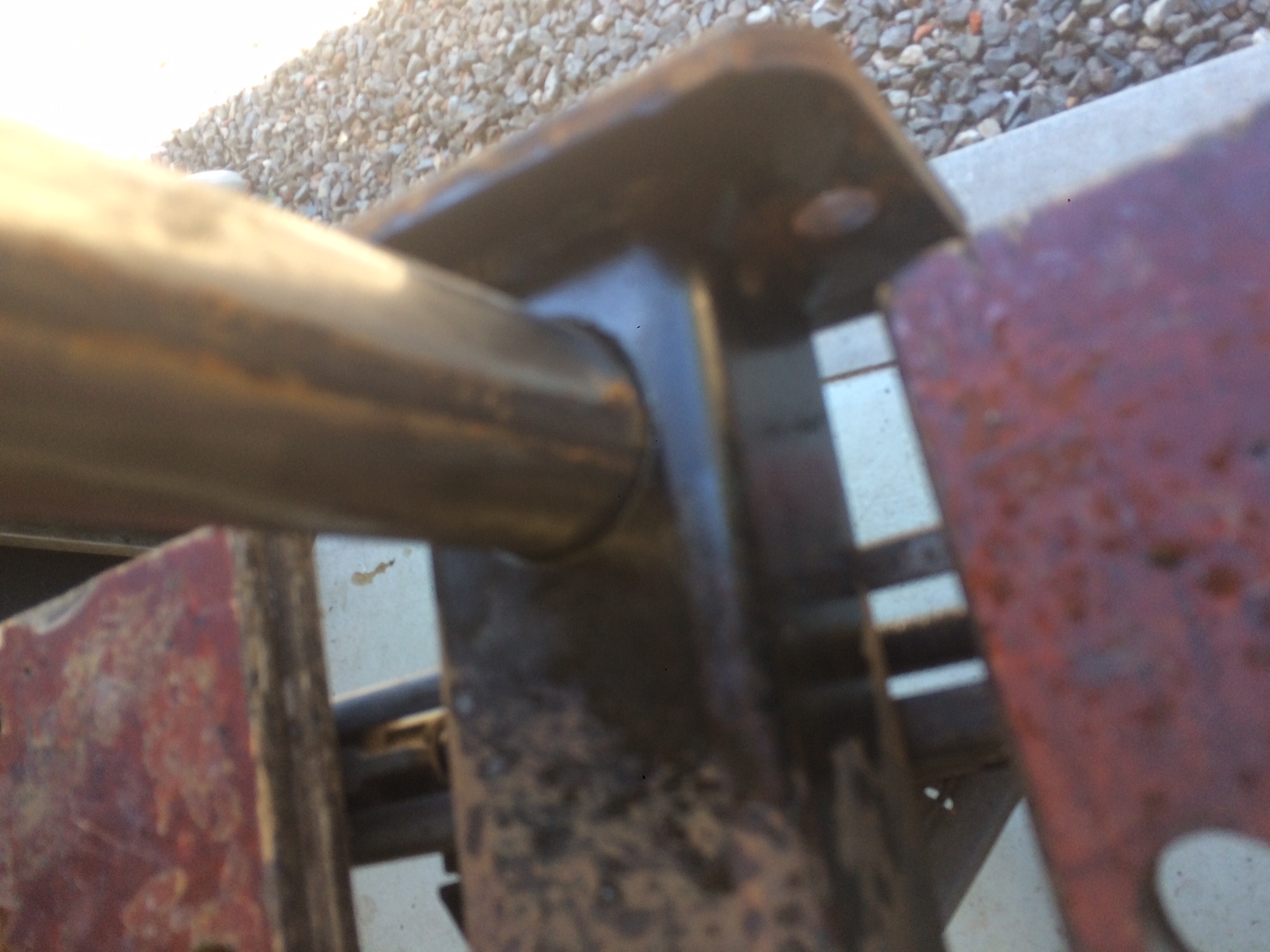

For my next part in process I drilled pilot hole for 1.25 inch hole saw to cut in spindle sleeve. I am using spindle sleeve to eliminate a lot of welding heat on spindle itself which could cause it to crack.]IMG_2449.JPG[/attachment] I will cut the flange off the hub then weld the hub to the actually swinging part of carrier 2x3 box tubing. As usual pics are out of order. More pictures to follow as process comes along. Ran out of time since I wanted to get front brakes adjusted and wheels drilled out for new lug nuts.

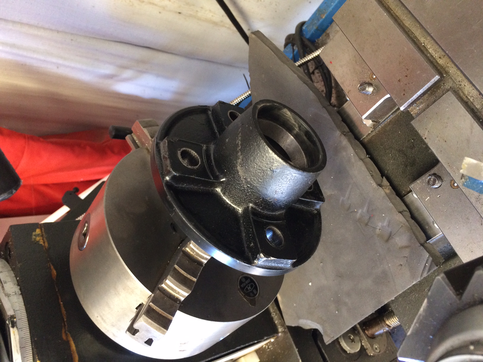

Got the flange removed from the hub and used plasma cutter to cut a half circle in swinging part of carrier that will be welded to the hub.
Got the 1.25 inch holes for mounting the spindal sleeve. Boy, that was some tough old American steel to drill through!

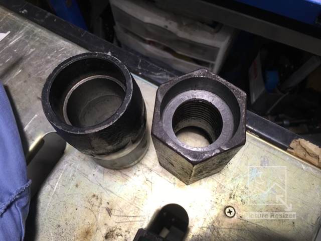

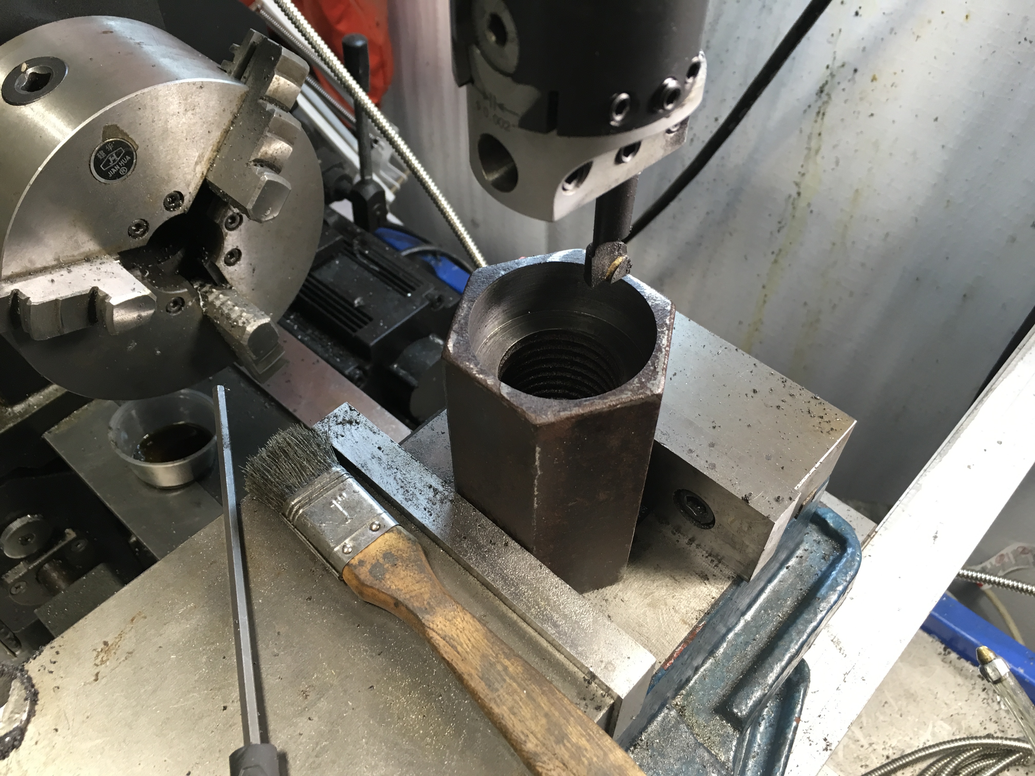

More pictures. Decided not to use cast hub to weld to. Found this giant nut to machine out. I will incorporate the existing tire carrier into new mount.

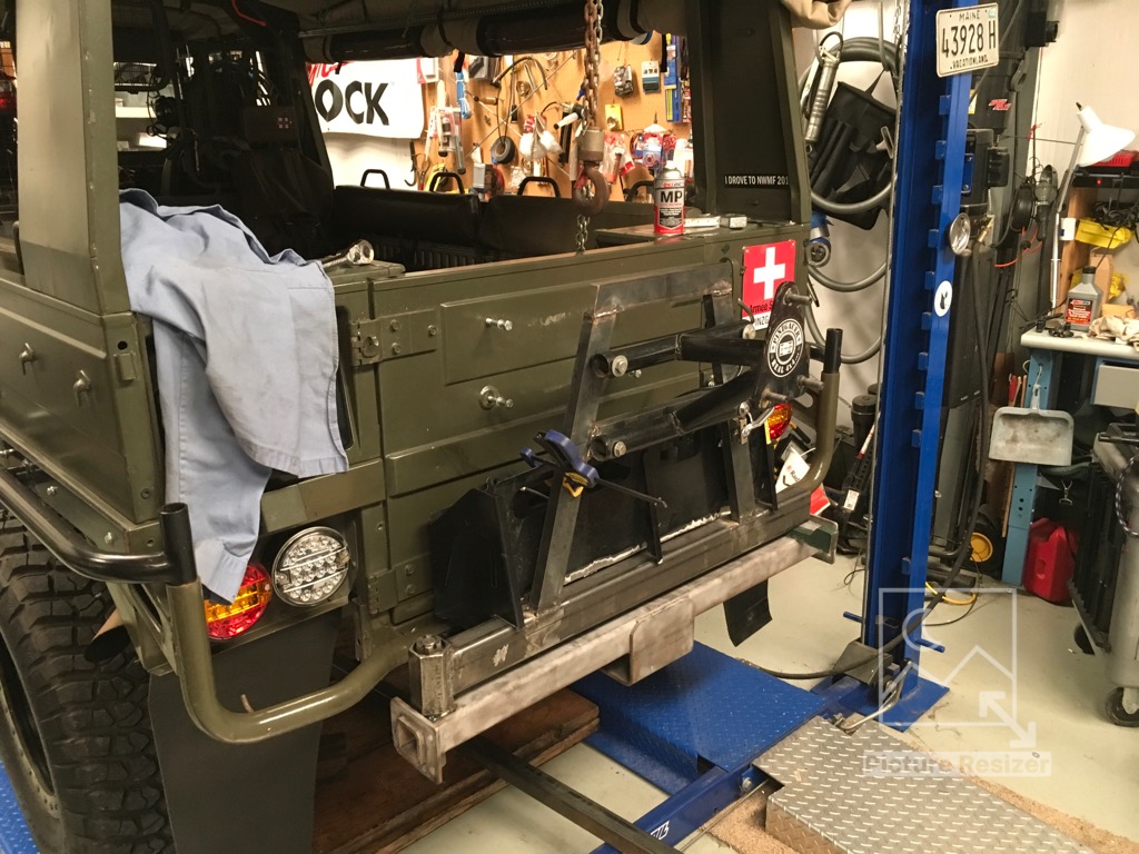

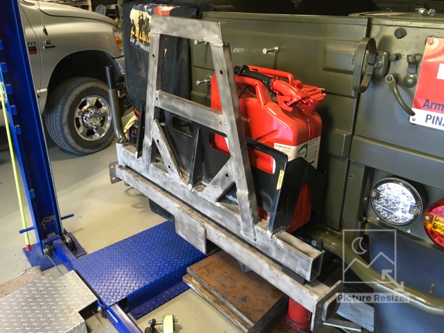

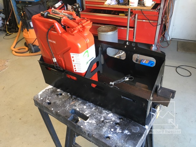

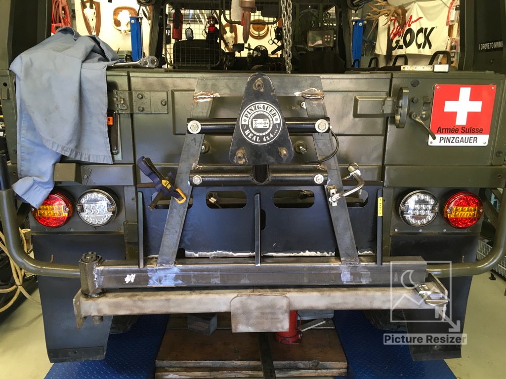

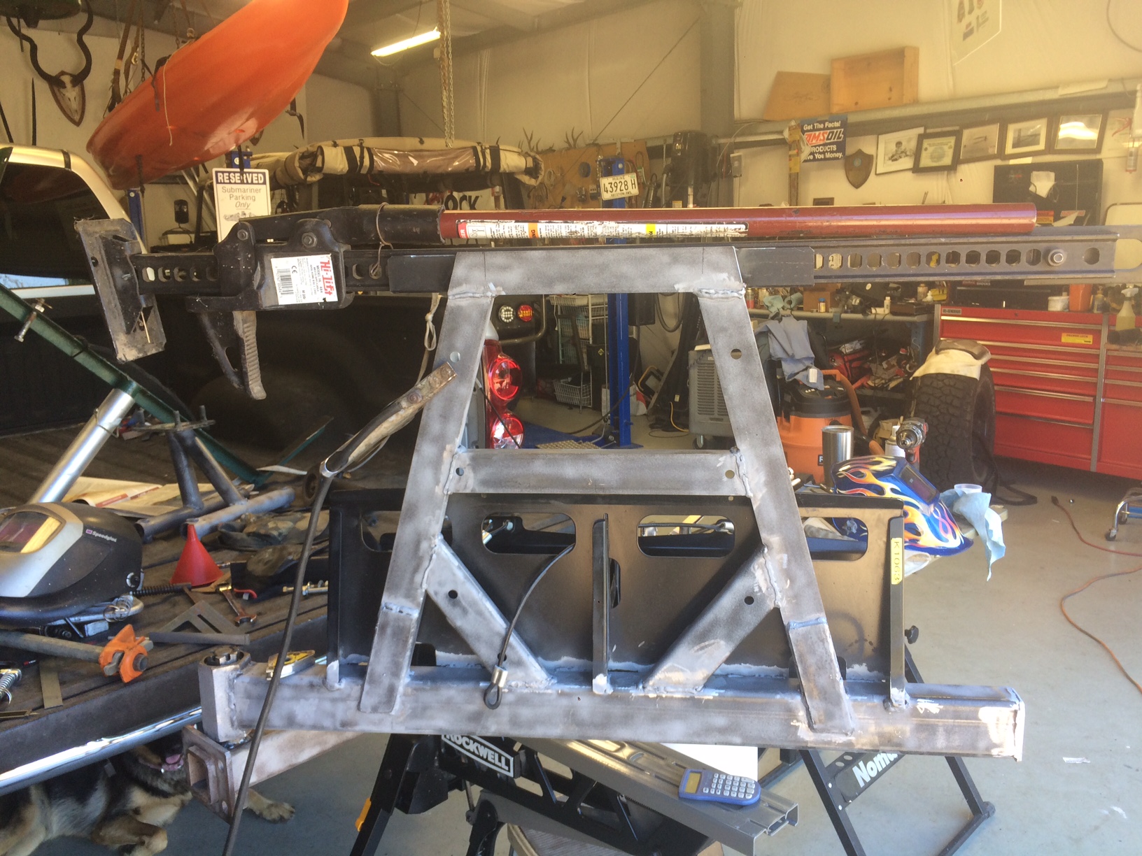

Did some more welding, sandblasting and mocking up highlift jack mount today. Waiting for toggle clamp to arrive so I can finish up welding and get it primed.
Sonarman
Posts: 80
Location: Sonoma, Ca
Re: Laying out tire and jerry can swing carrier.
Post by Sonarman »

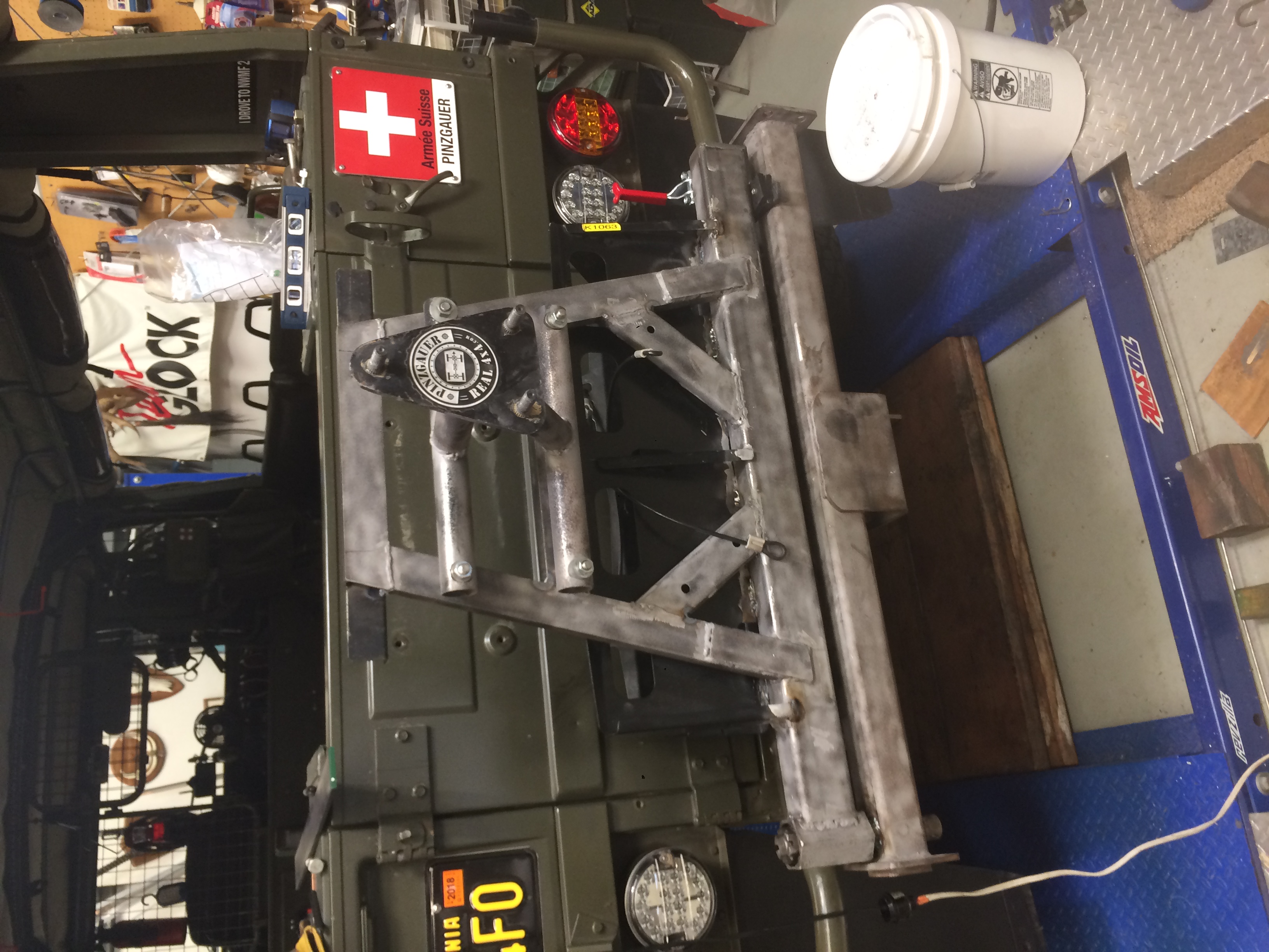

Almost ready for paint.
