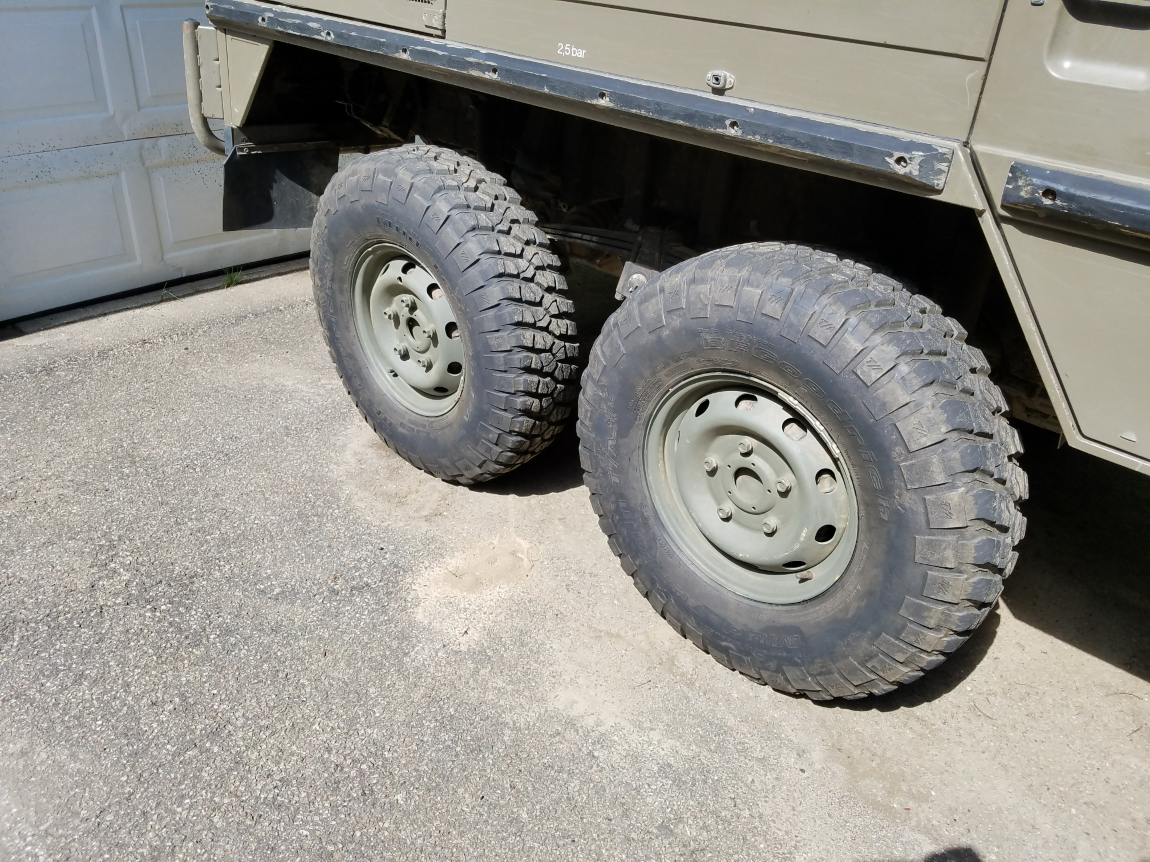

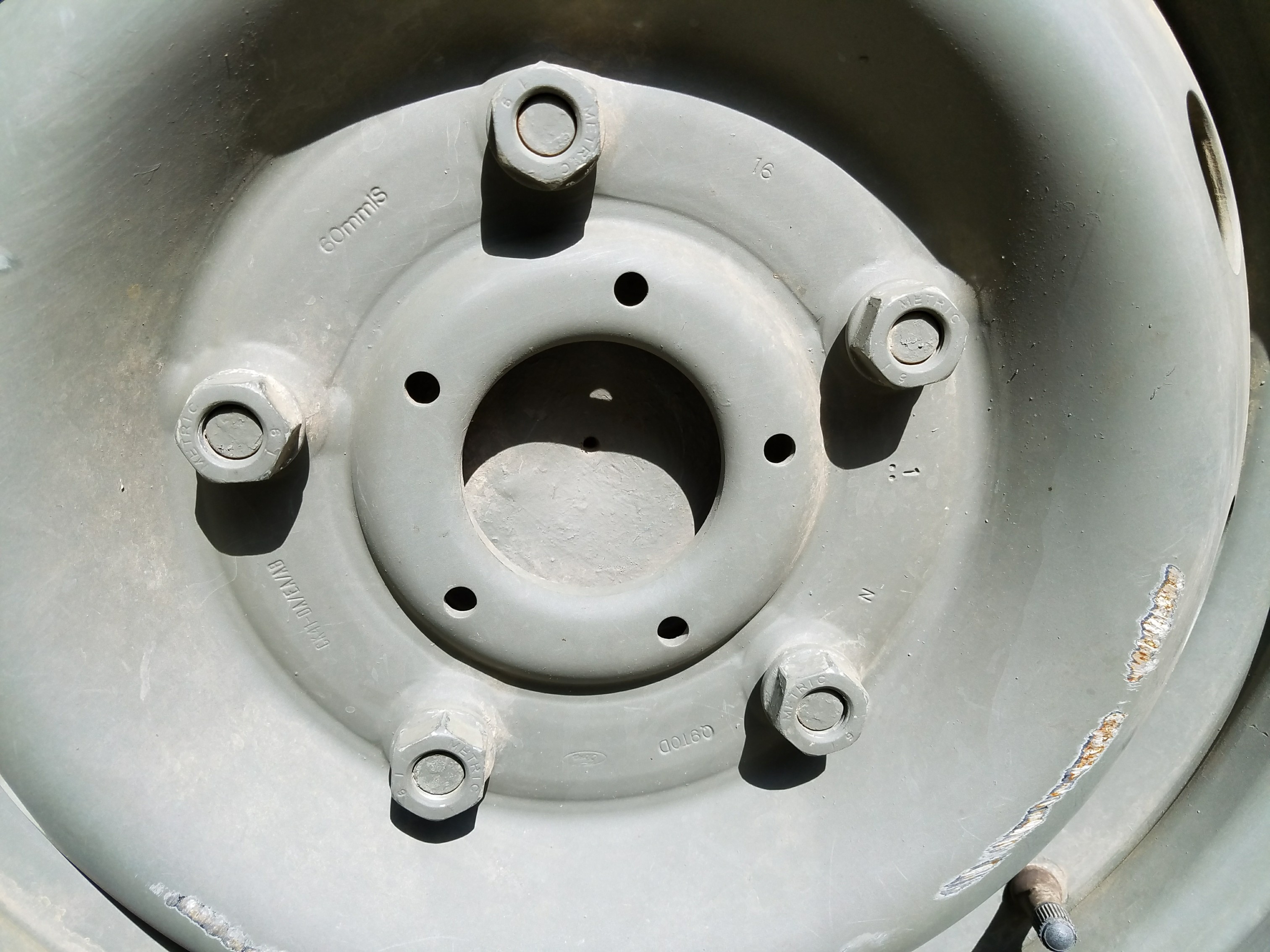

Here are the rims....
You can make out the hole I added to the rim it's just near but below the valve stem.

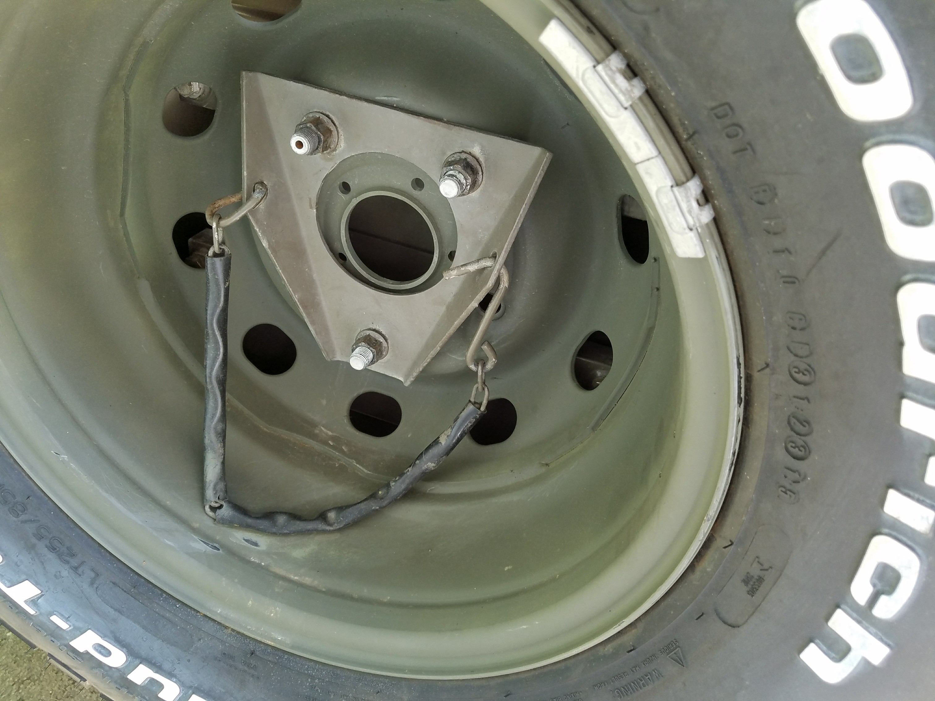

- Had to modify the spare tire carrier... I needed longer studs and I had to get rid of the little lip that supports the tire in the center
- 20170619_154134-3024x2268.jpg (934.06 KiB) Viewed 34569 times
- 20170619_154047-3024x2268.jpg (963.34 KiB) Viewed 34569 times
- The hole by valve stem is the one i added.
- 20170619_154038-4032x3024.jpg (2.35 MiB) Viewed 34569 times
- 20170619_154031-4032x3024.jpg (1.96 MiB) Viewed 34569 times

Can you post a photo from the front along the side to allow viewing of how much they stick out?
I think they have an ET of 60 vs. the stock rim being an ET of 75 - so they should be 15 mm more outward on each side.
They look good in my opinion. Lots on ebay / craigslist too for as low as $75 with free shipping.
The Euro ones I got off ebay.de weighed about the same as the stock rim and I would expect these to as well.
You''ll need new lug nuts but they are easy to get - I picked up them from Costco's tire center as they have a nice variety on hand cheap and you can buy them one at a time.
Re: US Ford transit wheels fit the 712k!!!!!
Just noticed that the back wheel in that photo (the rear most wheel) looks like the lug nuts do not have much thread engagement? Looks like they are different than the other wheel? You can't use the stock "ball seat" lug nuts with the Transit wheels - you need "cone" type.
Doesn't look safe to me!
Brady 712k
- Posts: 49
- Joined: Wed Sep 30, 2015 6:03 pm
- Location: Boston MA
What you're looking at are the stock Ford Transit nuts with the proper 60-degree cone seat. Those nuts are designed to engage with the Hub Cap on the transit which is why it looks like there is not that much engagement if you actually look closely there is no thread on the inside of that part of the nut.
The other lug nuts you see that look different are generic Dornan 60° cone seat nuts they're smaller don't have the provisions for grabbing the hub cap.
You are correct the Pinzgauer ball seats nuts would not sit properly with these wheels that is why they are not being used!

and tomorrow I can get a photo of what it looks like from head on to see the offset difference.
