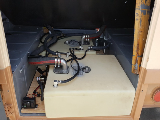

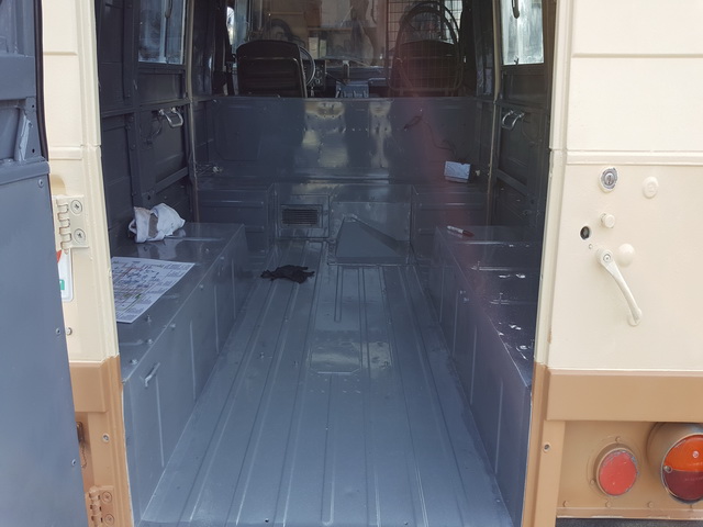

My solution to increase the fuel carrying capacity of the Pinz. (Photos in reverse order...)
Photo 1: Rear of the truck after the insides were sandblasted and coated with POR-15
Photo 2: Two marine, below deck approved, fuel storage tanks with integrated gauges, vents, etc. The Facet fuel pump picks up from both tanks via a selector valve. The switches in the photo is for the tank selector, a master OFF, and pump ON. Combined capacity 80L.

Back door closes tight to the plate, and the tanks butt up tight against the front tool box/seats. The nice level loading area is now a bonus!

I forgot to mention - vent lines are routed out the back left of the truck, through the grommet next to the number plate. Lines are fitted with roll-over valves. Hoses are high pressure, either Oetinger clamped, or double clamped. I pressure tested the system via the vent line before installing the roll-over valve. No leaking or venting inside the truck at 3 atm.
