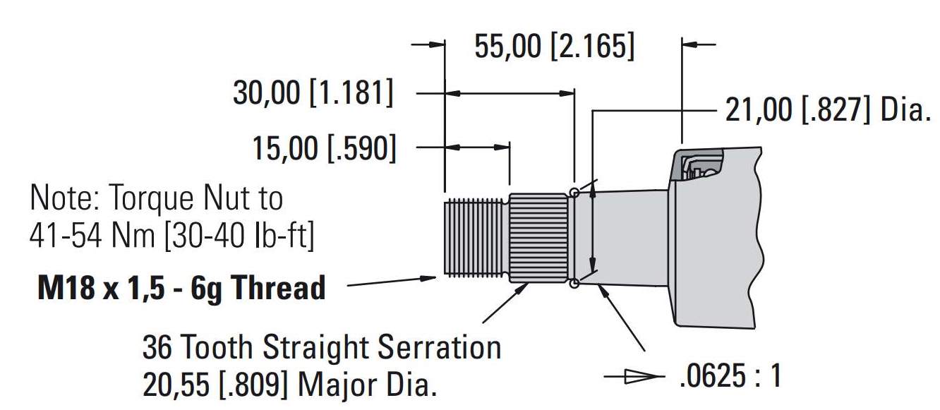

I believe I've found a tractor which has the same steering column shaft as the 710/712 Pinzgauers - here is the drawing which I compared to the original:
Pinz Compatible Steering Shaft.jpg (63.75 KiB) Viewed 10559 times
All of the dimensions appear to be an exact match - even the metric nut and taper on the shaft.

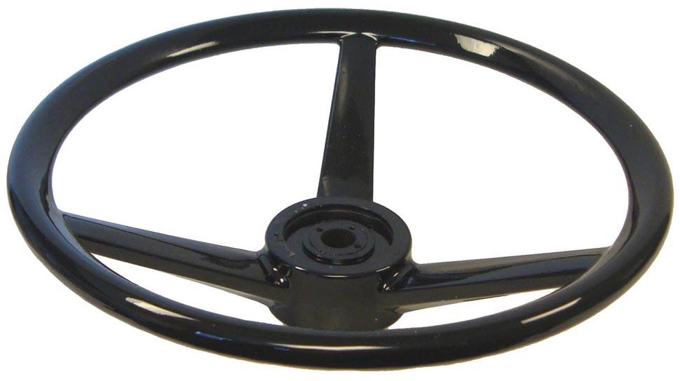

There are new 15 inch diameter steering wheel available for this model of tractor which are about $75 online - here is a photo of it:
Pinz alternate 15 inch wheel.jpg (71.48 KiB) Viewed 10559 times
I will be ordering one to see if it actually works and will then let everyone know the model numbers etc.
There is a nice chrome center cap also - but it doesn't include a horn switch. Will need to figure that out still...

Well - the steering wheel I ordered doesn't quite fit - the splines are the same but the diameter is slightly larger so the wheel can just spin slightly.
Nobody I've asked can find one that works - even though the steering column shaft is identical to one that the USA manufacturer EATON / Char-Lynn offers with the code of "PT" in the part number - which is where that drawing is from. They seem to offer 4 different ends on the shafts though - and this one apparently isn't popular.
I did see that on Expedition-Imports site it says that the steering wheel used on the FLU419 SEE Unimogs fits the Pinzgauer - and they have a large one with thicker rubberized outer ring available:
https://expedition-imports.com/4064600203
MB Part Number: 4064600203
The listing does say there is a smaller version also used on the FLU419 SEE tractors???
