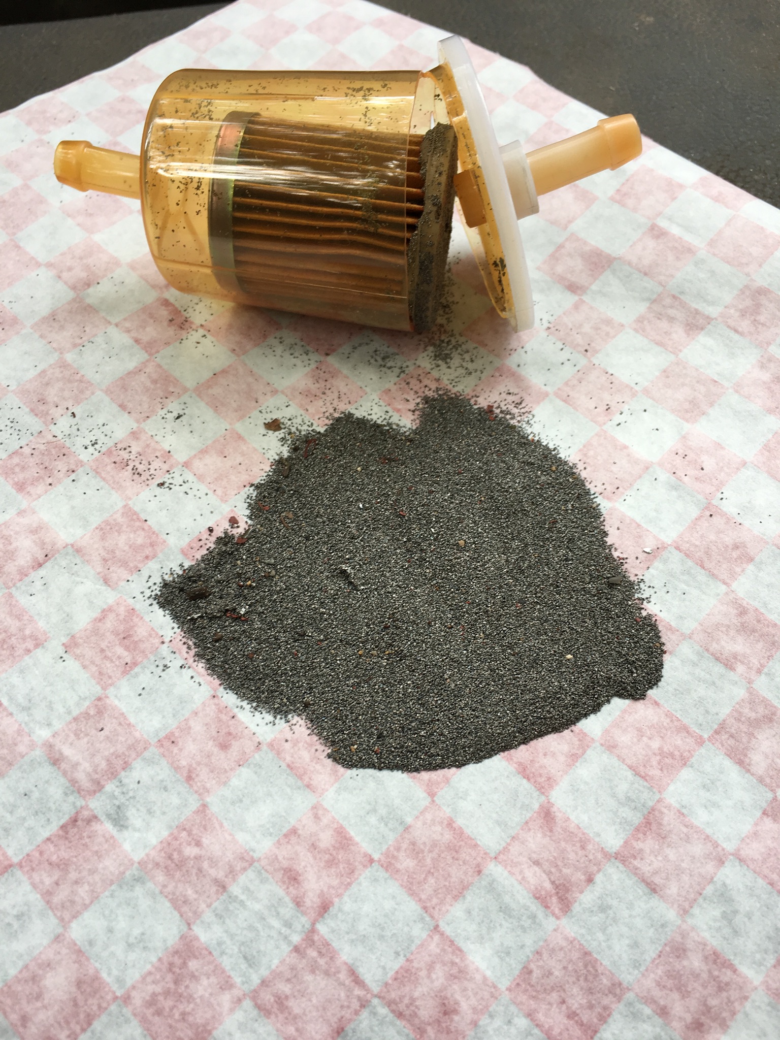

Why did my Pinz have fuel delivery issues
Engine troubles? Try here.
Hmmm I wonder (and yes that is metal)
Pre filter was packed :)

Looks like it's time for a locking gas cap. :shock:

Beautiful. Nothing like having a problem and finding such an obvious, cheap and easy solution.

Question is where did the metal bits come from?
Looks like materiel from a fine tooth cutting blade,
might want to see if it is magnetic. or SS material.
IMHO I'd pull your tank plug and and flush the heck
out of your tank :wink:

Since it is getting cold... plan is to drop the tank and get it cleaned and relined in the Spring so it is good for another 40+ years :)

After the EFI conversion, my 712 ran like a top... until one fill up at the wrong gas station.
I had a similar amount of metal debris problems in the filters. I won't forget poor Andre in a cold
Western Washington barn rebuilding a fuel system in January!
Re: Why did my Pinz have fuel delivery issues
totaljoint wrote:After the EFI conversion, my 712 ran like a top... until one fill up at the wrong gas station.
Sounds familiar and my new injectors just arrived today
Waiting for 1 more filter to arrive and then hopefully this weekend, in 32 degree weather, I will be recreating your experience

As I recall, flushing out the gas tank and all it's baffles took the most time, yielded the most particulates and we then put some neodynium magnets int he tank
to catch anything we couldn't see or flush-- and for future bad gas contamination possibilities.
A cheaper Harbor Freight flexible fiber optic scope helped a great deal in inspecting the tank,
but in the end the plastic camera end of it didn't survive the prolonged immersion in gas.
I recommend the magnets. Lets see if Andre concurs....
If you and I had metal shavings in gas, wonder how many other have had it?
My bad gas came from a "no ethanol" gas pump.
