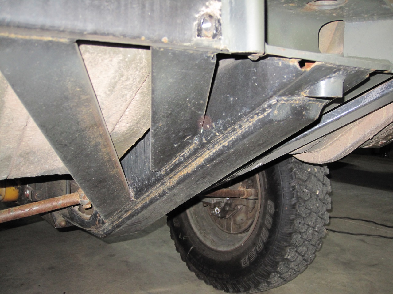

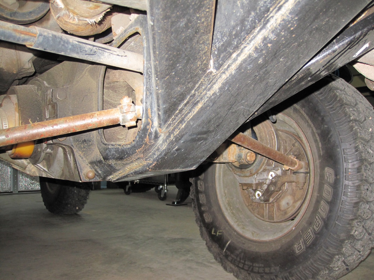

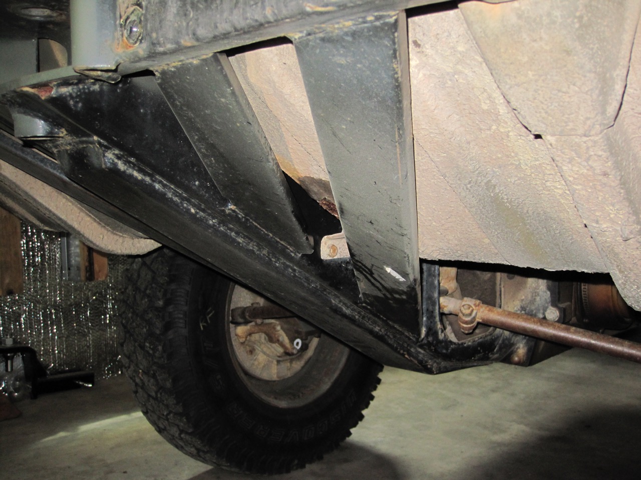

Here are a few photos of a 710M I owned a few years ago that had some extra bracing welded to the front undercarraige. I don't know the purpose other than that it had a winch mounted on the front.

pcolette shows some great pictures of bracing welded onto the front bumper. I've read a couple of times trawling through the forum that you shouldn't weld between the chassis and the bumper as the bumper is mounted to the body and it increases vibrations and noise. Does that sound right to you guys?
What about the idea of using the outriggers on the chassis tube as braces? I'll take a photo if that makes no sense.

To are correct one should not well past the body mounts. In the bracing of the front for the winches the braces should go to the tubing on the front and not the body or bumpers.
Don't know if I would support off the body mounting outriggers. Would not want to risk damaging body mounting points. I know some tie their trucks down using them. Just don't know what long term use would do to them.
The snow plow mounts have been proven to work with minimal damage to the truck so that is the direction I would go.
