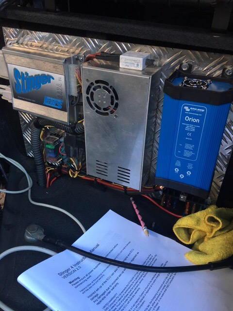

Re: 12v power source for electric steering
I have 2 60 amp converters with 2 12v fuse blocks as both my EFI and power steering use 12v.
The idea was to always be able to power the EFI
No clue about the charger, I just did what Jim L needed for EFI and what EZ and EI recommended for the electric PS.
I highly recommend Orion
