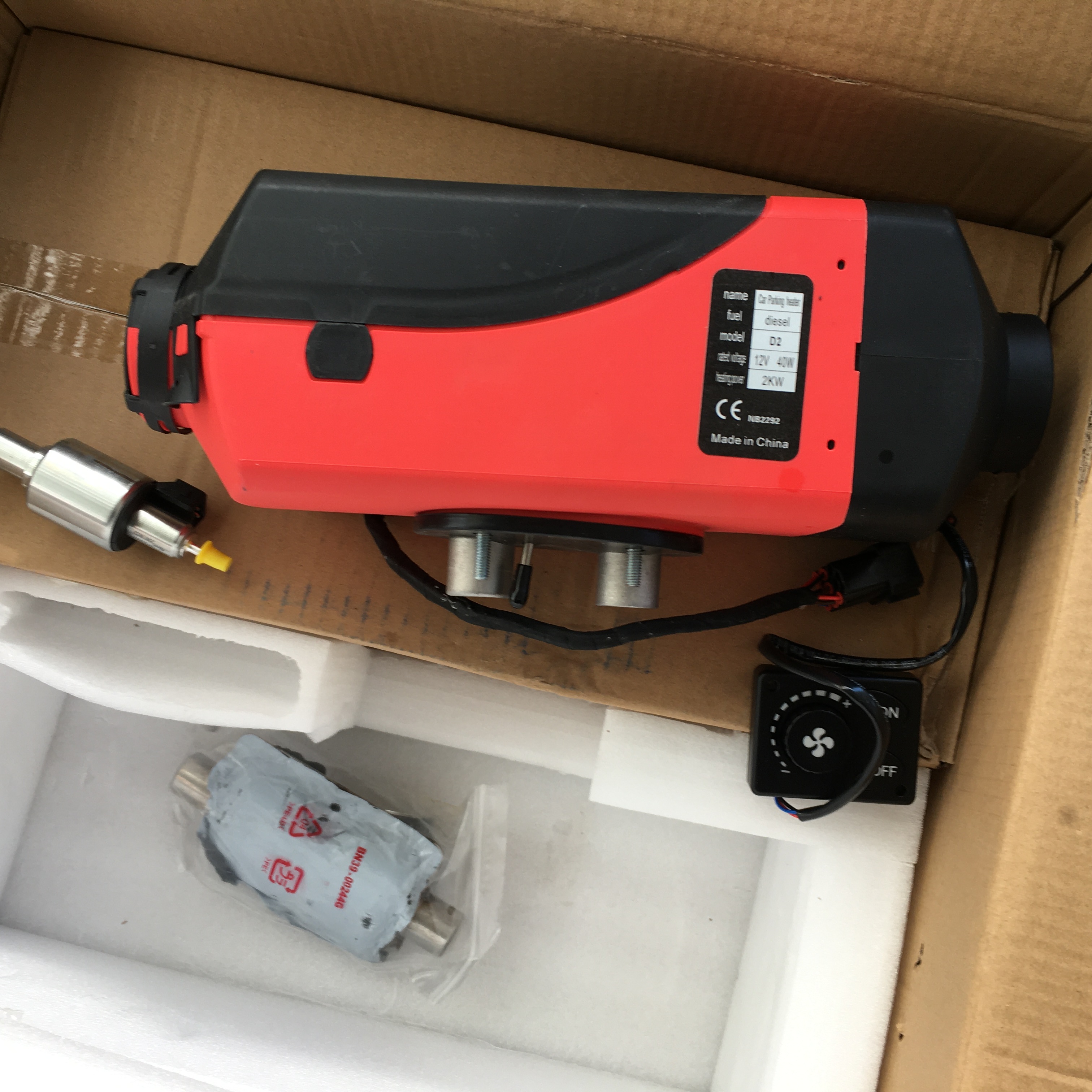

I've spent an unhealthy amount of time researching these things since that post. Being an anti-china product person, when practical, this was an odd thing for me to get into this deep but it's based on simple economics. I could likely never afford a $1000 heater so I'm looking at either, no heat, or a cheap heater that may have cheap fixes to deal with, or may not!
After reading probably the majority of all the reviews out there, as well as endless forum threads on other sites, as well as the exhausting facebook pages dedicated to these, I decided to get one! I never once came across any information about one of these leaking gasses into a cab or hurting anyone and there are 1000's in use out there from 4x4 campers to OTR truckers. I will still install a Carbon Monoxide detector inside, as I would with any fuel heater.
I was careful with my selection and got it from a US seller, and selected the smaller 2kw unit as I don't think the 5kw is needed unless you are in super cold climates or have a cab bigger than a 710K. I also wanted the more simple rotary knob model. The LCD control version seems to have issues but there are aftermarket updates you can buy that are nice, just makes it more expensive. Basically you only need the LCD to modify the settings, like if you park in high altitudes often, you can make the fuel mixture fit the environment.
I planned the install over time and well in advance, reading all the advice out there. It went well and didn't take long. I modified the kit in key areas after identifying known weaknesses:
1- I bought a better fuel filter. There are Espar units and others made for small engines. I think I got one for chainsaws from my local parts store.
2- I upgraded the rubber fuel hose portion of the fuel line to USA-made hose.
3- I upgraded the power supply wiring to 10g.
4- I made sure to keep the hard fuel line as short as possible and that it mated right up against the pump and heater inlet. **This is key!**
5- I changed the fuel tank to fit my mounting needs. There are several available out there. I went with a smaller one that fits what I do better as well. I also made sure it's higher up than my pump.
It fired right up and runs perfectly. It blows some nice hot air. In fact I can't imagine needing it running over night unless its really cold/windy so I'll probably heat the cab up just before sleeping and maybe fire it up in the morning to help with the morning chills. Keep in mind that I have a very well insulated cab so a soft top Pinz is a whole other thing.
I have zero fears of anything leaking into the cab as they just aren't designed in a way where that could happen without lots of failures. The insides are basically identical to the German ones with the combustion chamber being sealed and fully separated from the air blower section. I'd be happy to share what i learned if there are questions. Oh and I paid a total of $125!!

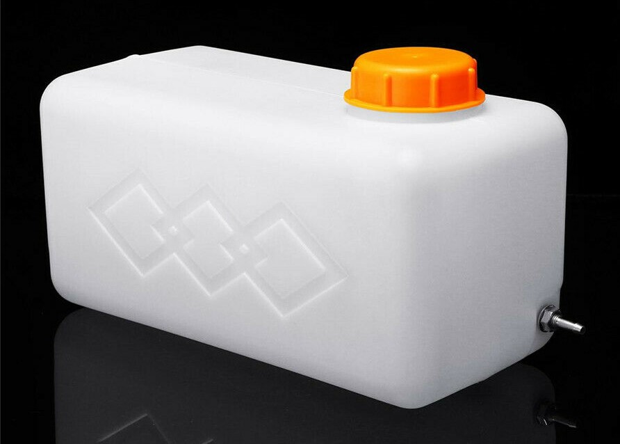

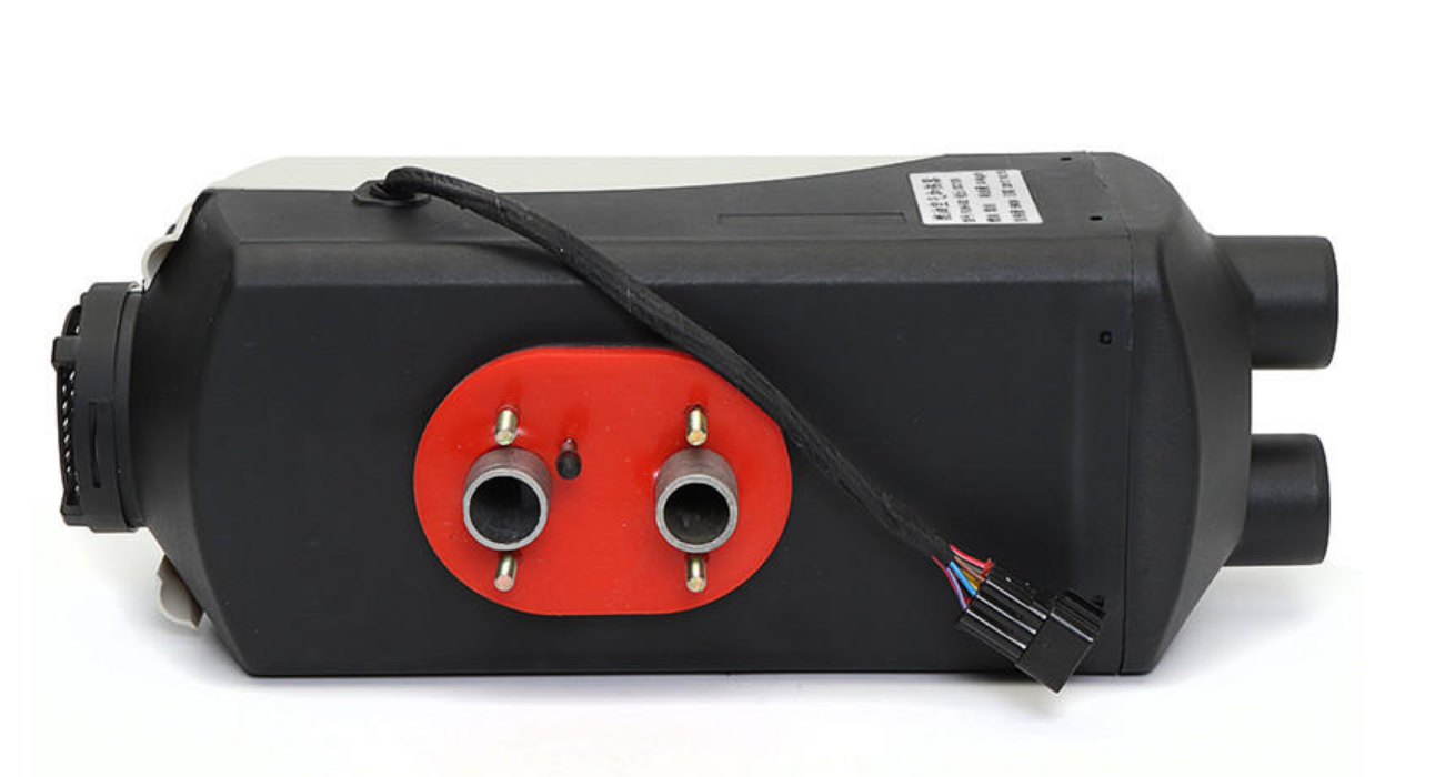

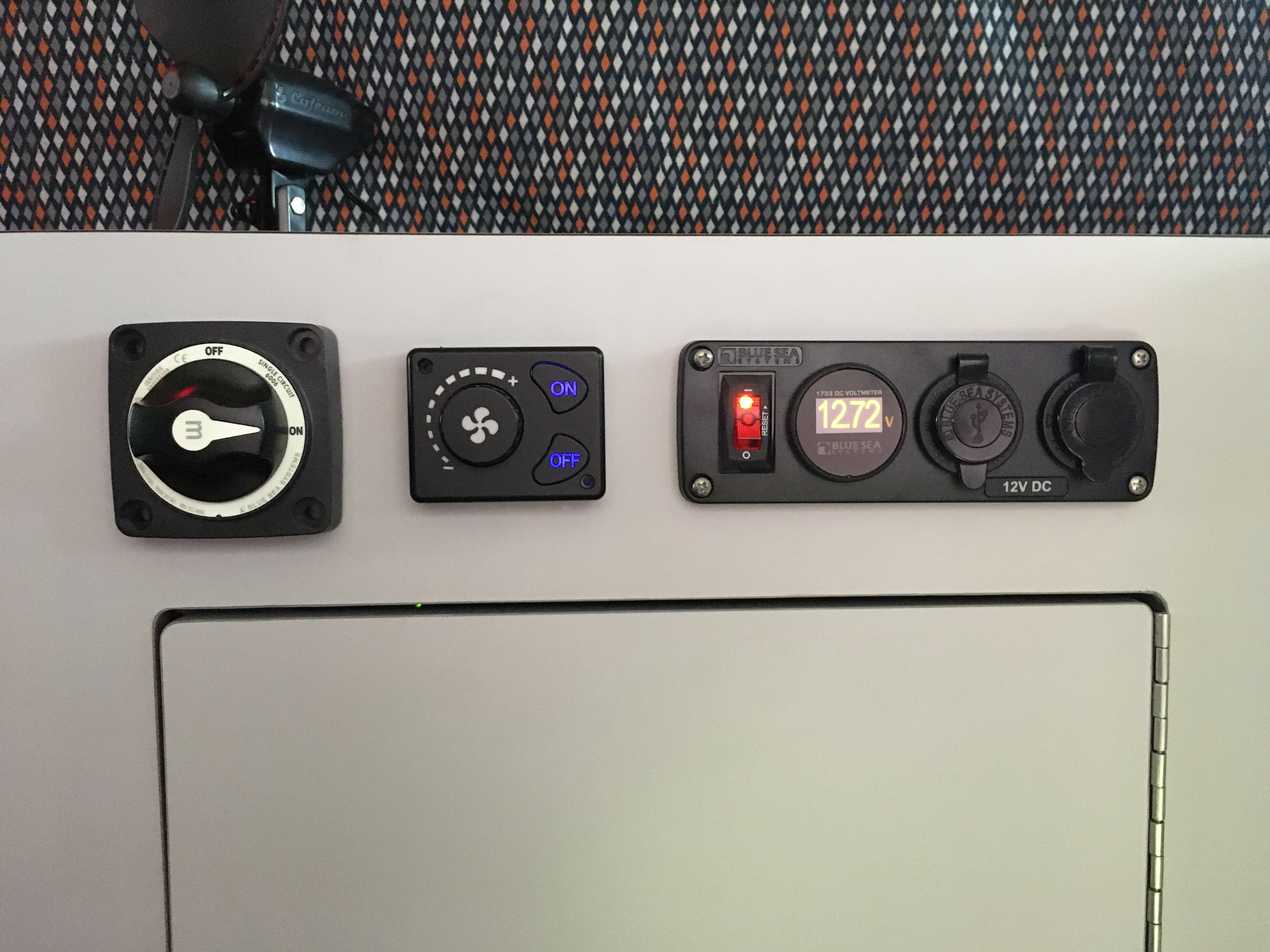

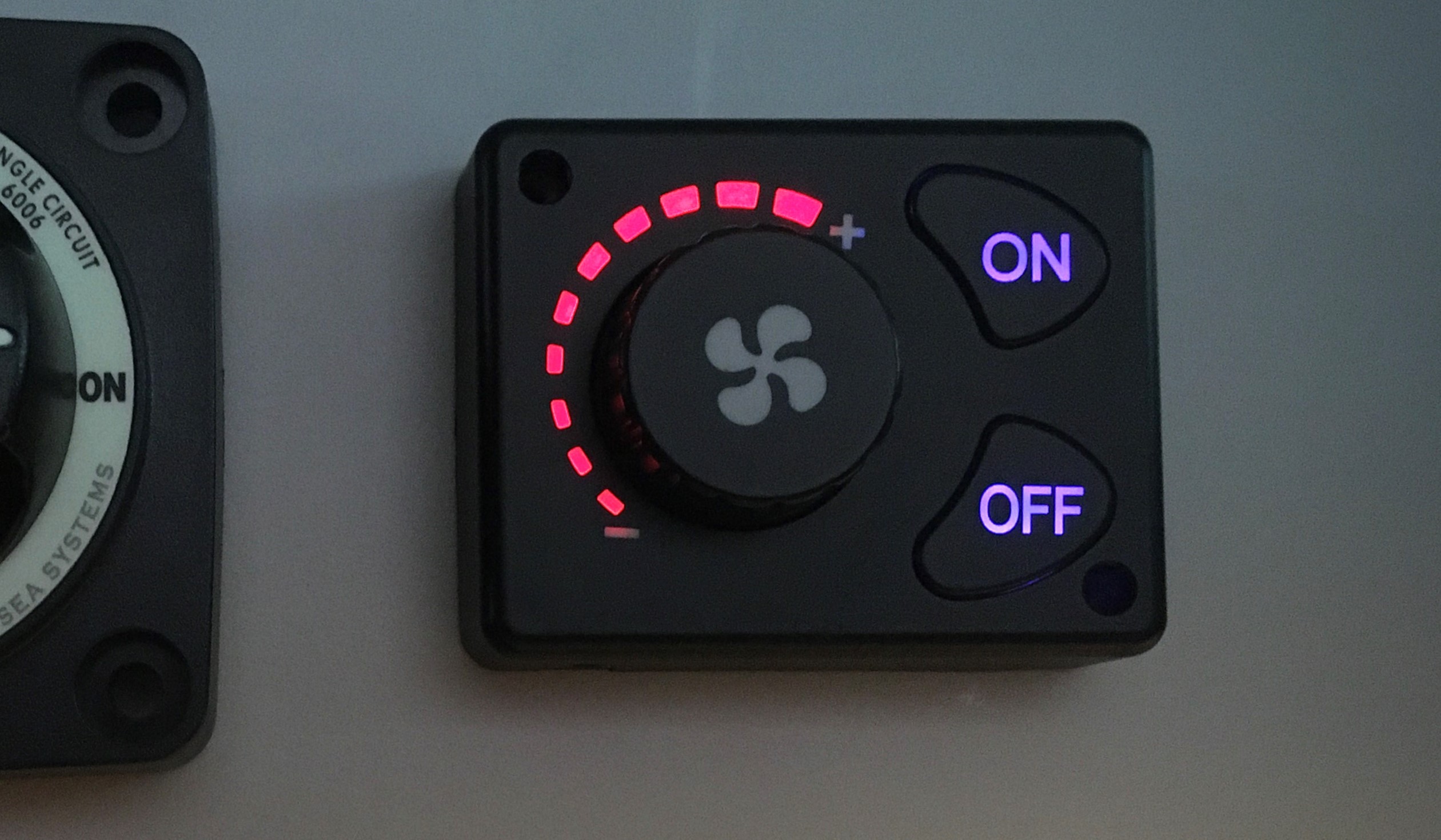

Well I didn't take photos during install and this is going into a little different type of 4x4 but the install basics are the same. I'll get a pic from the underside of the heater soon. This is the main cabinet I'm just now finishing up in the back that houses the house-battery and controls - master camper/house battery switch, USB charger and battery gauge panel. That's the rotary heater control option. One problem with the basic LCD heater option is how bright the panel is. The back-lighting doesn't turn off so that's a big issue for sleeping. I have also read about reliability issues with them overall. The rotary has a subtle back-light to the buttons and is bluntly simple. I used a 20amp fuse on the heater (with the 10gauge wire upgrade).
I also changed to a smaller 5.5L fuel tank which is plenty for how I use it. You can get them for $15-20. It fits in lots more places than the larger ones they come with. If you have a diesel Pinz you could tap into the main fuel line instead of having a tank.
Garry I have read some reports of sooting up if the heater isn't allowed to really burn hot for a while. That's an important thing to consider when picking a size. It's better to run a 2kw a lot, than a 5kw for a short while and have to turn it off. These heaters don't have a super low or "warm" setting unfortunately. It's either burning fuel or not.

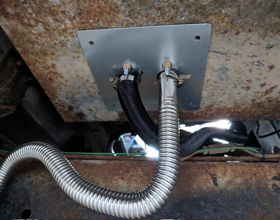

I found this pic of the underside of an install on a LRover but its all mostly the same. The heaters come with a piece you can use as a template for the holes. In this pic he doesn't have the fuel line hooked up yet. You can barely see it there with a cap over the end.
