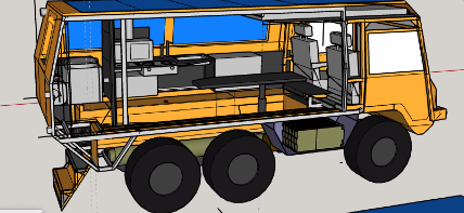

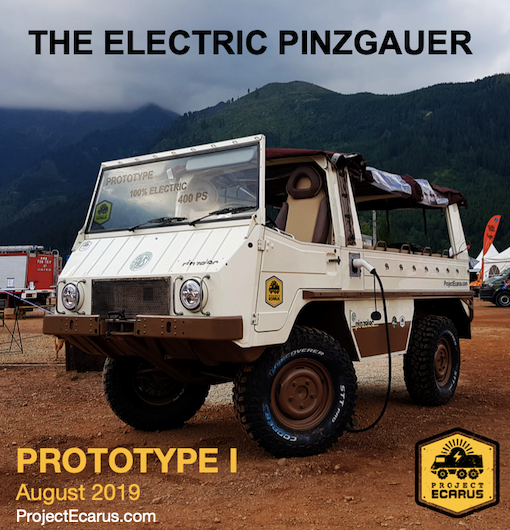

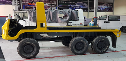

I'm attaching pics of the test vehicle and some working designs and will keep this thread updated as progress continues. For more regular updates, you can check out our website at www.projectecarus.com and/or subscribe to our newsletter here: https://projectecarus.com/signup.
That's it for now, more to come. Please let us know what you think of Project Ecarus.
All the best,
Lisa & Hannes
PS: Please note that there are two vehicles on the pics – there's ECARUS, our yellow 712 (6x6), and there is a 710 (4x4), the test vehicle, used to configure the electric motor, battery and management system. This helps us make sure the kit will work seamlessly as a "plug and play" system in other Pinzis and also allows us to work on ECARUS' expedition shelter and foldable solar system while Francois works on the electric drive.

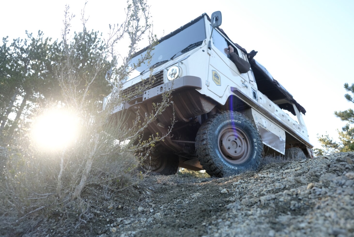

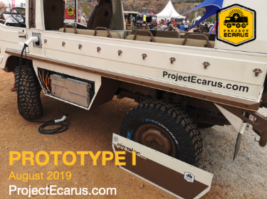

Hi guys, we have more updates about our project. We've been testing the prototype, both on and beyond the tarmac, and we're glad to report that it thoroughly exceeds expectations. Lots of fun to play around in the rugged landscape around the workshop with a Pinzgauer that has >1000 Nm of torque, >400 horsepower and a lower centre of gravity (due to the weight of the 85 kWh battery pack). I've attached a few pictures. We've also put together a short video about our experiences so far, which you can check out here: www.projectecarus.com/blog

Posts: 1558
Re: Building a solar-powered off-road truck (based on a 712M Pinzgauer)

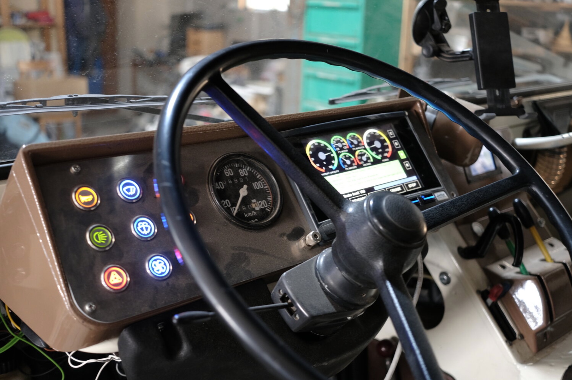

Love that dashboard :mrgreen:
Curious about the driveline mod's made.
Looks like you have eliminated the stock tranie and driving into the X-case with
the electric motor(s) ? OR is there another gear reduction in there? If not do you
find it difficult to control the applied torque -- without the tranie your running
over 5X higher gearing obviously.
At 1000Nm that's one beast of a motor or are you running two or more on the same shaft.

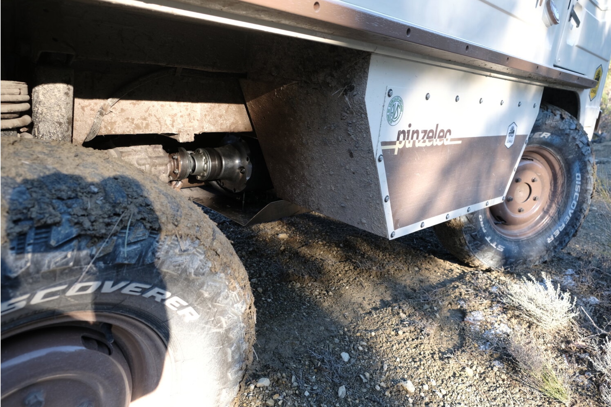

How about a few PIX's of what's under the dog house now ://
Project Ecarus
Austria
Posts: 9
Joined: Wed Apr 10, 2019 2:44 pm
Post by Project Ecarus »
Hey - yes well spotted, we removed the tranie and connect the electric driveline directly to the X-case. It's a modified Tesla Model X motor with a 1:2 reduction bolted on at the end that connects with a short custom trans shaft you see in the image (So to be precise, we have 1320Nm torque (=660NM motor x2) at the transfer case (compared to the 712 Pinz original 960Nm at the same spot (=180Nm motor x5.33 in 1st gear).
We spent a lot of time tuning how we apply the torque from zero, and it works very well now to control the Torque on hill ascent/descent etc. - at any RPM.
Our team experts at AVS are amazing at this, thankfully!
