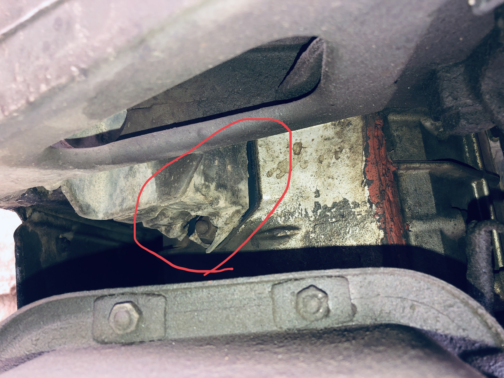

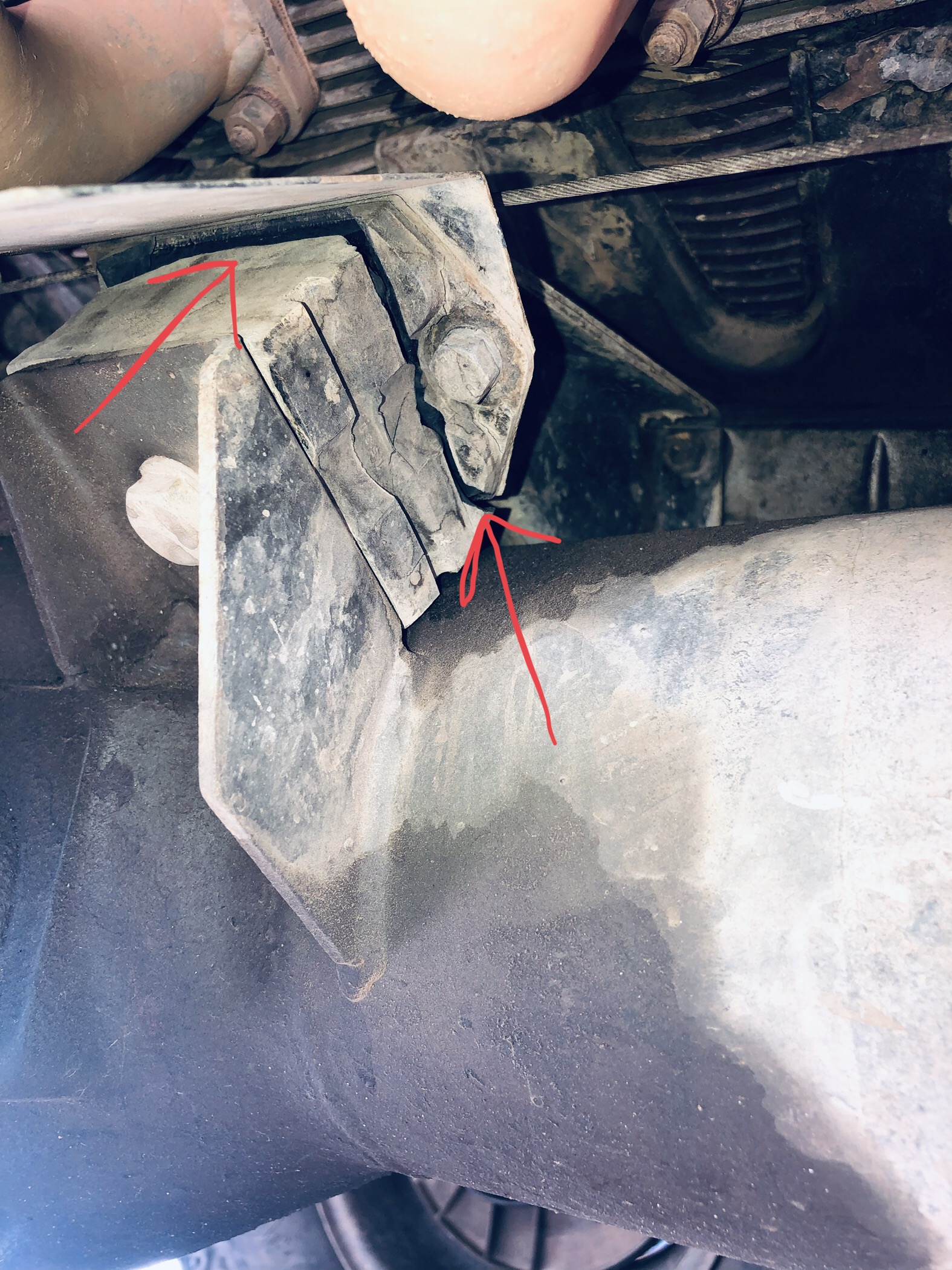

Hi, I got a little too ambitious off-roading during the Rocky Mountain Pinzgauer Treffen this summer and I think I busted my engine mounts. After hitting the under side of my truck pretty violently on a rock I noticed that my idle was increasing on its own. It wasn't until I was back home and attempted to track down the problem that I noticed the engine had perhaps shifted 1/8 to 1/4 of an inch.

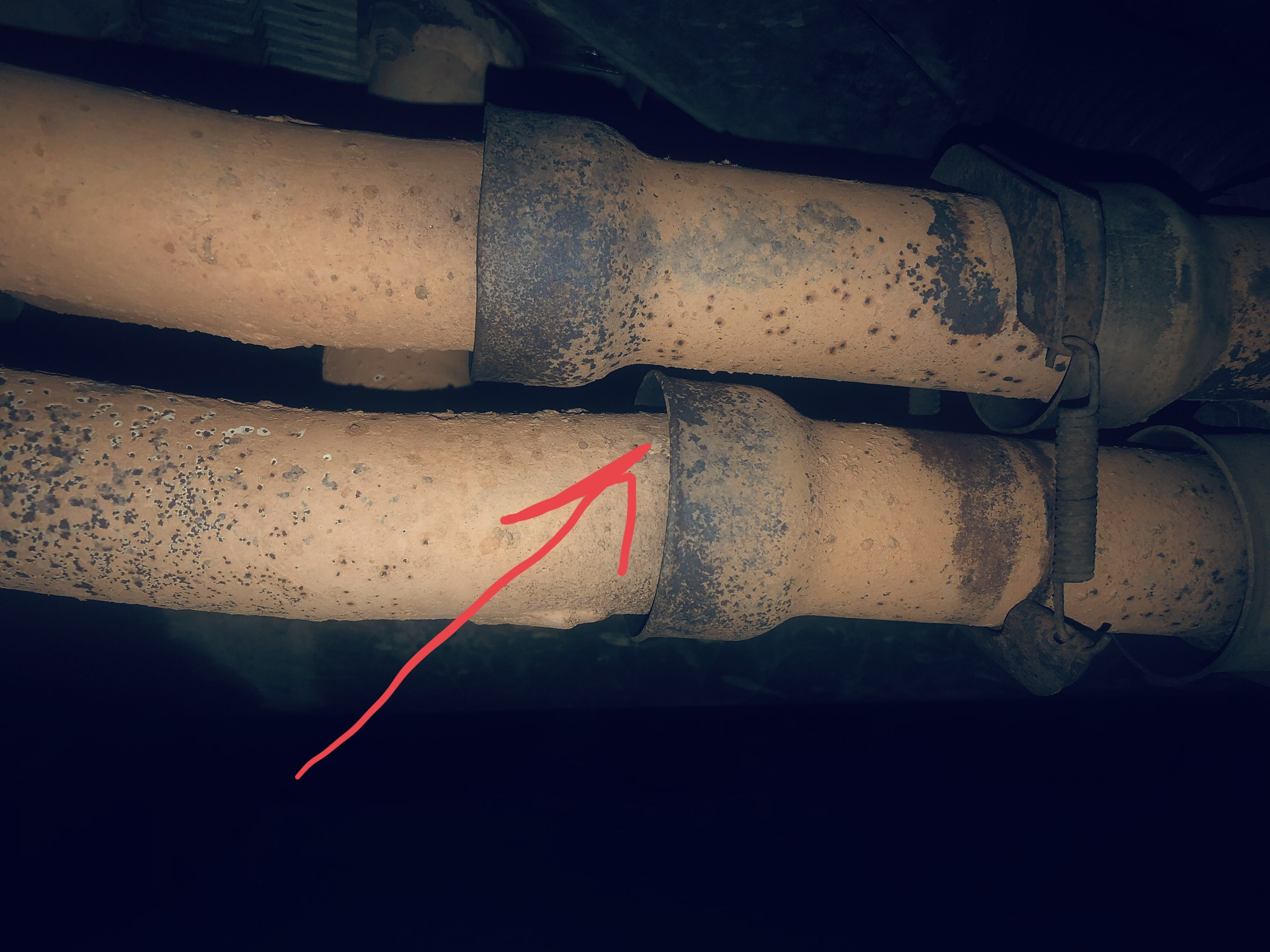

Similarly, when I'd start the truck I'd hear a pretty loud, distinct banging, but only during starting. I'm not attributing the banging to the end of the exhaust manifold making contact with the collar into the heat exchanger.
Side note - Not being much of a mechanic, I assumed that breaking motor mounts would've been more catastrophic than what I'm seeing here. I also assumed that bolts would've passed through mounting points on both the engine and the mounts on the center drive line.
Do I understand correctly that bolts terminate into this rubber block and the bolts from each direction just tie into that? (ie there's not a single bolt all the way through the rubber block?)
In other words, I'm trying to determine whether or not I sheered a bolt in the engine mount. I don't believe i did. I believe I just effectively sheered the rubber block.

Indeed it was. Once I identified the broken mounts I immediately printed this diagram. I’m just trying to wrap my arms completely around the repair and what I’m potentially getting myself into

Once you have the replacement engine mounts in hand, you'll be able to visualize how they need to be slipped into place. They are relatively simple parts. You shouldn't have to lift the engine very much to replace the mounts and the engine is relatively light, as engines go.

This summer I knocked out a full (3) motor mount replacement, and in the field no less! Following Jim Laguardia's tips it was an easy-peasy operation, if not a little time consuming, but DOES NOT require that you hoist the motor. You can get the job done with a bottle jack.
Simply fit a wood block under the oil pan and jack up the motor ~1in to lift the weight of the motor just enough to wiggle out the old mounts. At this point you should be able to swap in the new motor mounts with little difficulty (some of the bolt locations are a bit fiddly, but not bad).
As it was recommended to me, replace all 3 mounts as the failure of 1 can stress the others, setting them up for failure in the near future. Any of the old mounts that aren't broken can be kept as spares for a quick field replacement if needed.

can't tell you how many motor mounts I have broken, transmission mounts also. Fortunately they are very easy to change and don't require any special skills. Nothing is broken other then the mount. simply remove the two smaller bolts and the one larger bolt. support the engine with a floor jack and piece of wood across the oil pan. remove and replace the mounts one at a time. might take a little wiggle of the engine to get the holes to line up. don't tighten bolts down all the way until both mounts are back in place. tighten everything down and you are good to go.
BTW if a hit on a rock is what you think broke the mounts then they were probably in need of replacing before the contact.

Thanks for the advice, folks! The project went relatively well. I’m only able to find two mount points. I replaced both. I see the engine diagram that shows a third at the back of the engine, but I can’t seem to identify it while I’m down there.
My bottle jack with a 2x6 wood block did the job on the oil pan to life the engine for the passenger side mount replacement. I had to move the jack towards the drivers, just beside the oil pan to lift the engine for the drivers side mount replacement. That worked well.
As mentioned, some of the bolts are in precarious positions, but a 3” extension on my ratchet did the job. Also, it was necessary to leave the screws loose until I lowered everything back into place.
Thanks again! ...now onto dropping in the flexible exhaust section between the manifold and heat exchanger

There third mount is actually on the transmission. Not very difficult to change either.
