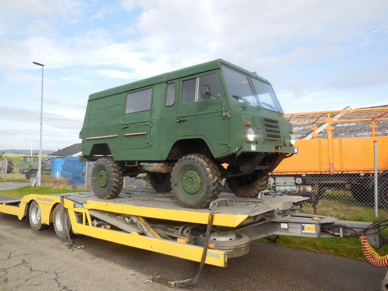

I found this 11 in Denmark its an alu-zink model with very low km’s. Most likely lightly used then restored by the army and stored. It was purchased at auction and stored for sale for the last five or so years.
The green machine is in tip top shape with no rust to speak of and very clean. It’s shape from the seller and a friend that took a look is “as good as it gets”.
My initial questions are when it arrives what rubber part should I source? Cv boots, drive shaft bellows anything else? I found a guy in Malaysia who has silicone boots that I would like to try. I plan to change fluids and grease. Tires need to be changed. Coolant lines and fluids....

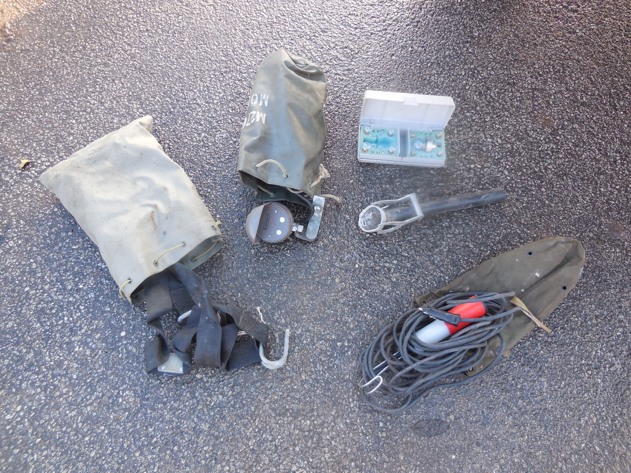

Also in the purchase I negotiated a new set of springs and some historical goodies. The shop light and bulbs are obvious, but can anyone tell me the other parts here?

You have a bag with at least one "black out " light. They mount on those odd slots near the headlights.

Bulbs, the fuel can spout (that rubber tends to decay), trouble light with bag, blackout lights with bag and the straps with bag are actually the straps that secure from floor to ceiling to allow carriage of four stretchers. I would be very interested in looking closely at those straps as Sean's truck has the eight outboard stretcher hooks but never came with the center strap sets. The stretchers can make for some very handy storage space.

Funny thing I thought that filler spout was something far more interesting, but after your suggestion that exactly what it is Jim. Hopefully I can find some free time when your not busy to come visit. Keep me in mind if you need a hand with a project too, happy to lend a hand.
