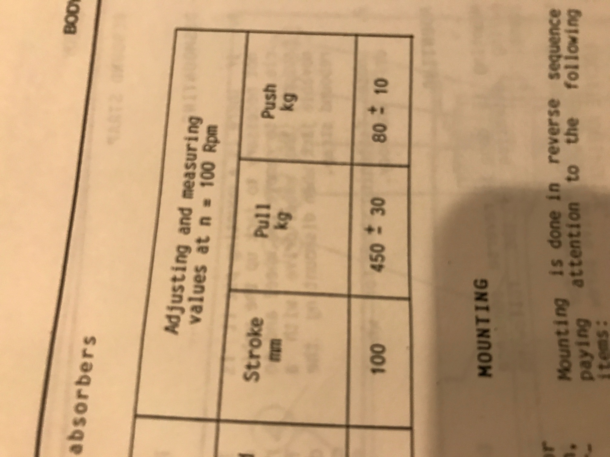

I feel a little more at ease about my shocks- I found this chart in the repair manual. I think it means that the shocks do indeed have much more force required to rebound or extend versus to contract. It makes me wonder about all those replacement shocks breaking bolts.
