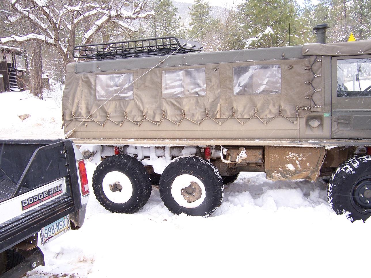

I picture framed the opening when replacing the windows that I glued in. that is to say cut the corners at a 45 degree so the flaps can be held out of the way so the window can be laid into place then the flaps placed back over the window. You will be surprised how dirty the window pockets are. I had to do a lot of cleaning with a stiff nylon brush to get the vinyl clean. Use a lot of caution with the glue and the window as the glue will leave marks on the window plastic (yeah that is from experience) most boat shops carry a variety of window material. I went with a heavier plastic as I tend to play in the brush fairly regularly and wanted the material to hold up.
The photo was from way back in '06 a year or so after making the top. This top is a combination of two 710 tops thus the three windows. the "C" rail rubber is also glued to the top with no mechanical fasteners. I used the "C" rail so I could seperate the sides from the top. Top has had no repairs to the glue joints and still in one piece although I no longer use it on my truck as I have made a complete hard top for it.
