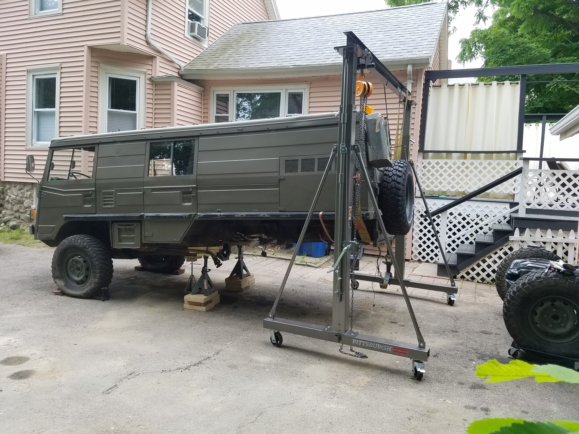

Sorry for the delay I'm just seeing this post now!
I just bought a Gantry crane and chain fall from Harbor Freight and used a winch trap and with the one chain fall supported the whole rear of the Pinzgauer from the Gantry crane above it.
I'm sure you've gotten the work done already but this system worked great for me.
