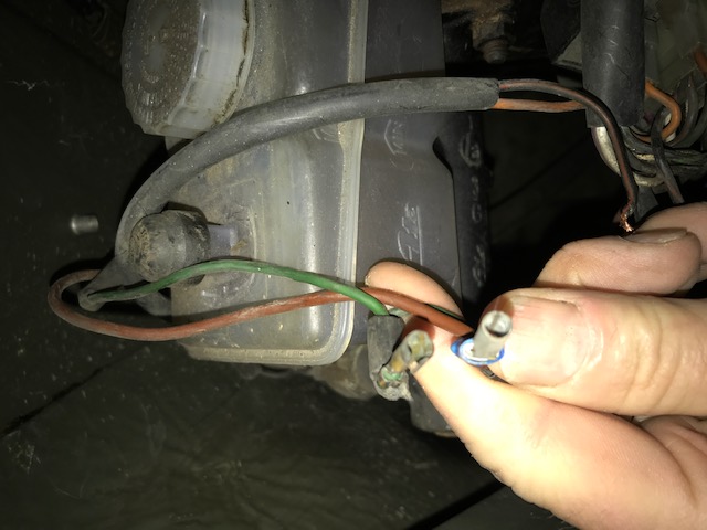

After much fighting with my non working brake lights and turn signals (an interesting circuit BTW), and reading 200 +posts about light troubles (thanks to all posters- what a knowledge base ), I am up and running, during my troubleshooting I came across the following connections coming off the low brake fluid sensor. Anyone have any idea what these might have been used for? I can't see anywhere on the truck they might fit. 1974 Swiss 710M .
Re: Extra wires? add on?
The original brake fluid reservoir had 2 caps, each with a fluid level sensor built in. You have the newer reservoir with 1 cap and 1 sensor. I would just tape off the extra wires.

I also am curious of this wiring right now.
No kidding.
I have the old style dual sensor and all the connector ends are shot on wiring. The connector points on the dual sensors are fine. This all came up for me recently as I just did the brakes. Those old connections I had were probably marginally working but now that I disturbed them in the process of doing brakes they are shot.
I can find the barrel lug connectors. Not something I typically use but I'm sure I can find them.
You have a green wire and a brown wire at this location. What goes to what on the sensor?
The sensor is just a simple on/off float switch so polarity is not an issue. Green or brown can go to either terminal.
