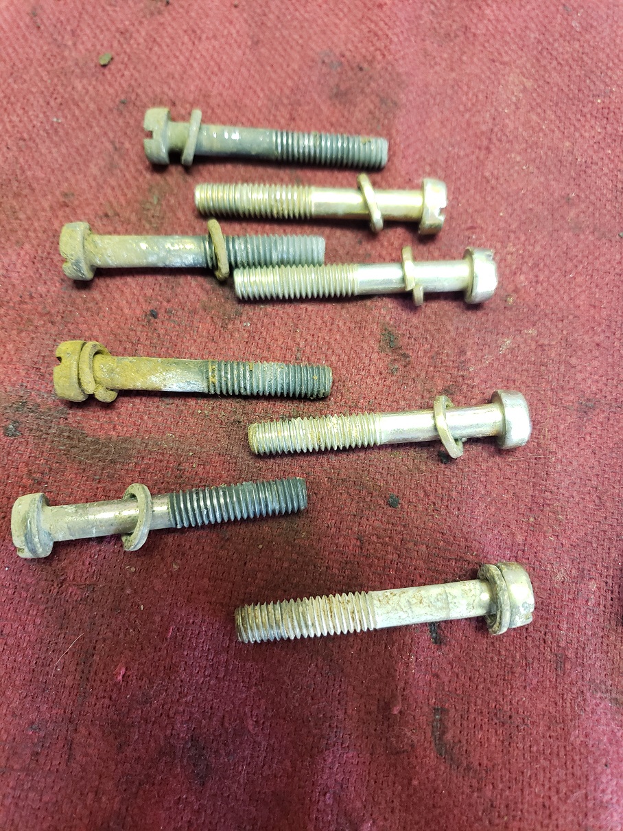

2. Jim L's instructions mentioned two of the base screws are shouldered and they are to be placed essentially on the diagonals. All 8 of my base screws are the same. The front carb screws looks good, but the rears could/should be replaced. EI has the screws but not shouldered, just partially threaded and with a hex socket head. SA has shouldered screws. In both EI and SA website, the parts diagram shows same screws and same part #, but I found on this thread: viewtopic.php?f=12&t=11736&p=87663&hili ... rew#p87663; the only diagram showing two different base screws with two different part #s. Anyone know why that is?

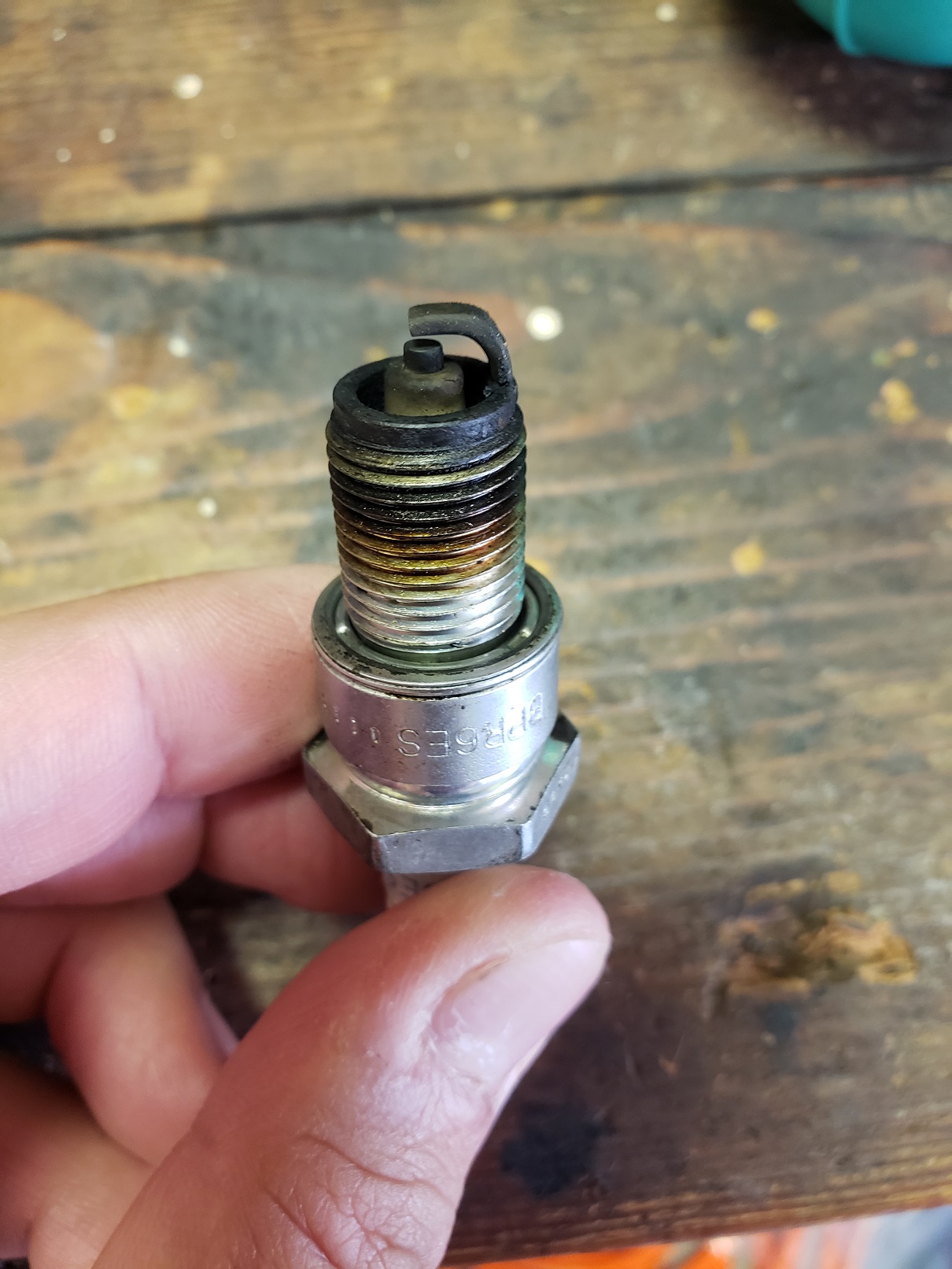

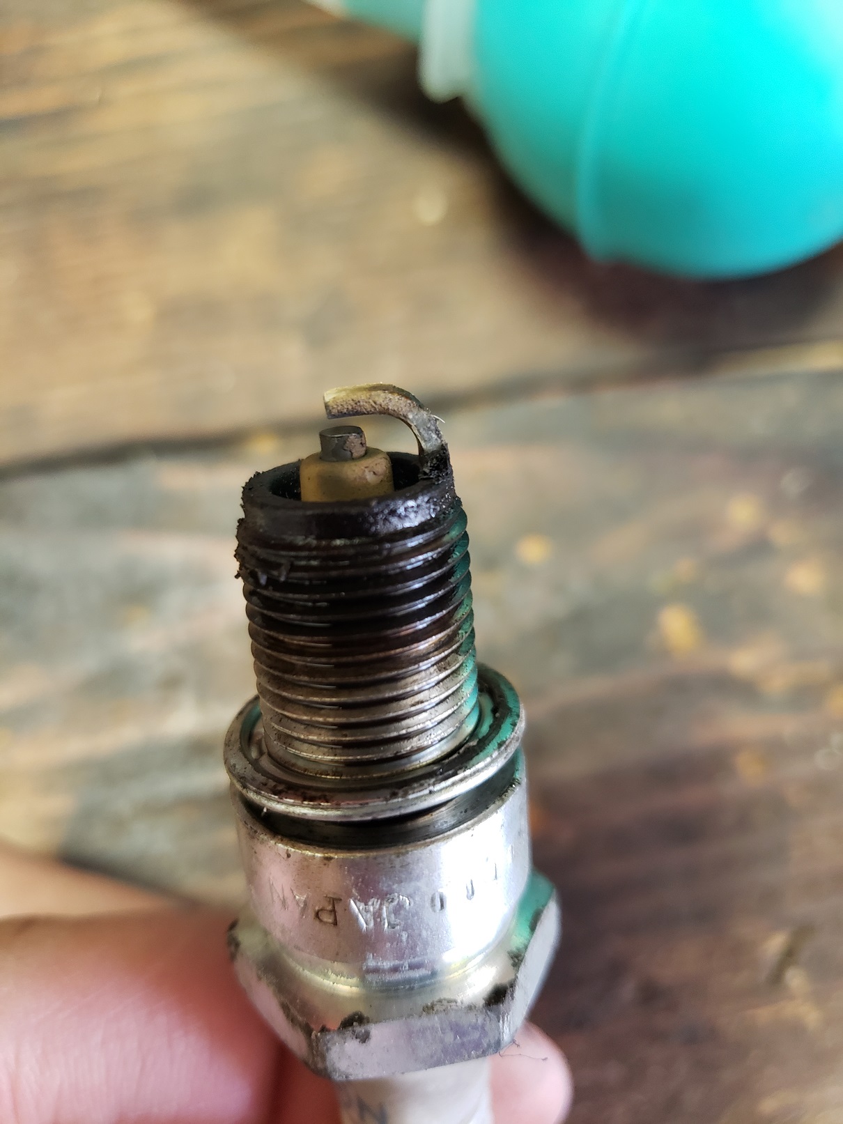

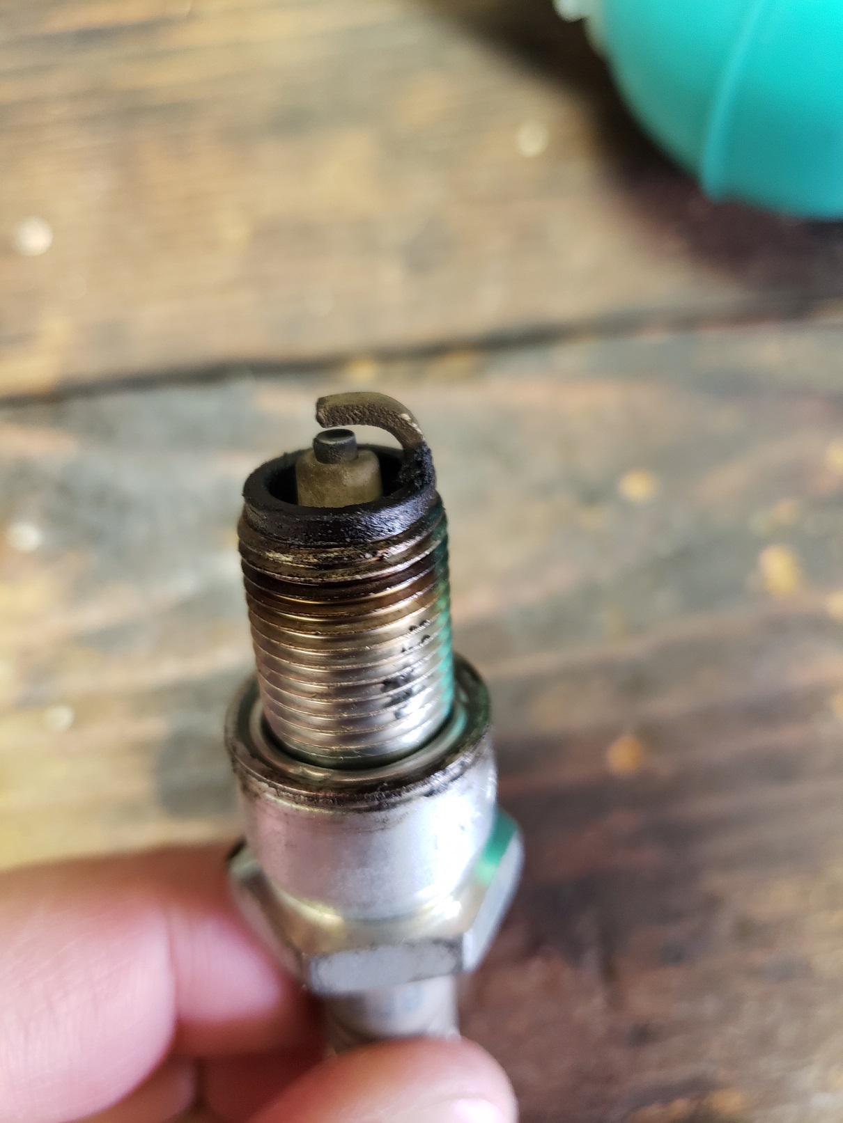

7. Took out the plugs to check them out. #2 seems lean, the others seems ok to me, but maybe a little soot/rich? Hoping more experience eye can let me know what they think. Doesn;t make sense to me though as I would anticipate #3 and 4 to be the lean one given those were the ones with loose carbs.

Your float level is way too low. If you cannot remove any shims underneath the float valve, simply bend the center piece of the float to adjust the height.
The NDIX floats consist of two buoyancing elements, which have to move independently. Purpose is to keep the fuel level correct as the lower of these two elements determines the fuel level.If the spares you got dont move independently, there is something wrong.
In the German forum I have shown nuts for the base screws that look better to me. They have the M8 thread , but metric keysize 10, so you can propery tighten them.
https://pinzforum.kiruna.de/viewtopic.p ... 64#p105788
If you want to clean the throttle body in an ultrasonic cleaner, disassemble the whole shebang. The seals for the shaft are radial seals and have to be installed with the flat side facing outwards.
The shut off solenoids are off by default. The cylinder with the defective one does not get any fuel....
I use to place fine sand paper on a marble plate and get a flat surface for the matin pieces. Single asket is sufficient. Obviously you have to remove all protruding components.
Hope that helps you plan the next steps

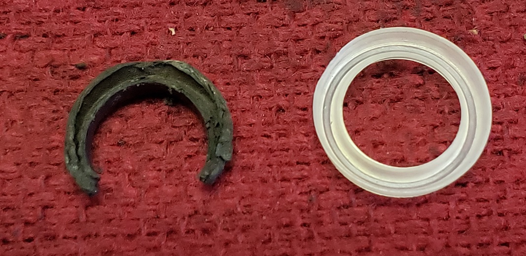

I opened the shaft ends and found only remnants of them on one throttle body, none on the other. From what I can see, it seems they were installed with flat side facing the throttle plate. I want to confirm that it is suppose to be facing away from the throttle plate? These seals are the most expensive seals-to-size ratio I've ever seen.

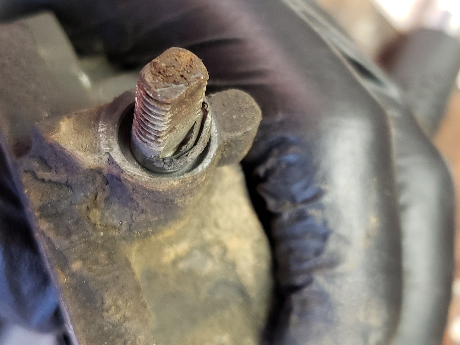

The base screws I was speaking of are the screws that attaches the throttle body to the float body. I think the metric nut you speak of I believe is for the screws from the manifold to the throttle body. As far as I can tell, those are working fine. The picture from SAV shows the shouldered screw which I think I'll just get a set of four and use two on each carb as Jim L recommends.

you correctly identified the location of the metric nuts I mentioned.
I used philips head screws M6 x 40 to connect throttle assy to main body, and secured them with loctite medium. This allows for the use of a torque wrench.
For the shaft seals I strongly recomment you remove the shaft and clean yout the mess in there. The seals have to me installed like any circular seal, flat side out so the pressurefrom the inside helps tp press the rubber against the shaft. Same orientation is used at e.g. crankshaft, portal axle, ...
