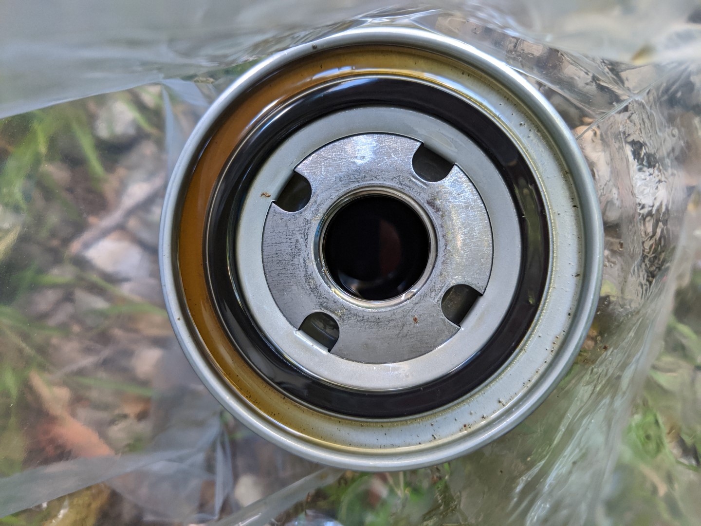

For reference, here's what the 940/29 filter looks like:
IMG_20200606_184506 (Large).jpg (332.75 KiB) Viewed 7378 times

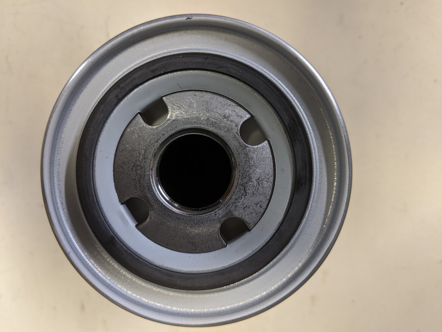

And here's what the 940/5 looks like:
IMG_20200608_142011 (Large).jpg (246.42 KiB) Viewed 7378 times
