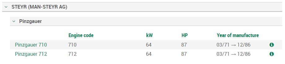

And Mann filter confirms that the W940/5 is correct, and W940/29 is not for Pinzgauer per their application data here:
https://catalog.mann-filter.com/NA/eng/ ... /W%20940~5
https://catalog.mann-filter.com/NA/eng/ ... W%20940~29
Seems like the Goatwerks site needs updating: https://www.goatwerks.com/interchangelist.htm since it calls out the W940/29 version and that's what I went from originally. FWIW, SAV sells the /5.

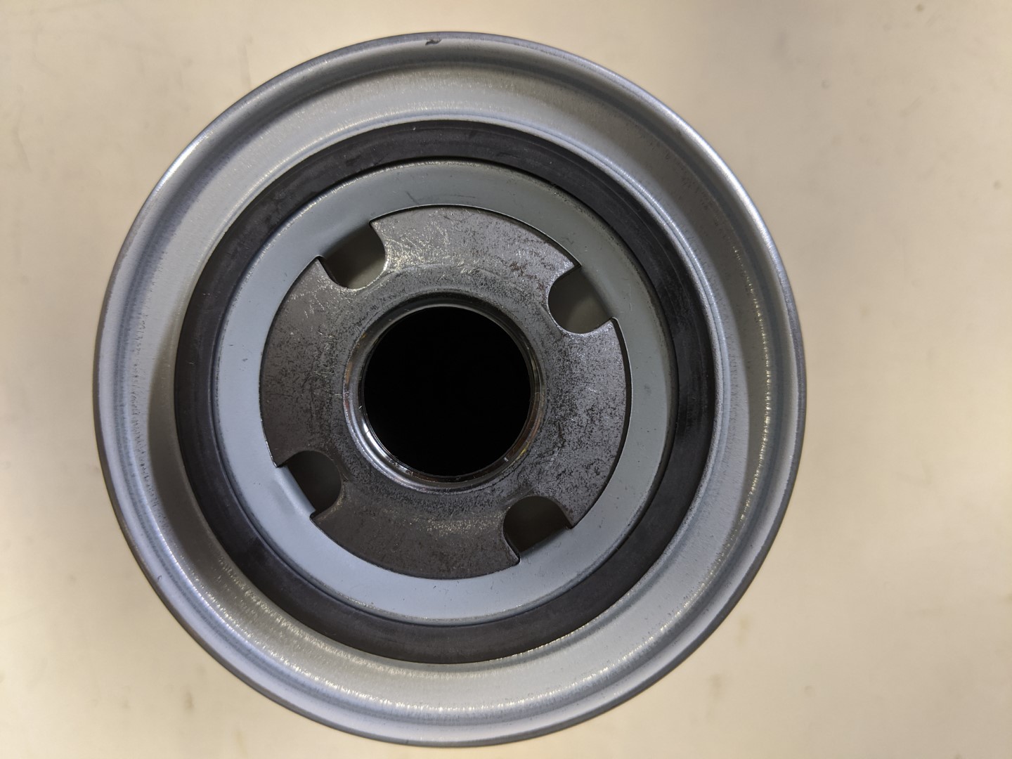

For reference, here's what the 940/29 filter looks like:
IMG_20200606_184506 (Large).jpg (332.75 KiB) Viewed 7398 times

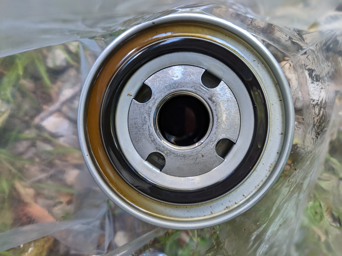

And here's what the 940/5 looks like:
IMG_20200608_142011 (Large).jpg (246.42 KiB) Viewed 7398 times
