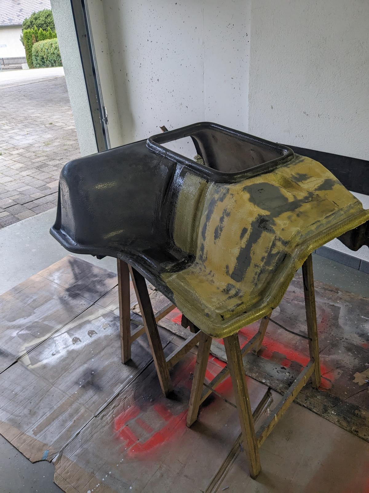

I've reinforced it with kevlar/armid and epoxy resin (my engine fan exploded and damaged the dog house)
"welded" the cracks: Repaired the holes with carbon/kevlar: 8-10 Layers of aramid/kevlar in the fan area:
Re: Dog House Cracked
Another layer of carbon/kevlar for the whole dog house
Painted with Mipa Protector
Done
Nice side effect: It also reduces engine noise

I’m considering the Kevlar layers, but I have some questions.
What did you do to prep the surface?
How did you cut the material?
Are there any recommendations after having done it?
Also, sorry about the stupid question about noise reduction. I hadn’t seen the last caption.

I only sanded the surface, no special treatment with primer.
I've used a Kevlar scissor to cut the raw fabric and a small angle grinder (Proxxon LHW 28547) to cut the excess on the dog house.
