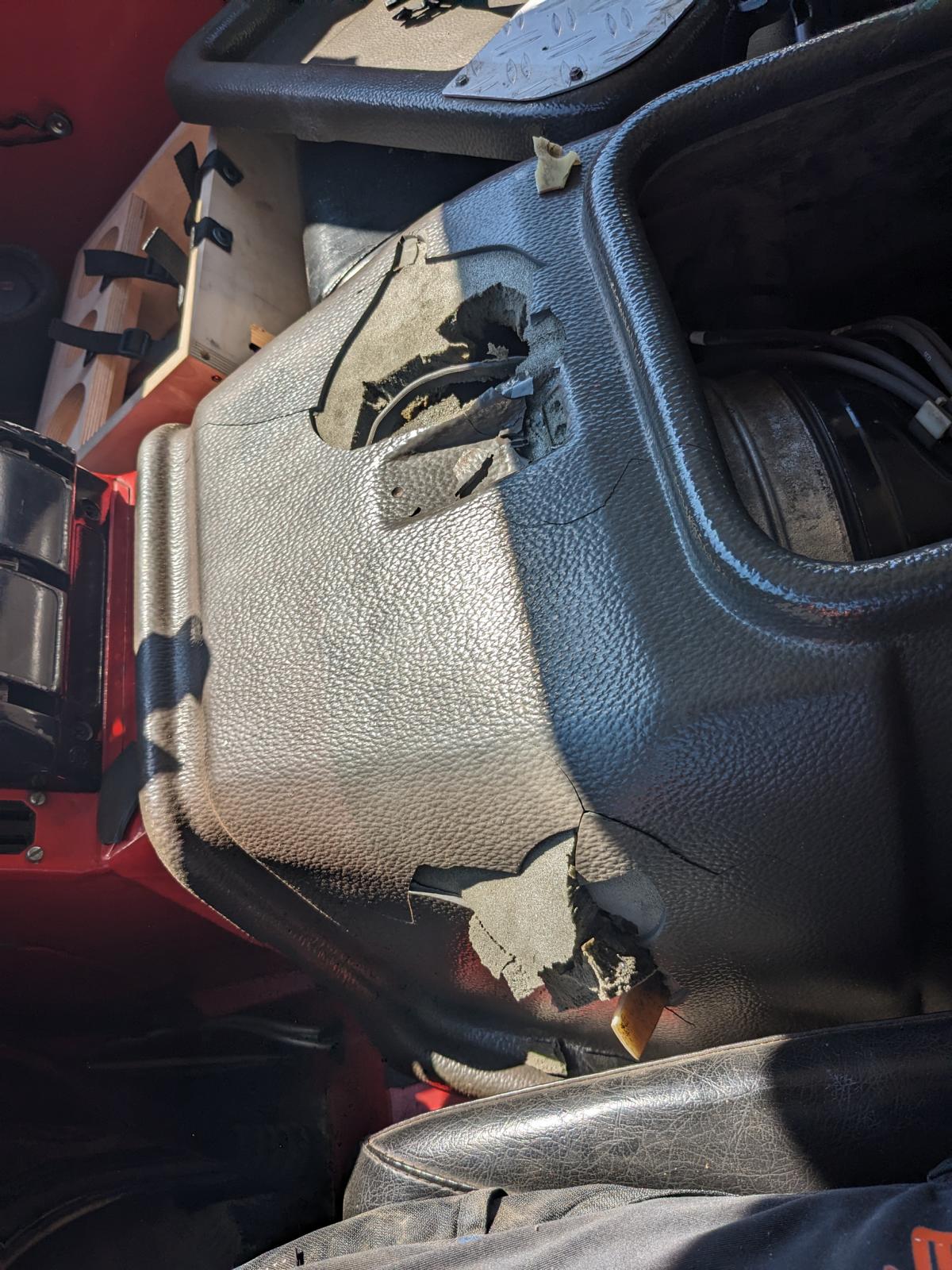

My cover has a couple of cracks right behind the locker levers. I imagine this area is most prone to this because it’s where you hold it when you pick it up. My question is has anyone tried to reinforce this area? Every time it flexes there, it pulls the cracks apart. I was wondering if a piece of sheet metal could be glued or riveted. Of course it would have to be contoured to cover the widest area from one side to the other. An upside down skateboard half-pipe if you will. Thoughts?

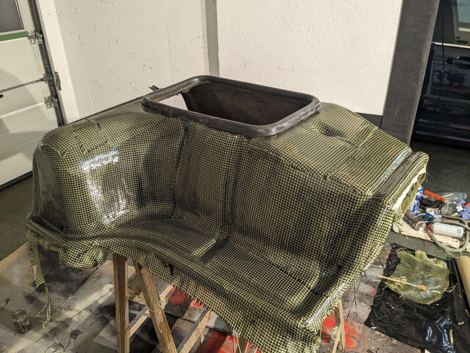

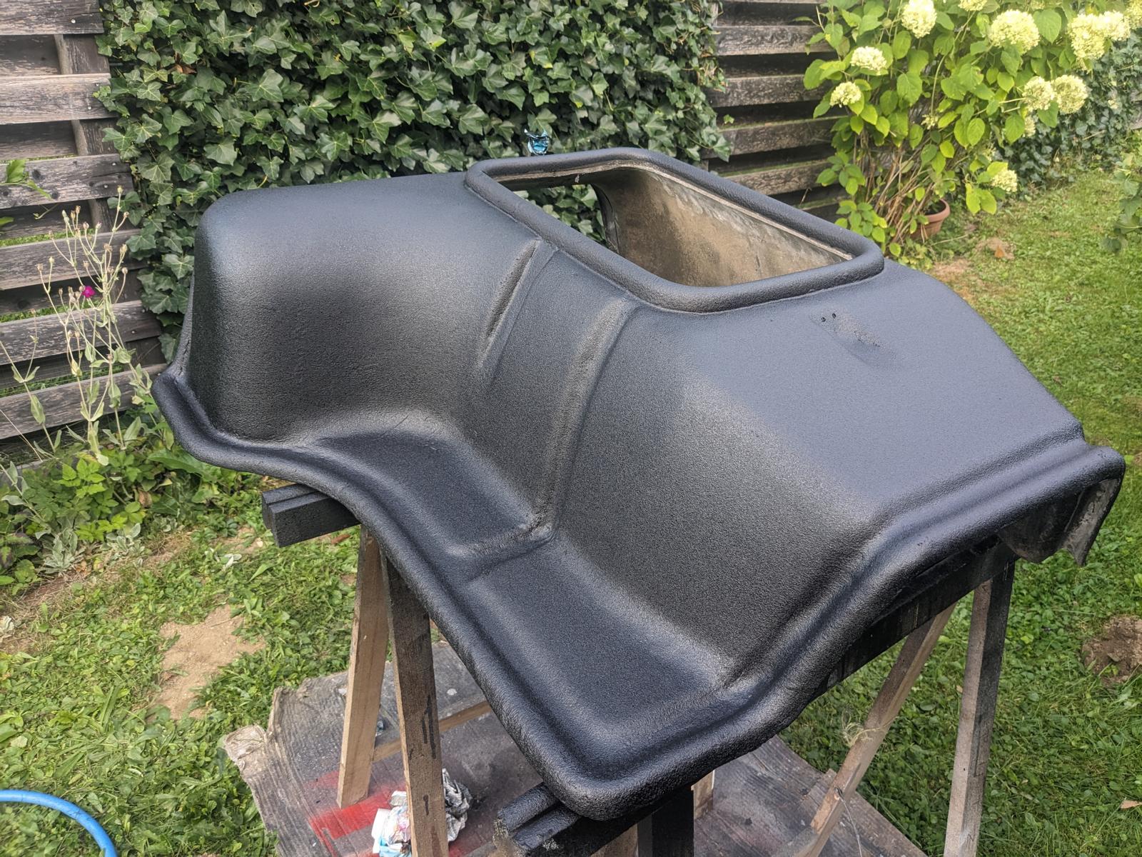

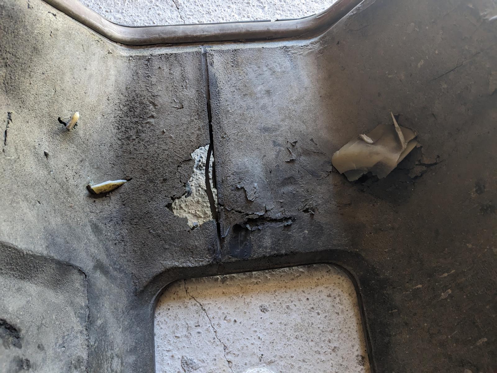

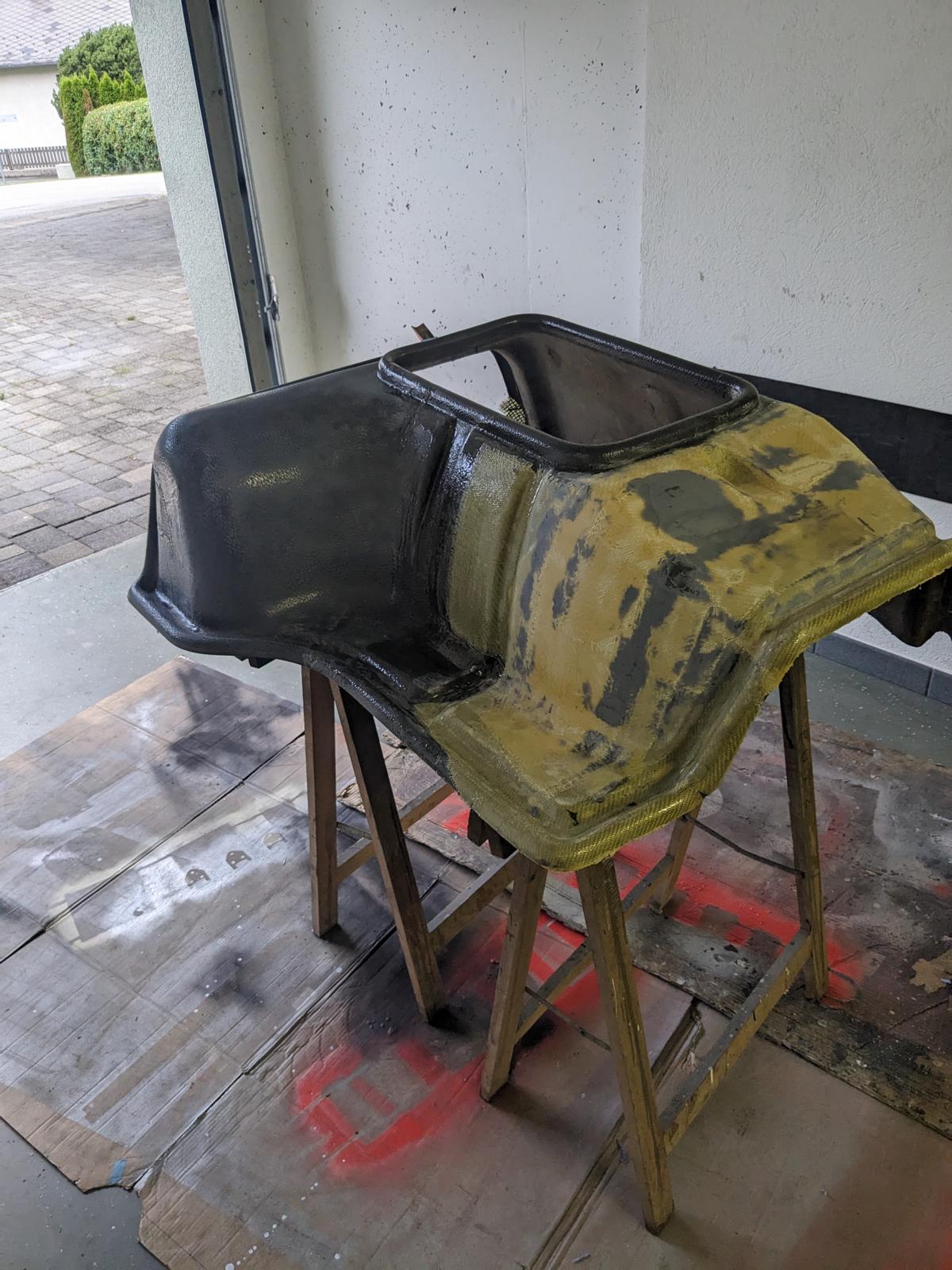

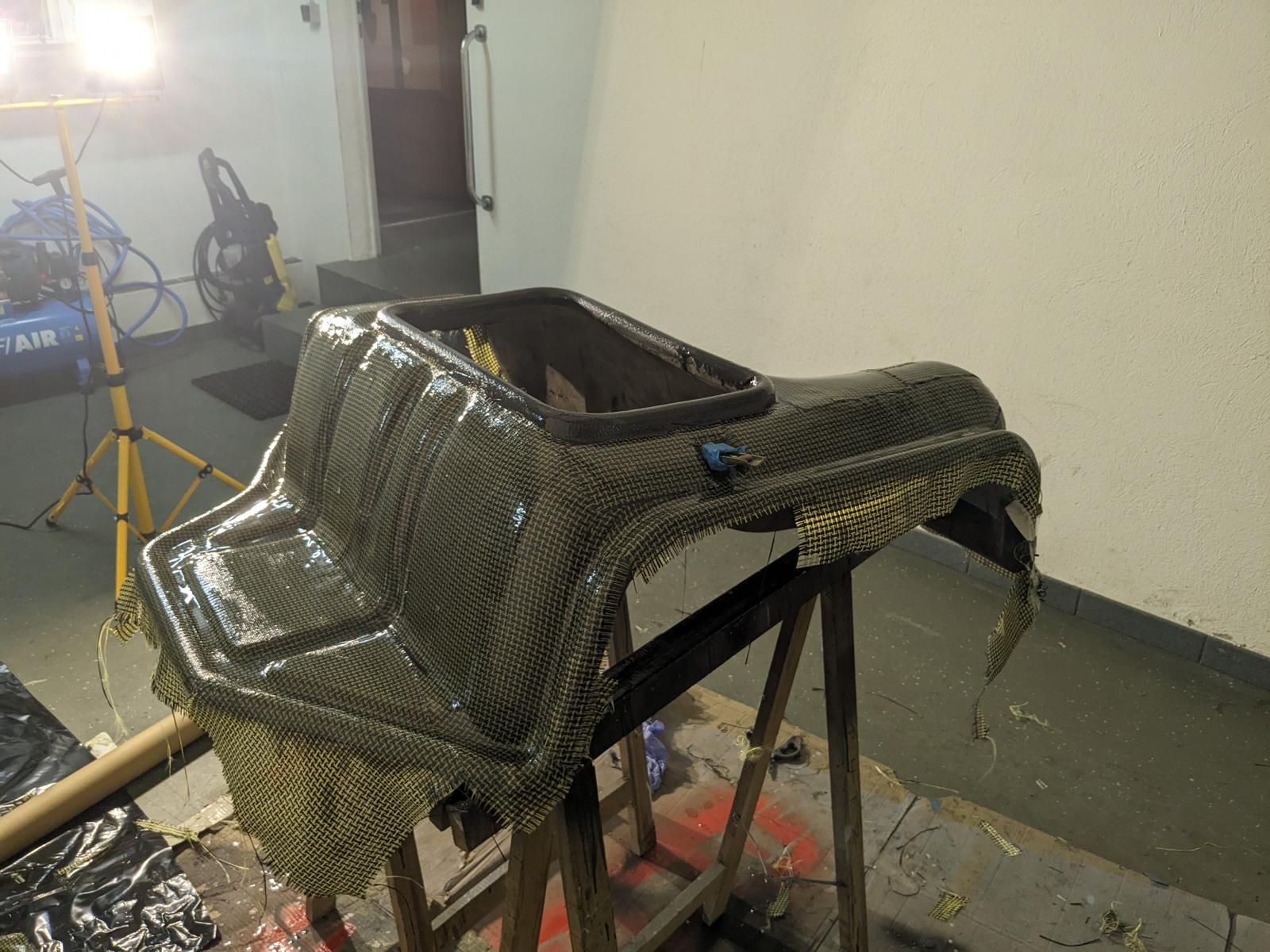

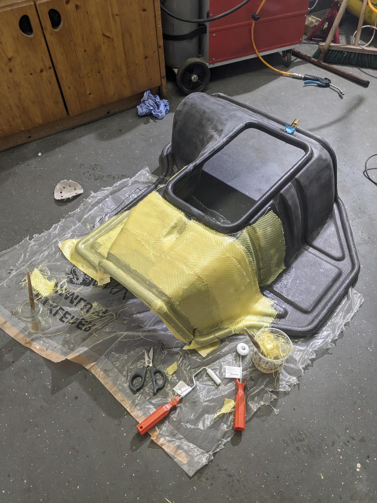

I've reinforced it with kevlar/armid and epoxy resin (my engine fan exploded and damaged the dog house)
"welded" the cracks:
Repaired the holes with carbon/kevlar:
8-10 Layers of aramid/kevlar in the fan area:
Re: Dog House Cracked
Posted: Sun Dec 08, 2024 5:32 am
by Puty
Another layer of carbon/kevlar for the whole dog house
Painted with Mipa Protector
Done
Nice side effect: It also reduces engine noise

I’m considering the Kevlar layers, but I have some questions.
What did you do to prep the surface?
How did you cut the material?
Are there any recommendations after having done it?
Also, sorry about the stupid question about noise reduction. I hadn’t seen the last caption.
Posted: Wed Dec 25, 2024 4:11 am
by Puty
I only sanded the surface, no special treatment with primer.
I've used a Kevlar scissor to cut the raw fabric and a small angle grinder (Proxxon LHW 28547) to cut the excess on the dog house.

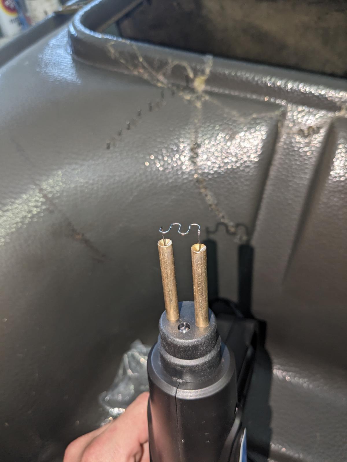

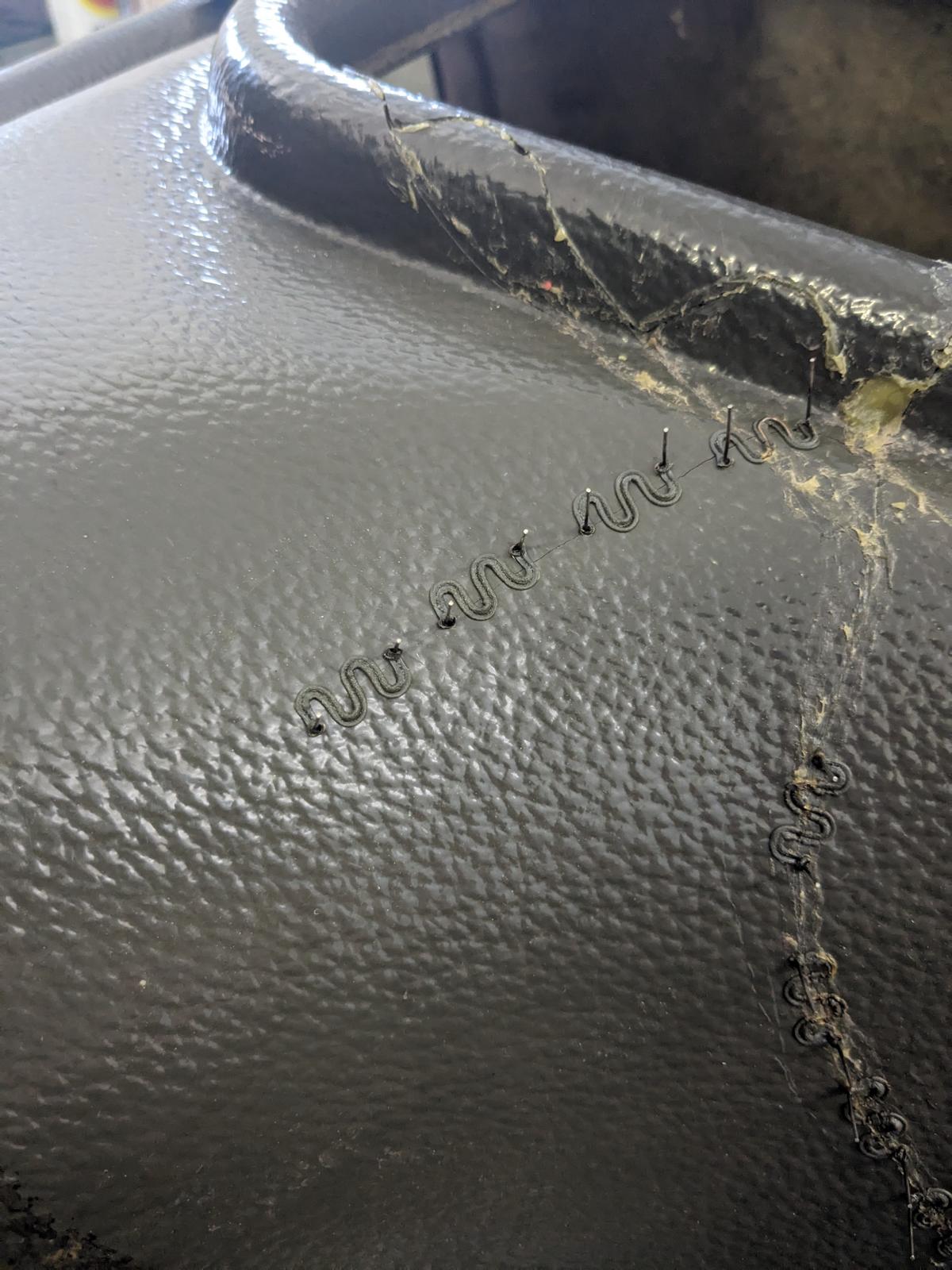

So my plan is to lay fiberglass this summer. In the meantime, I tried a plastic welding kit. The iron wasn’t hot enough to melt the engine cover. It took a lot of time and effort to get the wire mesh to lay flat. The end result wasn’t pretty, but since I was going to cover it with fiberglass, it didn’t matter. The kick in the nuts came when, while sitting in the sun, the whole thing let go along the edges. I was able to peel it right off with little effort.
So for those of you considering this to fix cracks in your engine cover… No.
I’m going to try J-B weld plastic binder next. I’ll report on that soon.

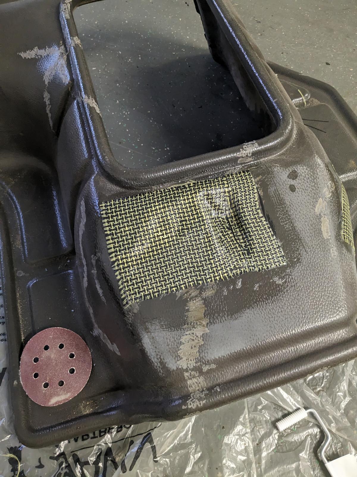

I applied the J-B Weld plastic bonder yesterday. It cures pretty hard. Where the worst crack runs to the edge, I put some fine wire mesh. We’ll see how well it holds up. I’m still plan on laying fiberglass cloth over the summer. Then, some kind of spray on bedliner.

I’ve pulled the cover off a few times and the JB-weld stuff seems to be doing fine. It’s sat in the sun and got pretty hot. No problems.
I think the mesh adds to the strength and, considering, that the cracks run through the edge it was necessary to, but it creates a couple of raised areas. I’ll have to work around them with the fiberglass to keep things level.
Oh well. That’s a problem for this summer
