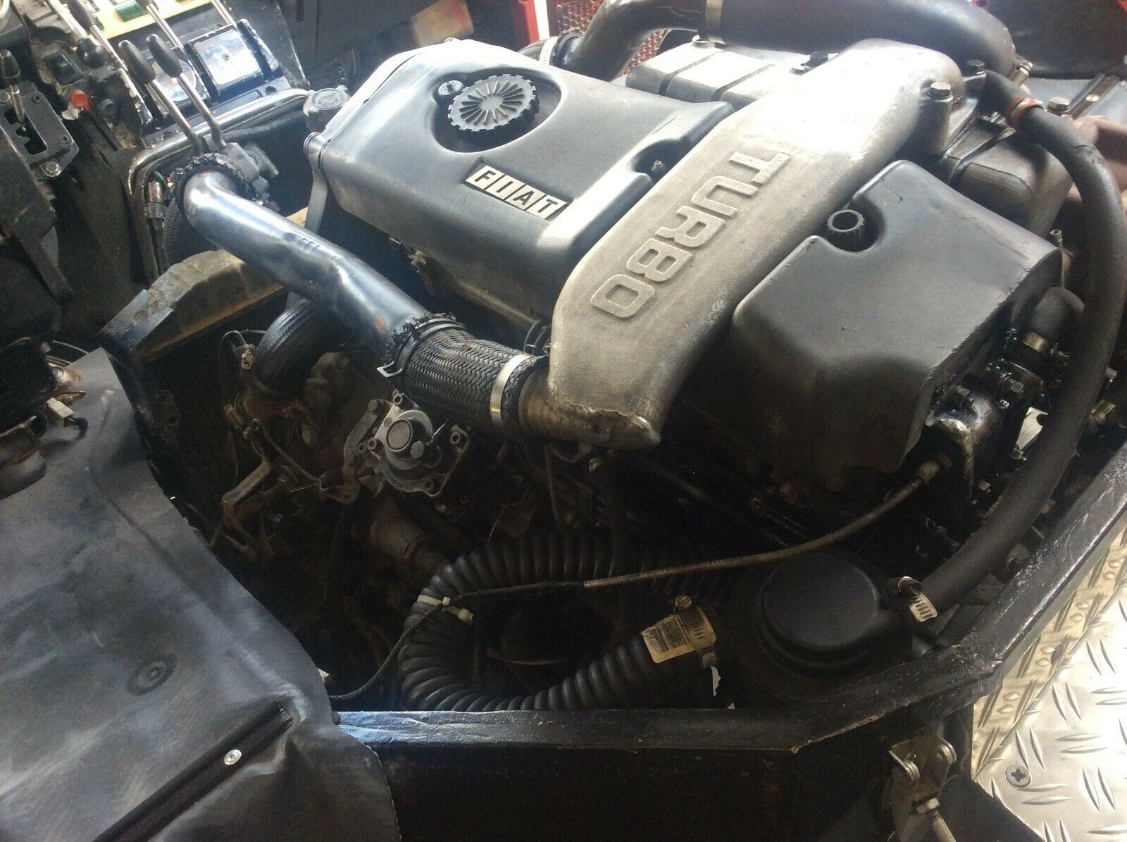

I will start working on 'Mad Iris', the Pinzgauer with an early Fiat Croma engine.
Brief:
The truck was imported from Montenegro to the USA. No records and no maintenance done in the recent past. Pinzgauers did not come with Fiat engines. I am guessing a passionate person did this combo. Some folks on here advised not to buy this, sorry folks, I went with it.
The reasons I bought - a joy to look at the engineering that went into Pinzgauer. I also believe old soul sometimes need a renewed spirit.
Challenge:
Fiat Croma 154 was never sold in the States, so no support whatsoever. Pinzgauers have good enough support, especially with a forum like this. But, with the weird combo, there are many unknowns.
Current State:
Vehicle: 1983 Pinzgauer - highly modified
Engine: Good folks on this forum helped to do initial identification. Guess is Early Croma 2500cc turbo diesel engine (Type 8144.91 | Version 154 AF 55 A)
Transmission: Standard Pinzgauer (again a guess)
Immediate List:
  1. Replace the starter bolts (one started bolt broken)
  2. Find the right fuel filter and replace it
  3. Find the right oil filter and replace it
  4. Find the right oil weight for a oil change
  5. Replace axle boots on all four wheels
  6. Check all the leaks and make it 'ChickenPinz' dry (ChickenPinz)
  7. Check and bleed - clutch, 3 sets of lockers and all your brakes (Texas710)
  8. Check and adjust brake setup (Texas710)
  9. Check fluids - hubs, differentials and t-case (Texas710)
  10. Review all hydraulic systems (Texas710)
Second List:
  1. Check the rubber parts behind the locker panels (Texas710)
  2. Check every single hose and replace any that are questionable (ChickenPinz)
  3. Check every single plastic and replace any that are questionable (ChickenPinz)
Other List:
  1. Check what spares that fail typically and try to source them (VinceAtReal4x4s)
  2. Replace wheels (VinceAtReal4x4s)
Current Pictures:
s-l1600 (15).jpg (263.65 KiB) Viewed 13651 times
s-l1600 (16).jpg (280 KiB) Viewed 13651 times
[/size]

Would appreciate if you could review my immediate list above and would like to add to it.

ChickenPinz wrote: Wed Dec 09, 2020 11:22 pm How's the engine? Does it run? Compression good? If so, how's the vehicle drive?
Me? My passion is oil leaks. Find and remedy *all* of them you can. A dry drivetrain is a happy drivetrain that you can spot problems on.
Check every single hose and replace any that are questionable. I maintain several older vehicles, and the rubber & plastic parts are what seem to fail often due to age.
@ChickenPinz, no, I did not hear the engine run yet. While transporting the starter bolt broke and I ordered it. I heard it and got a ride while purchase though.
The pictures are not current. The current state of engine is like a sieve with oil in it (exaggeration), but neverthess it definitely has leaks.
