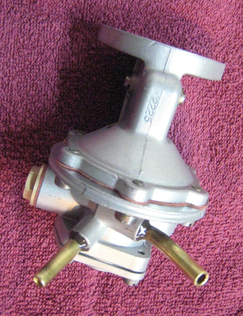

the inlet tube on my 710 fuel pump is loose and wobbly in the hole and leaking gas from there. is that something i can fix, or do i need to order a new top piece? i haven't removed it to see if it's just a pressure fit or how it's inserted, just trying to get ahead of this repair.
Re: fuel pump issue
Posted: Sun Jan 17, 2021 7:54 pm
by pcolette
The inlet and outlet tubes are press fit and over time have been known to come loose. I learned from Thilo Kass to use JB Weld Kwik to secure them in place after a thorough cleaning and mild wire brushing. Use a toothpick or similar item to pick up a dollop of JB and spread it around the seam.
Alternately you could replace the top half of the pump which would give you 2 new internal one-way valves also. https://swissarmyvehicles.com/pinzgauer ... -fuel-pump
Re: fuel pump issue
Posted: Sun Jan 17, 2021 8:23 pm
by ChickenPinz
If your truck takes a long time (>15s) to start after sitting for a couple weeks, then I'd replace the top section of the pump so as to get new valves.
If your truck starts okay (<6s) after sitting a couple weeks, I'd follow that excellent JB Weld advice.

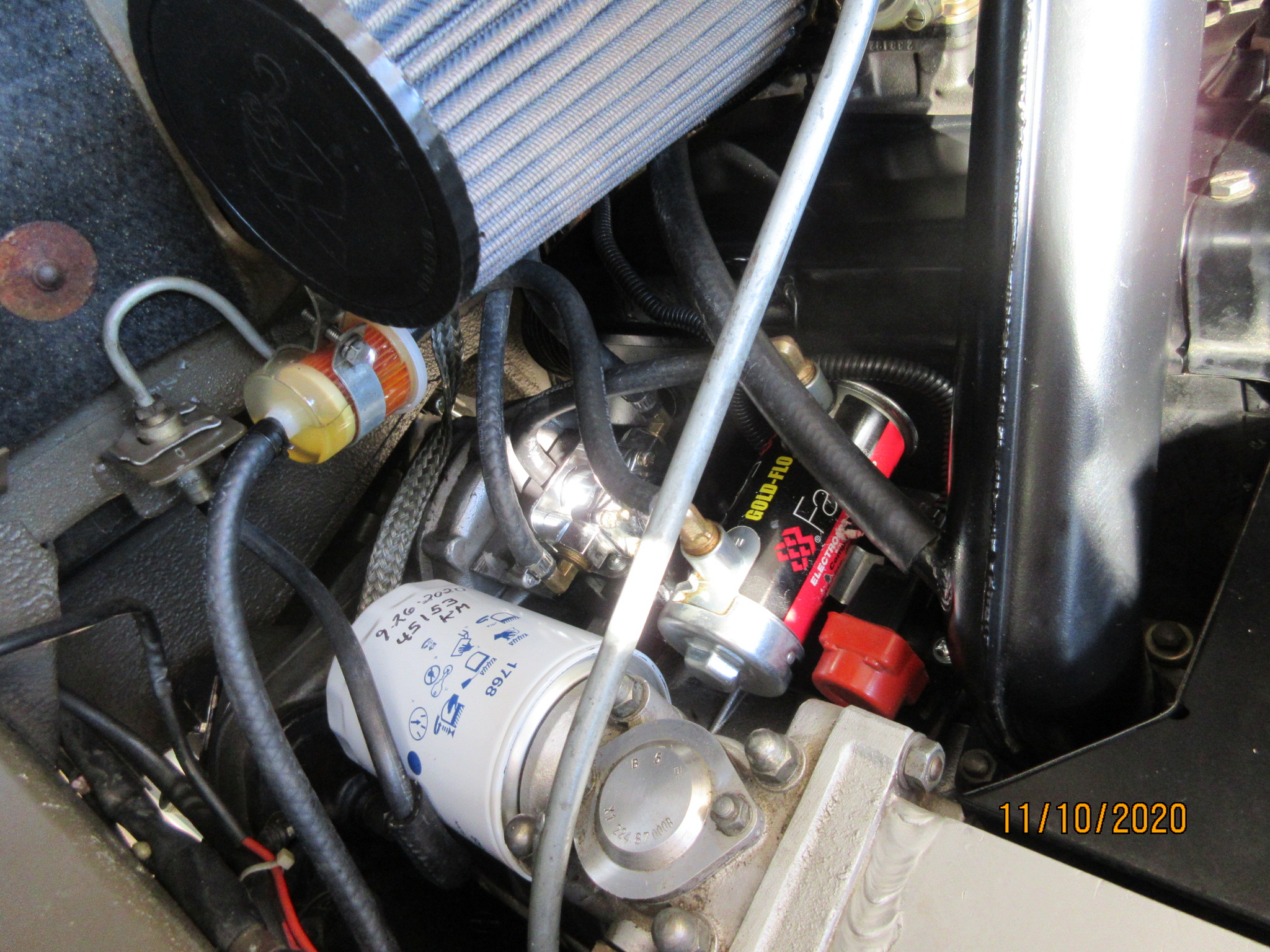

Re: fuel pump issue
Posted: Wed Jan 20, 2021 11:15 am
by pinzinator
I mounted the PinzFDS right on top of the engine. I have had this for 7 years without any temperature related problems. The pressure is set at 3.25 PSI.
